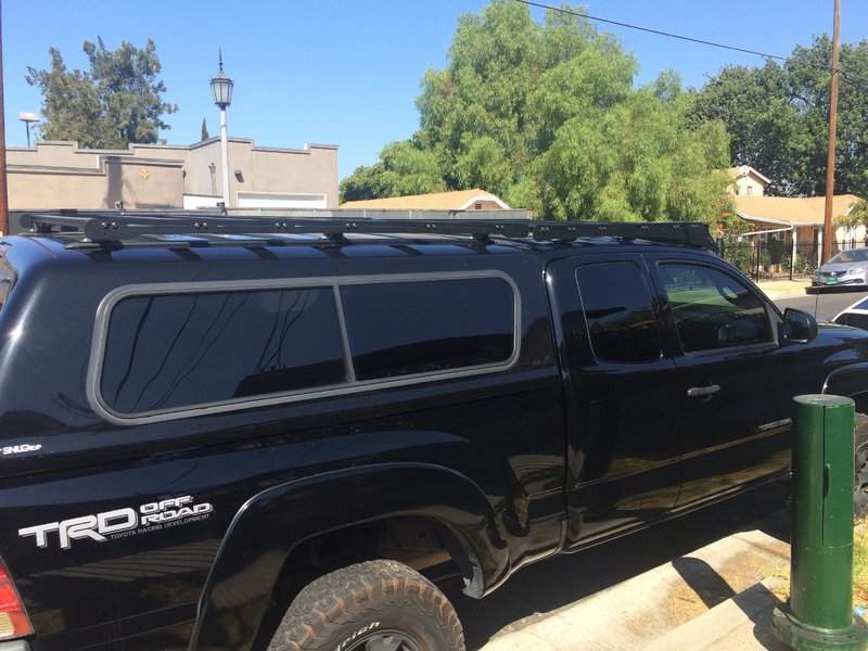

    Looks awesome man! Thanks for the pics/instructions! Can you do a profile shot of the truck? I may end up tossing my modified factory rack.

    Thanks! There's a bunch of profile pictures online, but what's one more? :D
    These are definitely the best looking racks on the market IMO and are designed in a way that compliment the lines of our trucks.

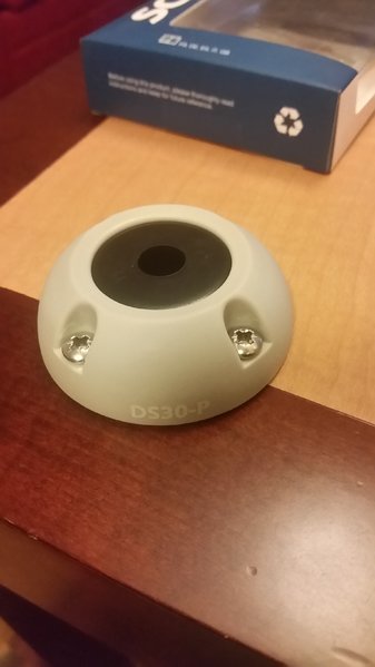

    Will be doing an access cab install in a few weeks. Still need to pick up some dynamat or similar and electrical accessories before I give it a go though. Had a business trip outside Annapolis, MD and picked up a Scanstrut Deck Seal at a marine supply store for the light bar wire routing.

    I'd like to see this install when you're done. A few people have drilled through the roof for lightbar wiring, but most just glob on the silicone. I'm always interested in more elegant approaches.
