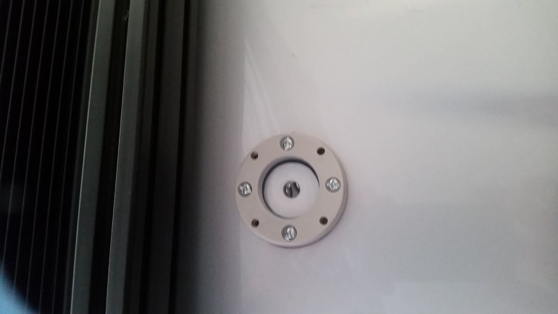

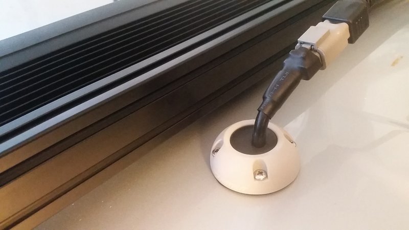

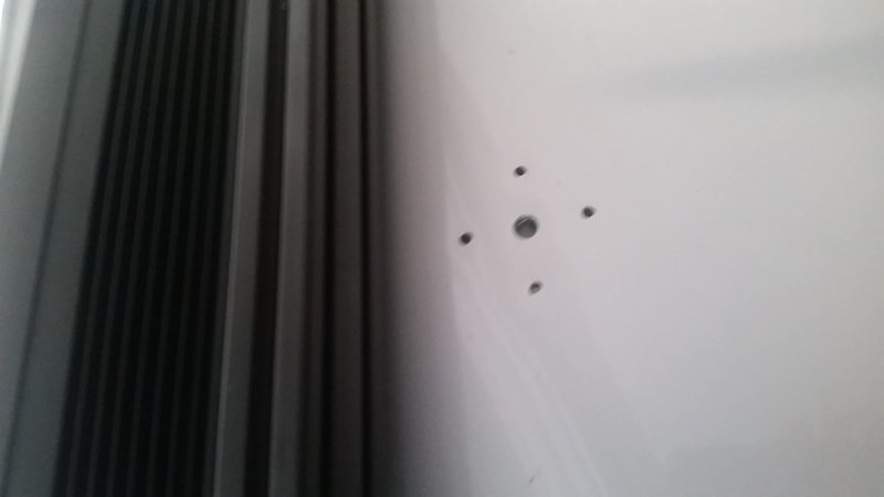

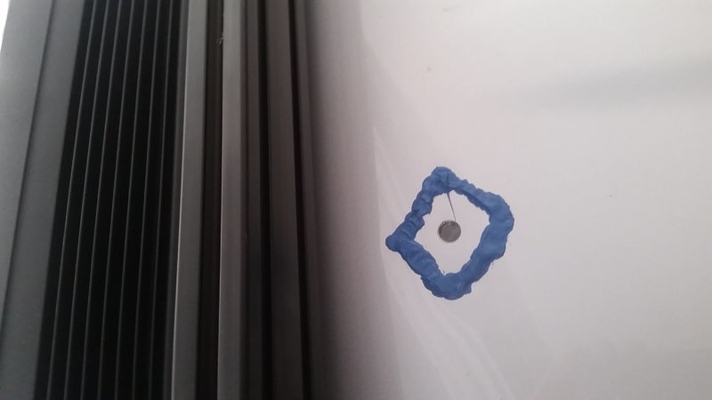

    I came up just a tad bit short on insulation material for the roof so I picked up an additional 24 sq ft to finish, which will be enough to do both front doors next spring if not more. The deck seal placement is right above the driver, just to the left of the overhead console. This allowed for easy routing of the light bar wires along the existing factory wiring down the Left A pilar through the fire wall to the Pelfreybuilt fuse block pannel that will go in next spring. It's getting too cold and I spend winters in Florida while the truck stays here.
    The deck seal is designed for boats and so it comes with screws that can be screwed into plastic, wood, carbon fiber, or similar material used in boat construction. Because the roof of our trucks is so thin the threads would easily strip the holes out if you used them. I bought a few 3/4 inch long bolts and nuts to replace the screws. The seal comes with an adhesive foam weather strip that goes between the seal and the application. I applied an additional layer of silicone just in case.
    I drilled the hole in the rubber puck for the wiring off center to leave room for additional wiring down the road, though I don't have plans for anything. In the picture above the harness is just flaping in the breeze, it will be properly secured. There is no way this thing is leaking. The rubber around the wire is supper tight and the unit is torqued down well with that silicone layer.

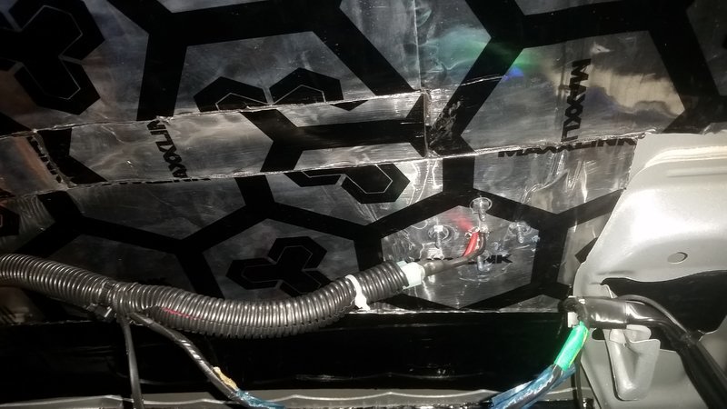

    Here's a shot of the inside.
    there are quick dissconnects above the cab and immediately below the cab. All the wiring fit in nicely and becuse it follows existing lines I hope to not have any road noise from it bouncing around. I have everything put back together on the inerior and only need to re wire my electrical now. I have aux rear backup lights, bed lights, 3 front HID Floods, and the light bar now that need to get reworked through the blue seas fuse block.
    Overal the PrInSu rack install was fun. It helps that I got over drilling through the truck many years ago when I put the snorkel on, otherwise I can see how it could be intimidating/scarey. This project added 17 holes bringin the total to 27 holes I've put in her over 11 years of ownership. Thanks @zscott

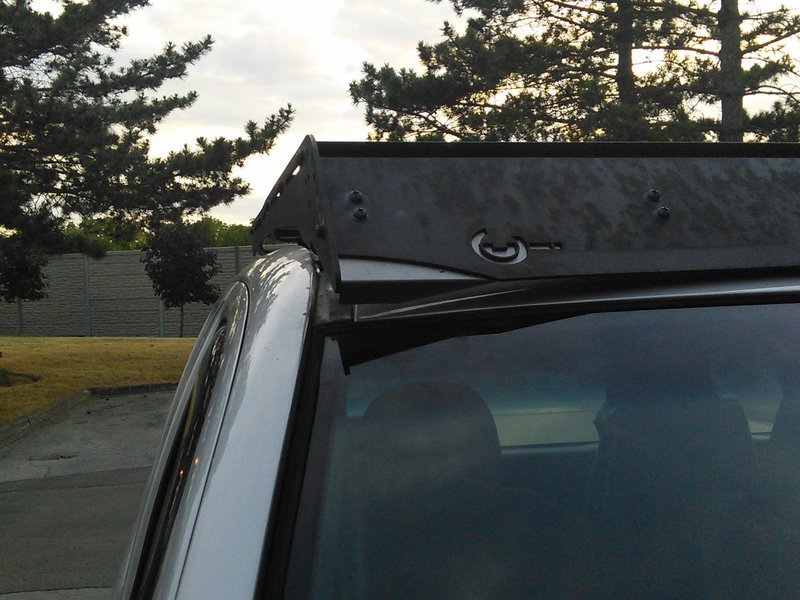

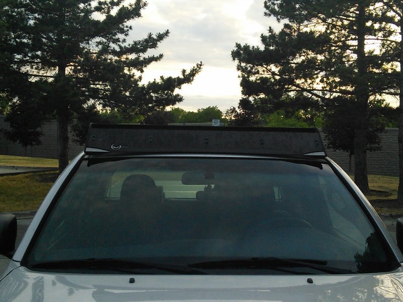

    There was a 3 week wait on shipping - I had ordered it the last week of September 2015, and it shipped middle of October.
    I've had my access cab rack on my 2010 since February 2016 - love the rack, even though i haven't actually put it to use for anything yet.. it's certainly distinctive.
    It took a while to work up nerve to do the install. I was tripping over the rack in my front hall for a few months before install. I ended up spending a whole lot of time with painters tape, tape measure and various other garage bench toys plotting out where holes would go... and then quadruple-checking everything from beginning to end.
    I started with a metal punch, then to 1/8", and on up from there. Drill points were down to the mm. Incremental, slow speed, and lubing the drill bit to keep things from heating up.
    When i first measured the rack for pertinent drill points, i did it pre-assembled off the truck - I measured and marked those dead center down the body seam.
    I agonized over exact placement of the rack in relation to the roof/windshield measurement off of the front fairing.. i probably spent an hour, on about a 3mm range of travel, going front to back, and then front again, and again, and again... and then i took the lap of faith, and drilled the first holes which would determine whether i had a Prinsu equipped truck, or a good start to a convertible conversion.
    I too also have a lot of airbag crap, and wiring runs under that head-liner - The irony here is that i never did drop that head-liner, although i intended to .. 3x so far. It scares me to mess with that. I did pull it away on the sides, after the fact to get the metal shavings out of the roof and airbags, but never actually dropped the thing. Once the install was done, and the interior was squared away with the panels - i noted that the front most mount bolts leave double Frankenstein bolt indents into the head-liner. The front bolts as supplied, could likely have been the next standard measurement shorter in length.
    Once the drilling was done, the mostly assembled rack was put onto the roof, and bolted in place. Everything fit up right the first time, as the measurements indicated.
    The last two rivet-nuts through the roof at the very rear, was critical in spacing. Both the airbag, and the structural box member in there, would be a serious fitment issue for the last bolts, if it was off by more than 1/4". I know i had to finesse the airbag out of the way while inserting the rivet-nuts, on the drivers side particularly. I knew about the wiring runs through the a-pillar .. i just went slow with the drill, letting the bit do the cutting with no downward pressure. I found wiring in interference with the rivet-nuts - but again, gently routing them out of the way through gentle persuasion with a screwdriver tip, got the job done, without getting too fussy with the head-liner..
    One of the actual uses of my Prinsu rack, is that i have a 180deg fish-eye rear-view camera mounted on the trailing edge of the last cross-bar, handy for surveillance of congested traffic situations. I ran the wiring for it up the A-Pillar, through the roof liner (again, actually avoiding removing it, again!) and then popped an additional 3/8" hole into the roof seam for the wiring immediately behind the last rivet-nut on the drivers-side. Wiring runs under the OEM rubber gasket and pops out to be zip-tied to the rack and routed correctly. Everything is amply gooped up with silicone caulk squeezed into all potential points of leakage, and then exterior reinforced with RTV, to also secure the sectioned OEM rubber gasket into the channel. No sign of seepage into the interior thus far, so sealant appears to be effective.

    I settle on that in a rather odd, but logical way - the rounded nose of the side plates measure to be prefectly perpendicular with the gasket/glass seam of the windshield. I used a protractor kit's 90 degree plastic ruler to make sure that it measured 90 degrees, perpendicular to the gasket/glass seam break.2015%2B-%2B1_ade53cc14706fdc0c551587e3bf3395f16d16392.jpg

    Initially, yes. There was a distinctive slip-stream rush/whistling coming primarily from the passenger side. Dyna-matting the truck roof would definitely be worth it, i think, after the roof-rack.
    I settled for an experimental fix, and then a mechanical fix. The first involved use of a pool-noodle cut down to fit on the trailing edge of the front fairing, so that it mostly sealed that space for windstream to travel under the rack through that space. It settled the noise down some, but the right hand side was still rushing and whistling.
    End fix was to drop that front fairing to within close proximity to the roof itself, and to affix 'winglets' into those stylized end cut-outs at either end of the spoiler bar. Painted the winglets black, and the McGyver fix also double-dutied to cover over the laser-cut Prinsu-Logo from behind.. i left that in the natural stainless steel to highlight the Prinsu cut-out, while disabling it's potentially annoying kazoo-like capabilities.
    The overall sound level is reduced about 80% of that i started out with, on first install. It's there, but turning up the radio a bit, very tolerable.
    DaveEli[QUOTED] likes this.
