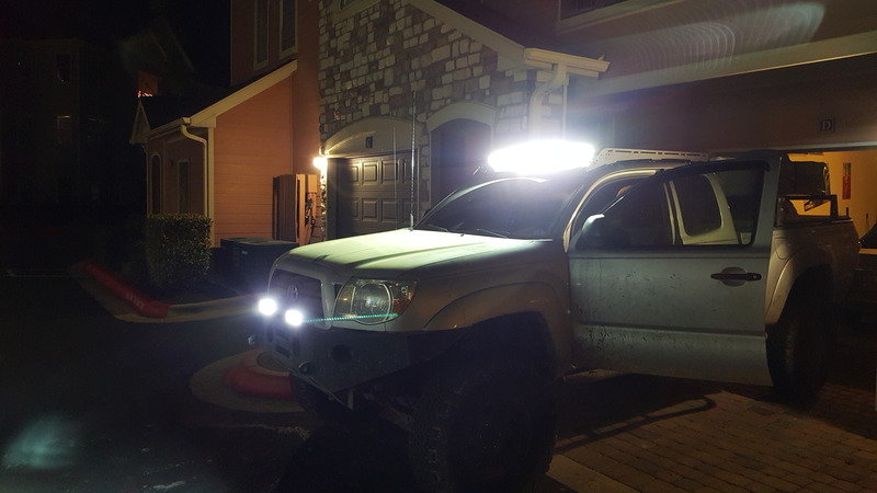

  7. Dec 28, 2016 at 7:11 PM
    #147
    Spansfelder
    Spansfelder Well-Known Member
    Mar 9, 2015
    #150495
    1,999
    Austin, TX / Germany
    05 4WD
    Light output is pretty decent actually (imho):
