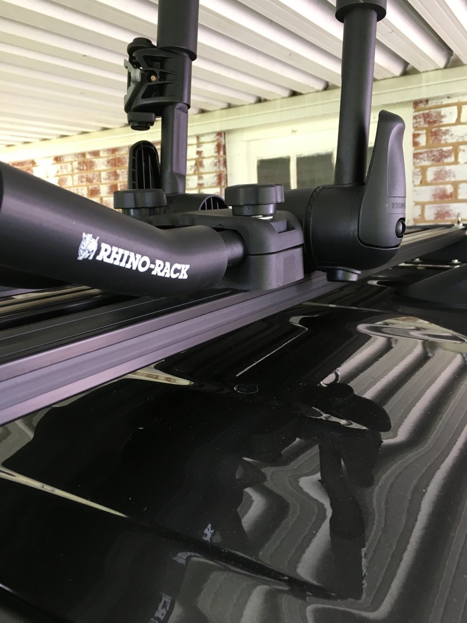

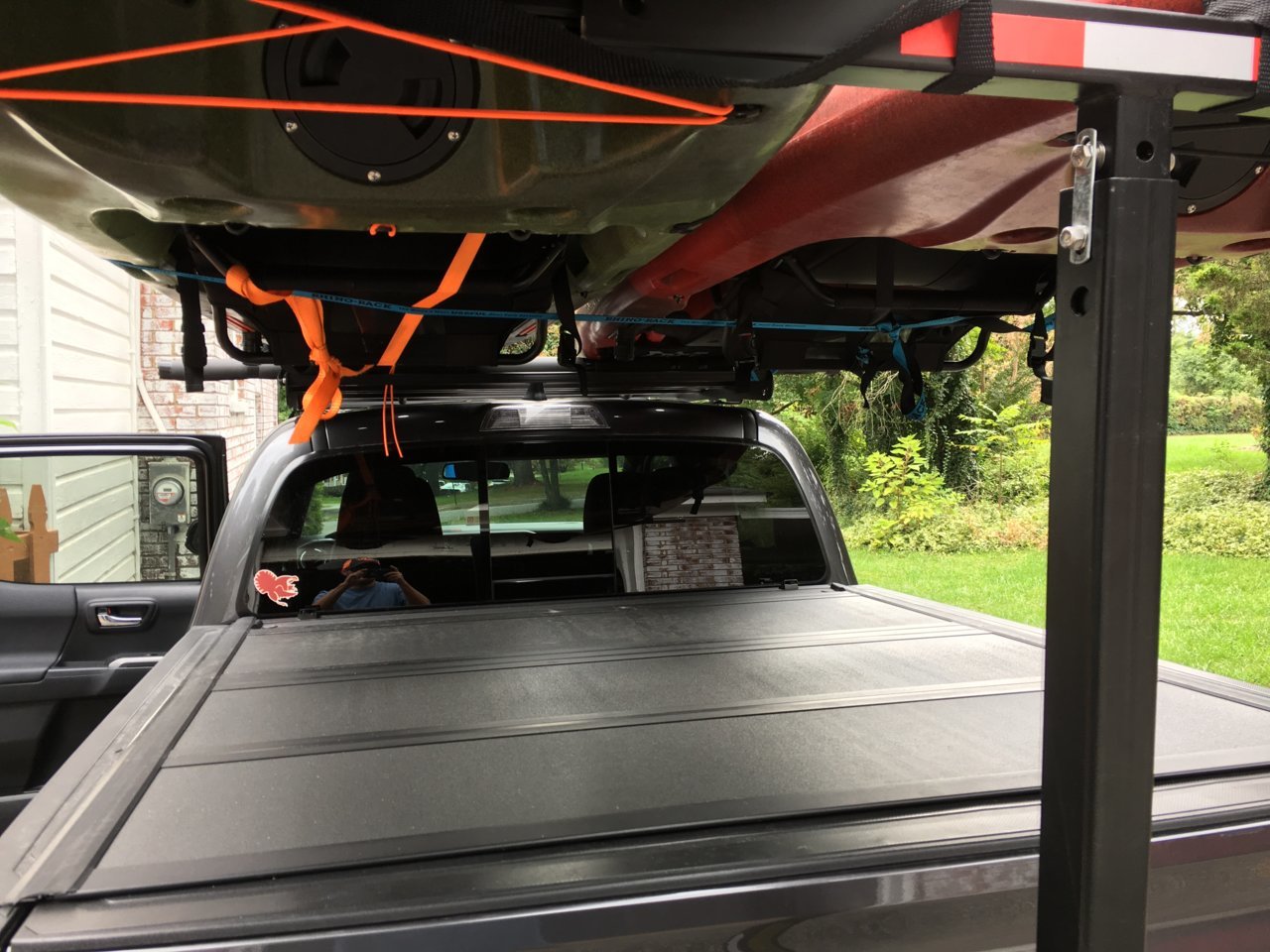

    I've tried a few options, modified Rhino Rack J Cradles (4 available if you want them), bed extender with raised 72" bar and camper shell roof rack. The J cradles are the most secure, but also add the most wind resistance and aren't the easiest to strap to the boats to. You can do two cradles or four. IMG_0983.jpg IMG_0961.jpg IMG_1242.jpg Bed extender/raised t-slot bar is a sweet setup but you have to reinforce the boats at each contact point because bed flex and wind movement will run the plastic. Trying the camper shell setup this summer ...

    I have the exact same J bars.... did you have to do any modification to get them to work?
