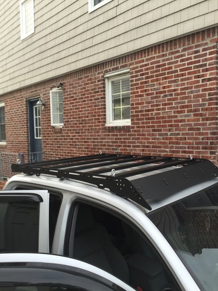

    Wow that looks really good!!

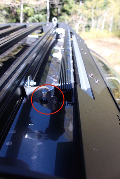

    I am a little hesitant to mount it that way. The weight of the bar is shifted way forward, and its only attached to the mounting bracket by a single screw on each side. Don't want it to fall off. Plus it would be very easy to steal. I dunno. Maybe I'm just over-thinking this.
    I think you should make some brackets. I'll be down to purchase a set :)

    The theft part I get. I am looking into some tamper proof hardware to start supplying on my end. As for strength, the lightbar is light enough I haven't had any problems. I have tested the 40" and 30" this way. You can actually fit 2 bolts on each side in the slots for more strength.
    I will work up some beefier brackets and have them on hand.

    You mean using 2 thinner bolts to and put them both through the same kidney bean shaped hole in the bracket that attaches to the cross bar?
    Sweet! Put me in for a pair whenever they are ready.

    Shouldn't the light fit closer to the wind deflector cutout?

    No, I meant back where the bracket attaches to the extrusion bar.
    In the spot you pointed out I just angled the bar how I wanted it and added some loctite so it didn't back out. That with the nylock nut has kept in in place just fine.

    Technically you could arrange it a number of ways depending on preference and the lightbar you have.
    I designed it to work this way for 2 reasons.
    1) Sitting back further it is more protected. During last winter I was just getting to know heretic, I came up with this design and had the lightbar sitting forward at first, it got hammered with snow, sleet, and the spray from the vehicles in front of me. It also was the furthest thing forward the roof. On trails with thick forest like some of the trails here in utah, my roof rack constantly gets hit by low hanging branches. The lightbar was right in front getting hit.
    With it tucked back it helps in both of these cases, you can't reduce all of that stuff but this way helps it out.
    2) Glare. If you have seen the numerous threads across the forum about lightbars glaring off the hoods of trucks and hood scoops you know it is an issue many have tried to mitigate. By sticking the bar back a littler further the deflector cuts off the light that would have hit the hood. Yes you lose a small amount of light but most of it would have been hitting the hood of the truck anyway. I have never had any glare on mine with a 30" or 40" lightbar and have driven some pretty long nights through the desert in southern Utah.
    Also, Personal opinion here so take it with a grain of salt. I think it looks better. Not that having the bar up right in the cutout looks bad, but I like the way it looks tucked back in behind.
