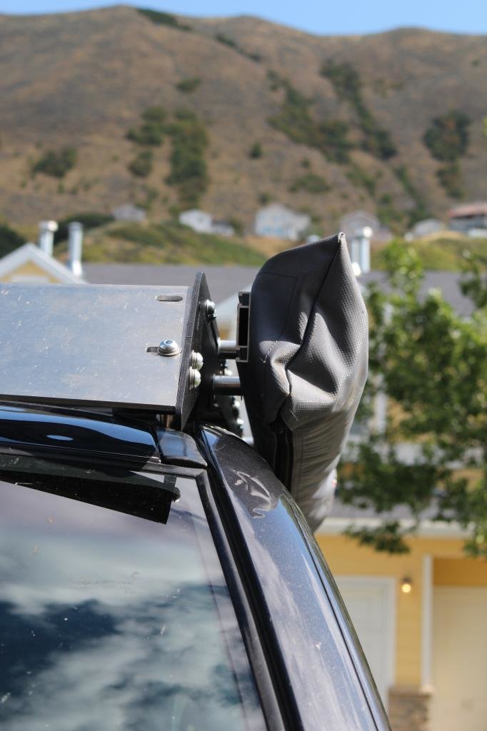

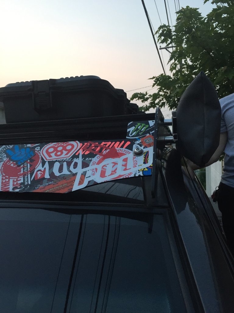

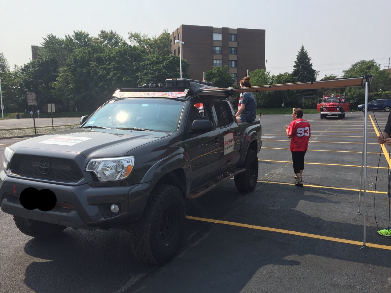

    does anyone have pics with a awning attached to one of these racks?

    IS that mounting setup something you thought up? and thanks thats exactly what was looking for!

    I think that's how it is from factory :notsure: I actually bought it from @zscott

    Cool thanks, probally option he offers. Soon as sell my 81, one will be mine!

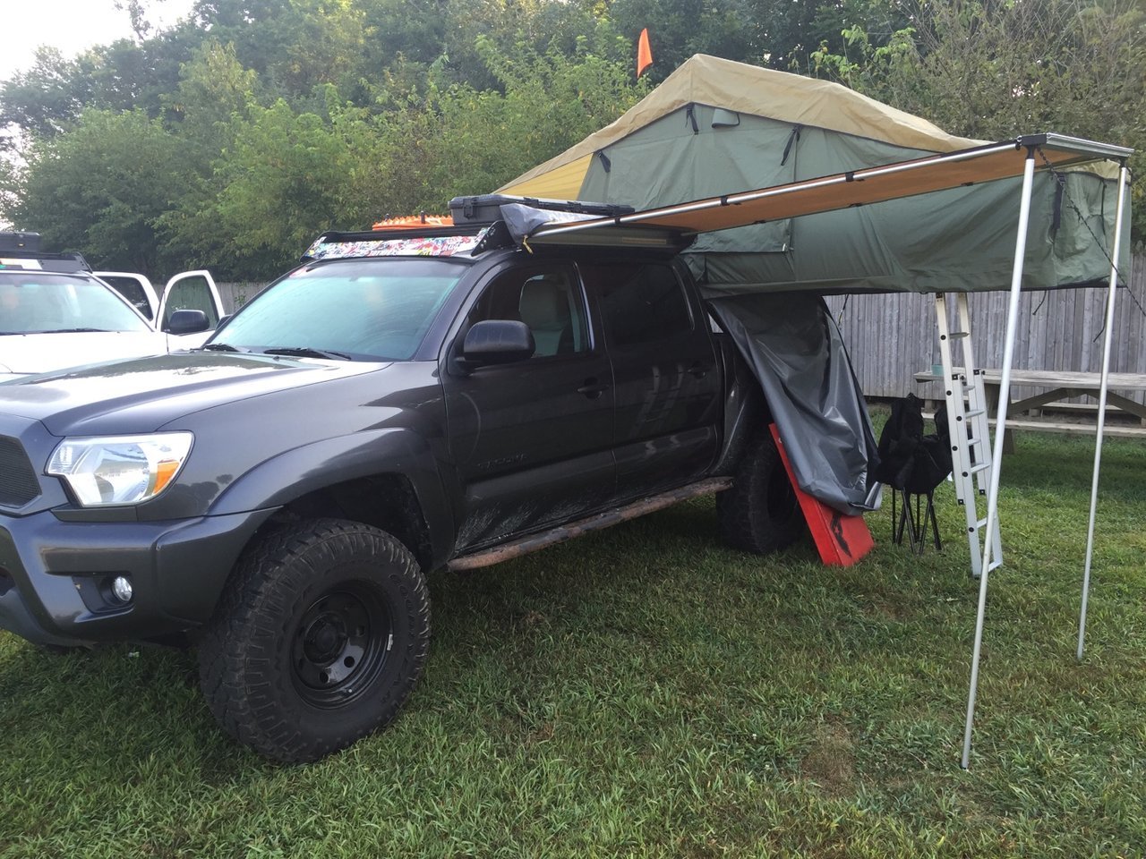

    What size is this awning

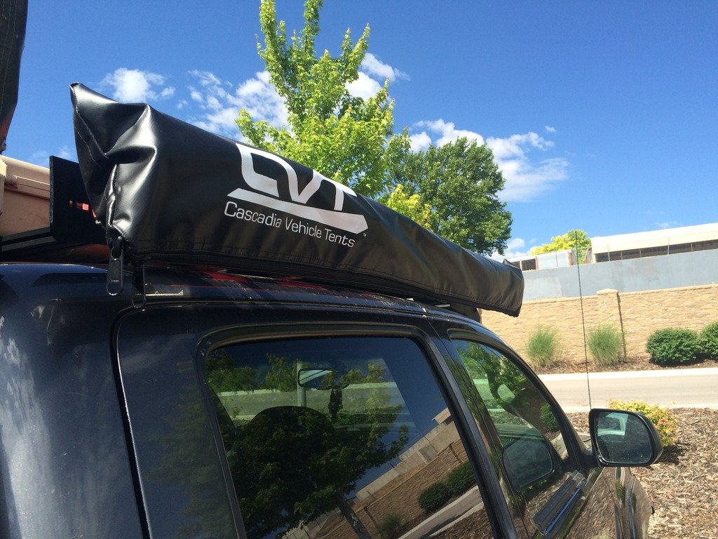

    A 55in, CVT doesn't make anything smaller and a 79in would be too long!

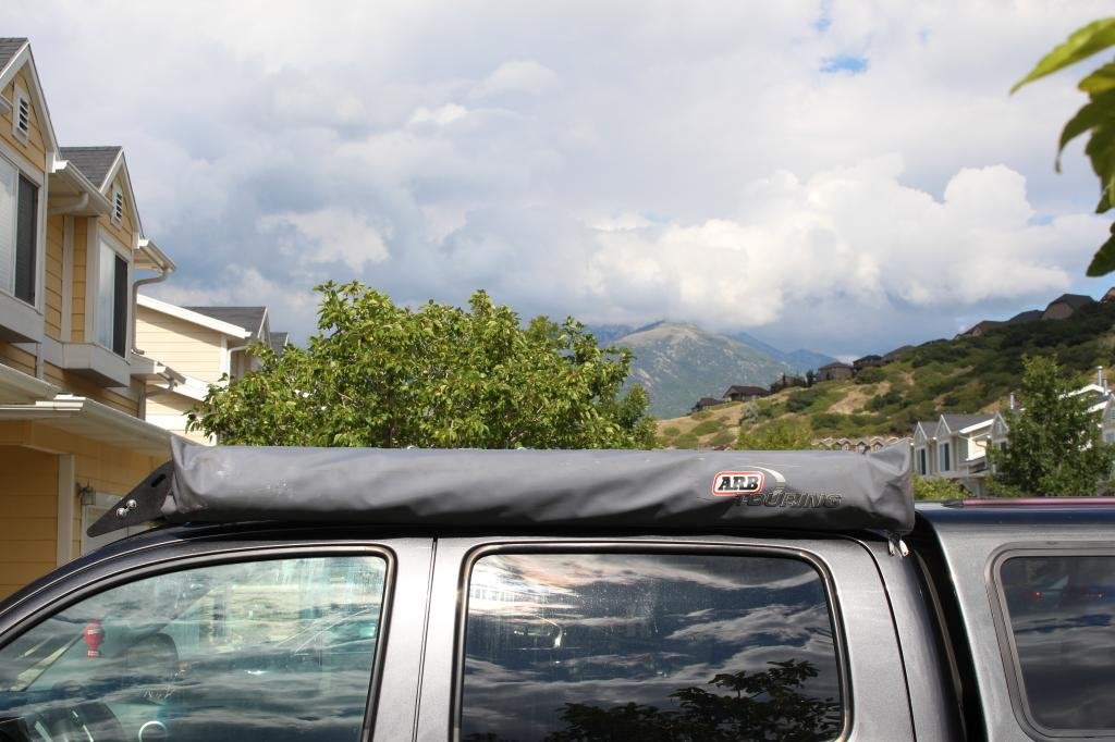

    The CVT 55"

    The ARB awning????

    It is the 1250 (roughly 50" long)

    Very Nice mounting, ill be on your order list soon

    How much is the awning mount?

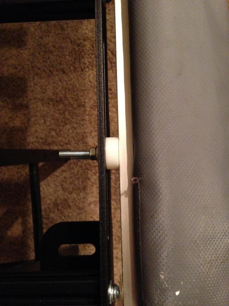

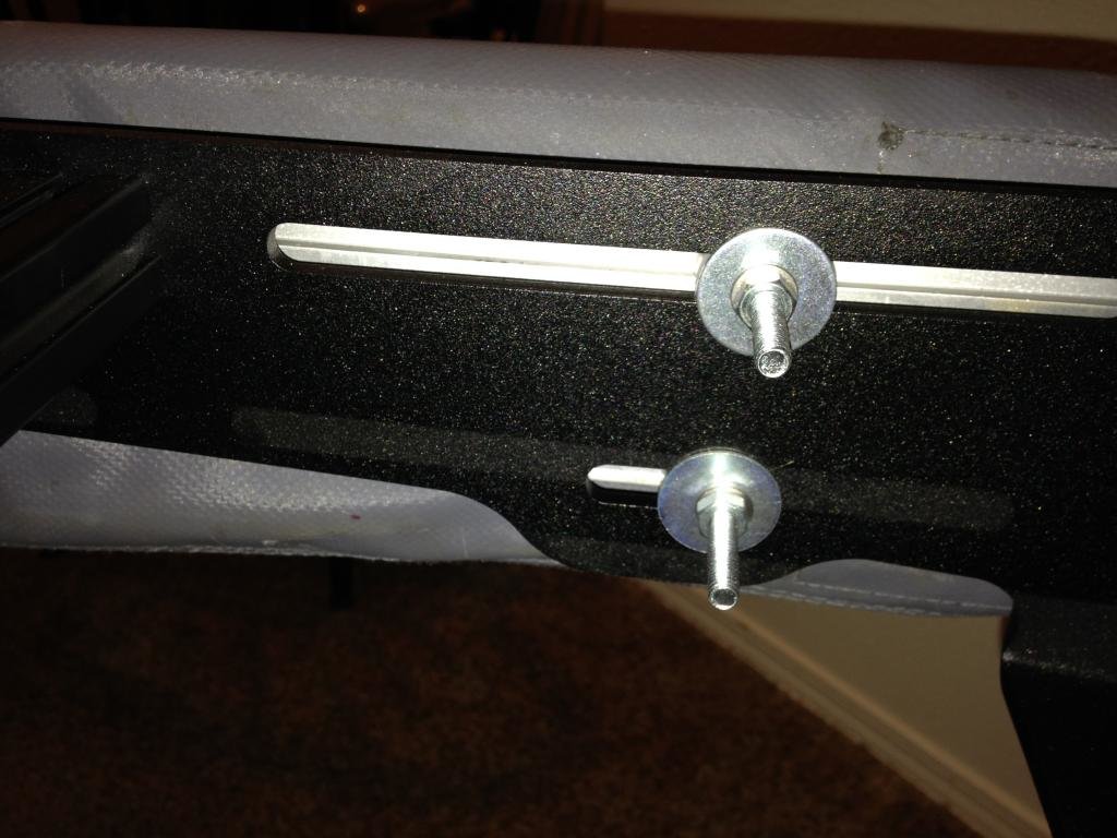

    On both of my pictures I didn't have a special mount. I used the L brackets from CVT and bolted them to the top of the crossbars, and with the ARB I bolted it to the side with some nylon spacers I found at Home Depot. The CVT method was easier and more sturdy though in my opinion. The ARB method got in the way of the door cause it sat a little low.

    Darn. I want the ARB since it is shorter and I have an access cab but I want good quality.

    The arb could be mounted the same way it just doesn't come with the l brackets like the cvt. I am sure you could find something to fit the same way. One of these days I will have the time to design something specifically for the racks that fits all awnings
