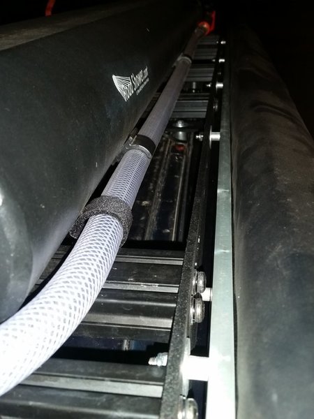

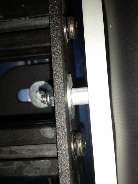

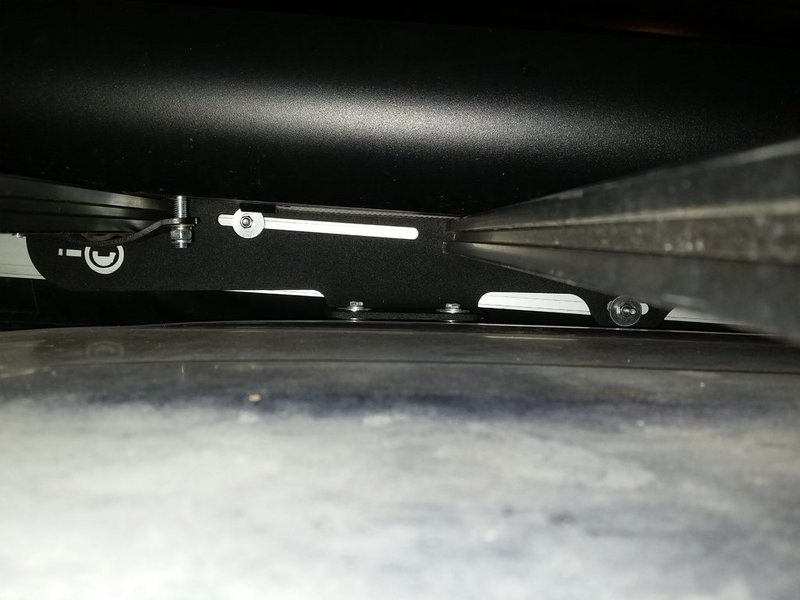

    I myself have tried different methods to mount my awning. I did not feel comfortable mounting the awning with the "L" bracket, just didn't feel safe, especially on the freeways. This is the most easiest and stronger method that I came up with. I installed my awning using (7) M6X1.0 1.5 inch long stainless steel bolts, (7) I/2 inch thick spacers, (14) fender washers and (7) self-locking nuts. I installed (5) bolts on the top groove of the awning and (2) bolts to the bottom groove of the awning on to @zscott Prinsu racks. There are two (2) mounts on the lower portion of the Prinsu rack where you can mount 2 bolts for the lower groove of the awning. This supports the awning rail from moving in/out movement. The two grooves on the awning rail for installing the bolts are 2 inches wide apart center to center. Zach's racks mounting grooves are exactly 2 inches apart center to center. Remarkable when I came up with this idea. No need to drill extra holes. Here are some pics. I'll get some betterpics during the day and re-edit.... Zach, your racks are awesome dude!!!!!!!!!
    5 mounting locations on top groove of awning rail to Prinsu rack, 2 lower mounting points on lower groove of awning rail to rack. Total of 7 mounting points for a stronger, safer install.
    Lower groove mount, right side of picture, inside of rack, fender washer and self-locking nut.
    Bolt, 2 fender washers, spacer, (one on each side of Prinsu rack) self-locking nut.

    Nice review! Glad it worked out for you that way.
    The only issue for access cab owners is that the additional slots for the lower mounts wouldn't fit due to the different curve on the roof and the shorter length. Otherwise @SixthSnail could do it that way.

    I agree with you Zach, these access cab owners really have to use some ingenuity to get projects and mods installed. Hope this install above helps some DCSB owners with another way to install.
    Maybe you could redesign a few cutouts Zach, that would give these access owners some versatility... Maybe they can just drill a couple hole, just worried about losing strength if drilling more hole in a bad locations is all...

    Access cab racks are smaller in length, so all would be required is 3 or 4 mounts on the top groove of the awning and 2 mounts for the bottom groove, so I'm assuming just need to drill (2) 1/4 inch holes for the bottom mounts. Just layout the measurements, check twice, then drill...... If they want a strong and safe install.... My awning is 6 feet, so I used more mounting locations.... But i'm sure that prinsu access cab racks have a steep curvature to them to match the contour of the roof....

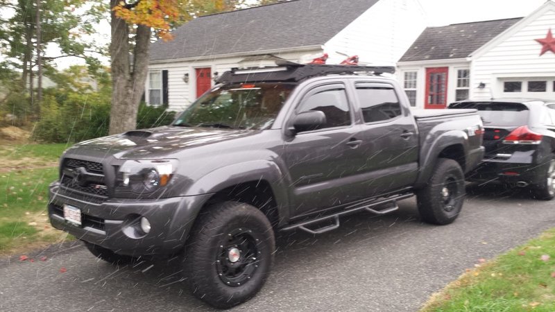

    Installed Rack yesterday! Very happy with the fit and finish. Took a bit of time to install but nothing complicated, trying to drill the holes in the weather-stripping for the spacers took the most time. Thanks Zach!

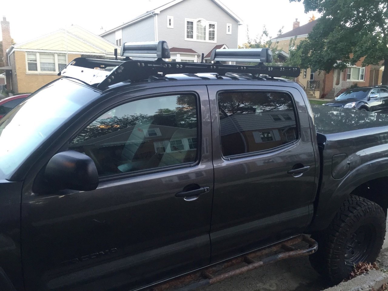

    20151018_163015.jpg hey taco friends...I've had my rack on for about 6 months now...gotten alot of great compliments to it along with my retrofit headlights...any chance any of you may know what hardware works best for the Thule snowboard/ski rack? Thanks Tacos!
    RileyLAFD likes this.
  16. Oct 21, 2015 at 7:14 AM
    #2736
    geekhouse23
    geekhouse23 The "Liftman" - @DrFunker
    Jul 14, 2013
    #108251
    15,714
    2GMGMDCSB4WDTRDFTMFW!! TL;DR
    mostly stock, grocery gettin' Prius
    I used the hardware provided..the Thule rack will bolt around the crossbars of the prinsu rack with no issues:
