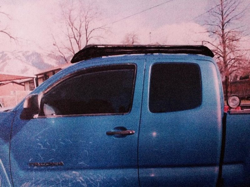

    why does the access cab rack seem higher than the DC?
    would it be possible to lower the 2 main pieces by bending the 6 mounting tabs higher, is there any reason why it needs to be 1.5in above the cab? why not .75-1in and also would you be able to add a few inches to the back of the roof rack?

    I really like the OG DC but I think the AC rack would look better lower with more length and a taper on the back

    The height is the same on the access cab as on the double cab version. The rails were just shortened. You could drop the height down to where there was .75" of clearance but that doesn't give much room for deflection if you had the rack heavily loaded and hit some good bumps. (Then the rack could damage the roof.)
    The other suggestions are great! These racks are always developing. The access cab version especially so I appreciate the input from those who have accesscabs.
