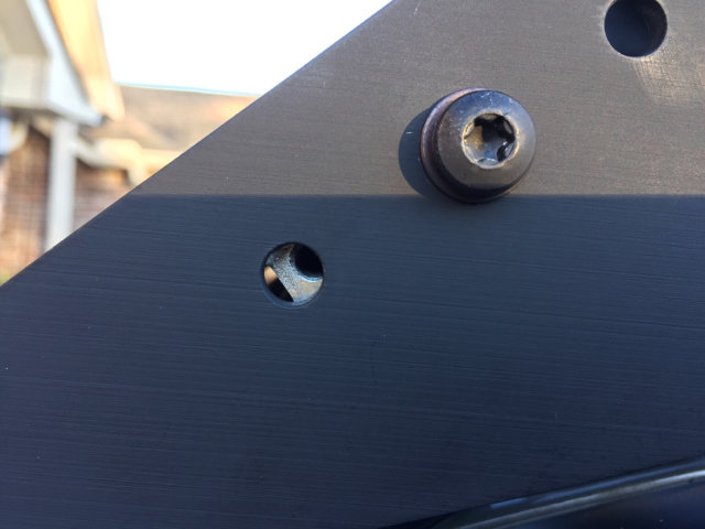

    @shawn_free just tried to put it on the lowest setting and the holes don't even line up. Maybe 1/4 of the screw hole is showing in the picture. After I took the screws back out and look its noticeable that the spacing between holes is different, only the middle two holes actually line up with the cross bar holes. @zscott

    that happened to me as well. I took a 5/16 drill bit and ran it through both holes... That made them slightly larger; everything worked perfect after that.

    I only had to drill the new style wind defector holes when I got mine in. I guess the older wind deflectors have bigger holes? :notsure:

    Not through the wind deflector, its the holes through the side tracks that go into the cross bar that holds the wind deflector. On mine only the middle two actually line up with the screw holes on the cross bar. So basically I can't put it in the highest position or lowest position unless I drill the holes out to widen them.

    I had the same issue. Ended up slotting the hole with a 1/4" endmill in a cordless drill. Here is my before photo.

    I think this is a corrupted file that got sent to the laser cutter. I know Zach knows about it, and I assume that he has since corrected the problem.

    There was a small batch (5-10) still trying to track down that for some reason, the laser jumped on those holes. I don't know why it happened but I have been watching out for it since and haven't had a problem.
    If yours was affected the best thing to do is slightly drill out the bottom two holes to make them fit. As mentioned a 5/16" bit is best. Also if you had the issue get in touch with me via email, and I will get you some free tie down rings, a cargo plate, or some other accessory for the mishap.
