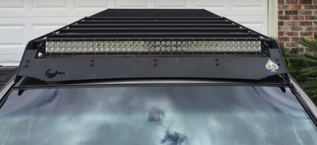

    One of the first dual row light bars I've seen in this camera angle.
    1. What light bar is it?
    2. How did you mount it?
    3. How far above the cross bars does it stick up?
    Thanks!

    It's a super cheap light off Amazon. I wasn't sure if I was going to like it so for $75 at that time, I wouldn't be heart broken if it failed in a year. Looks like the price has gone up a little.
    Eyourlife 42 inch Light Bar Super Bright Light Bar 240W Driving Bumper Lamp SUV UTE 4X4 Truck Jeep https://www.amazon.com/dp/B00NHMAJ40/ref=cm_sw_r_cp_awd_mdF1wbE7GZ7JV
    More coming. Let me find the photos

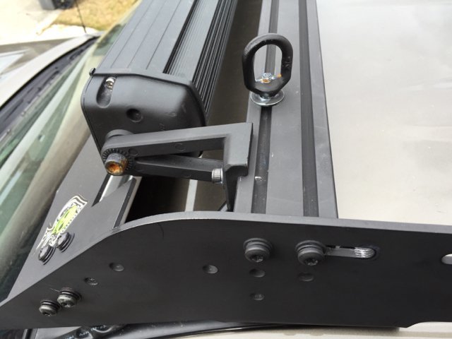

    Excellent- I plan on buying a super cheap Amazon light bar myself to start. Anything cheap is dual row and I wanted to still be able to put a kayak up there. I think it'll be fine. I'm assuming those are the mounting brackets that came wtih the light bar as pictured on the amazon page. They look like a perfect fit around that crossbar.

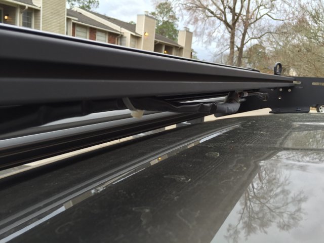

    I need to replace the hardware that's rusting.
    The top of the light bar is about an inch above the cross bars.
    I have plans to make a bracket that will connect the front crossbar and the bar behind the wind deflector. Hopefully that will drop the light bar a little more than the cheap cast brackets that came with it.
    I used some of the threaded inserts to attach zip ties to hold the cable up and then ran it down the side of the windshield.

    I did mill the channel of the bracket a little deeper to really grab the cross bars. The channel that came will fit the cross bars, just not as nice.
