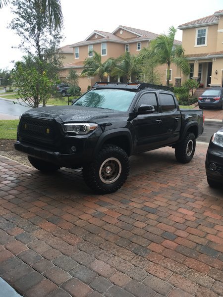

    Where did you get that light bar? I like the ambers on the outside. And are these amber lenses? I'm presuming so but not sure. Thanks! I've been looking everywhere for this photo

    Zach at Prinsu through Heretic.
    rmcabee and goblue82[QUOTED] like this.

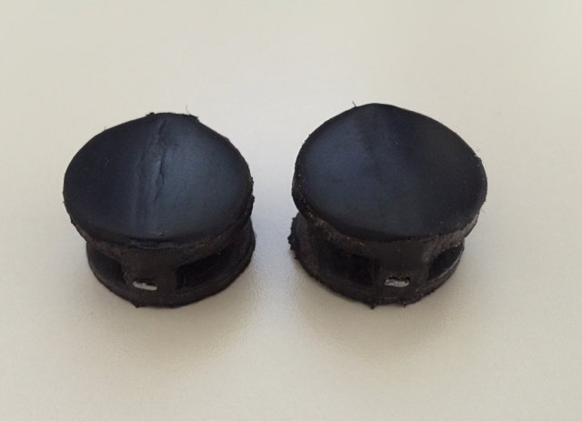

    The 3/4" leather punch works a million times better than drilling. I have done both now. The punch and a BFH go right through the metal strip
    Mcdees84 and Phoosa like this.

    Plugs from the punch
    Naveronski likes this.

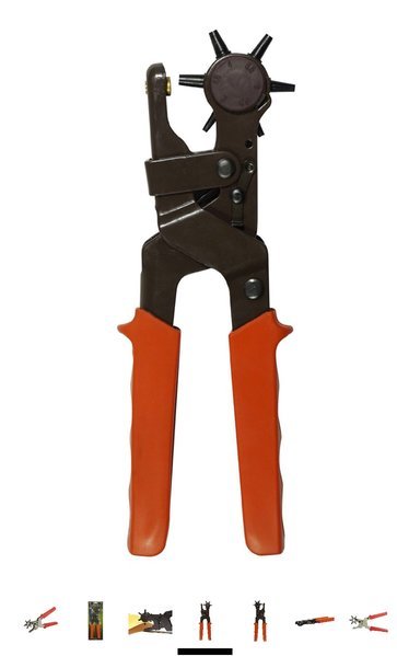

    Is this the leather punch?

    See the punch set at the bottom of the page, over on the left.
