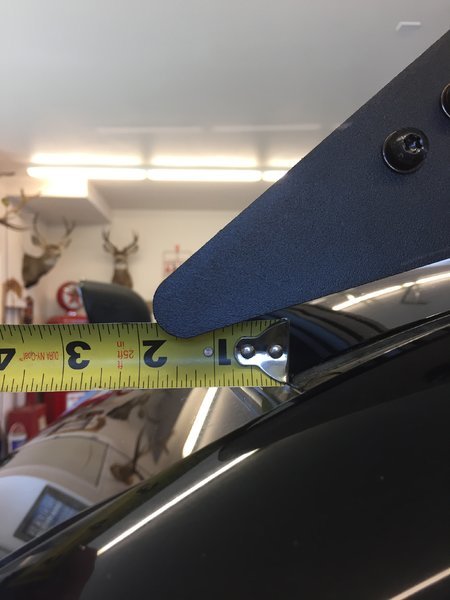

    Probably a question that's already been asked but,
    For the AccessCab are people still putting it at 1 3/4" overhang as per the instructions with positive wind noise results? I've heard mixed reviews. The stock mounting location double cabs are definitely farther back than where the instructions say to put mine. Any input before I drill this thing?
    This is mine.

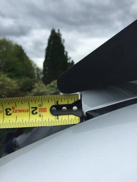

    Here is @northwesttaco double cab

    Put the wind screen at the lowest setting and see. Putting the rails too far foward can have the screen touching your windshield. In my doublecab, the screen almost touches the windshield at the lowest setting, and I get almost no noise.

    same here. its sitting up against the roof using the weatherstrip to make contact.. and right at the top of my windshield. lowest setting as well.

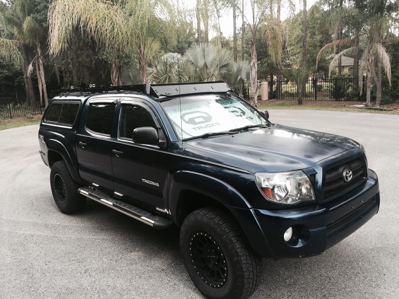

    Well I have my cabrac and toprac installed.

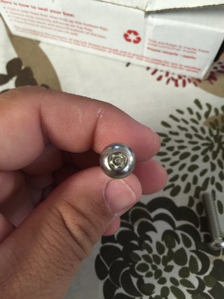

    Anyone know if these are the correct bolts?

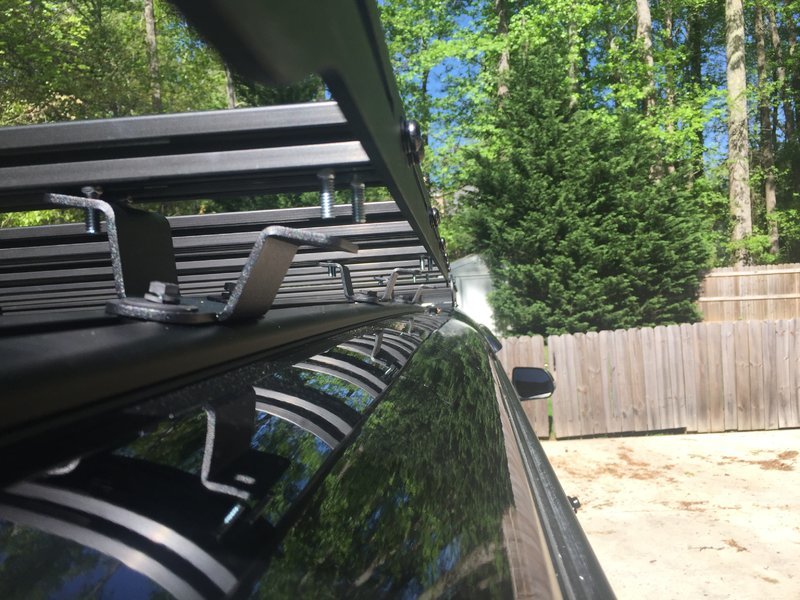

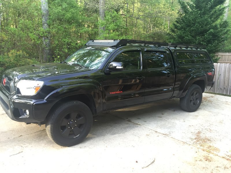

    What am i doing wrong?

    Will those bolts slide back and forth on the track? Also it looks like your track mounted to the shell has a slight angle to it, down towards the outside. Try fastening the outside bolts first loosely, then the inside bolts.

    Bolt the mounting "feet" to the crossbar first then bolt the rack to the shell :thumbsup:

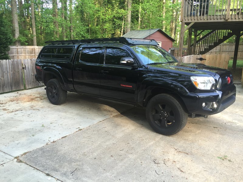

    I swear I read it the other way around before but I got her done! Thanks, got overheated and frustrated before so had to come get a clearer mind give me some simple instructions.

    Looks very nice. What kind of light bar is that? Did you run the wire down the windshield like everyone else or into the cab and down the pilar?

    Lightbar is the cheap Xprite listed below - 30" I picked up for $52 now looks like it's listed for $65. It's okay, get some wind noise and the way it's mounted like 1/4 of the light is blocked but it sits below my cross bars which I need. Definitely worth it for the money. And yes I used 16 ga lamp cord and it fit perfect down the windshield.
    I'm mounting backup lights on the back rack and am having trouble figuring out where to run those wires... cleanest would be drill a hole through the top of the cap.
