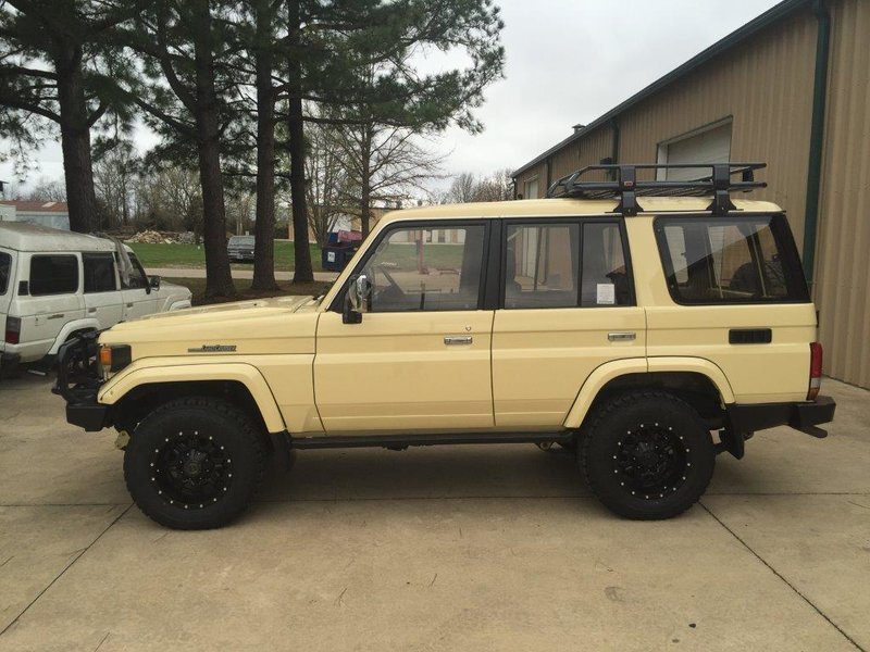

    @zscott, Have you ever fitted your 80 series rack to a 70 series? This new addition to my garage is the reason I ask.
    omaguz, Phoosa and BYJOSHCOOK like this.

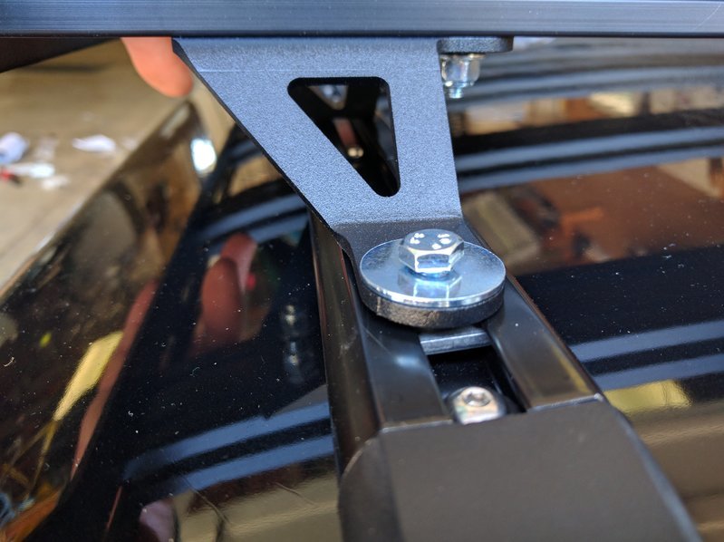

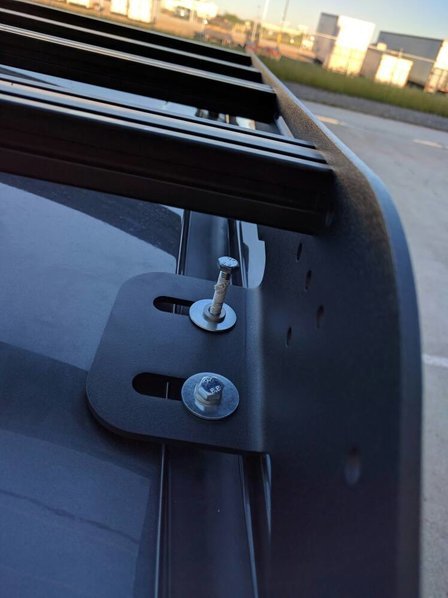

    I am having a problem with the 6 ft bed top rack installation. Any input would be greatly appreciated.
    It seems the bolts that hold the feet onto the camper shell track are too long and interfere with the bottom of the track and cannot be tightened down all the way. I have followed the installation instructions at the prinsu website and noticed the feet in the instructions are different and may be thicker. Has anyone else run into this issue?
    See pic below: gap below screw head due to bottoming out in the yakima track

    I sent you an email on this too but the tracks you have are shorter than any I have ever seen. I am guessing they were a limited run or the dealer swapped them in place of the standard yakima/thule ones. They will work fine I will just have to get you a shorter bolt so it doesn't bottom out.

    I haven't. Been working on a 60 series one for awhile but nothing for the 70 yet.

    What cap do you have? Usually they are within 1/4" of each other?

    Any specific measurements and pictures that you'd like to get the ball rolling?
