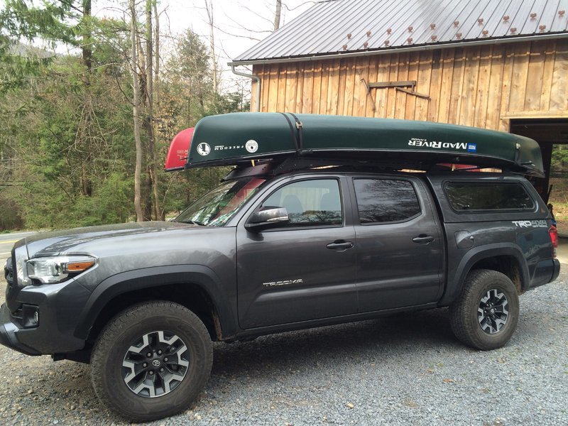

    Can someone strap a canoe right to the prinsu or are yakima bars also needed ?

    You can strap a canoe to the rack with no problem at all. On the other hand, I do utilize Yakima bars for extra width so I can strap 2 of them side by side.image.jpg

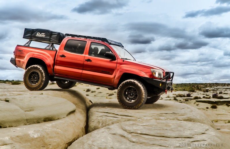

    I flipping love this rack thanks Zach!!!05-08-16 Craig Tacoma Buckhorn Desert.jpg

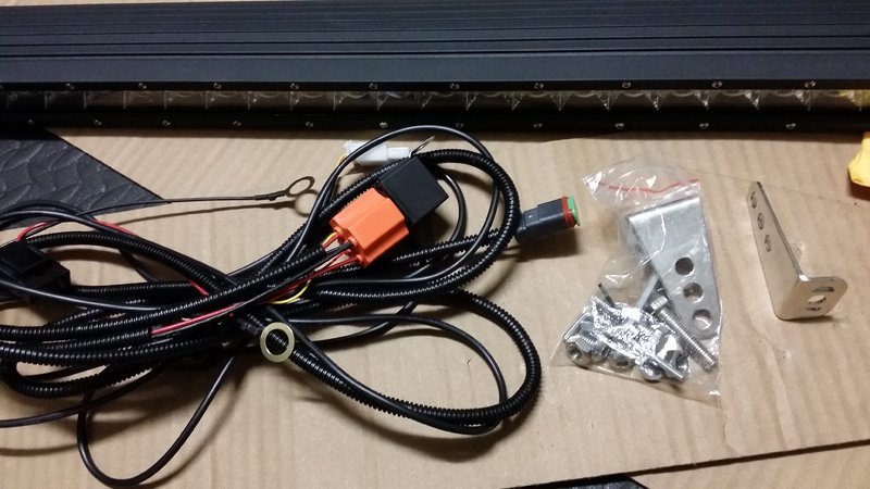

    How did everyone else mount their single row light bar with a wind deflector? Mine came with these only

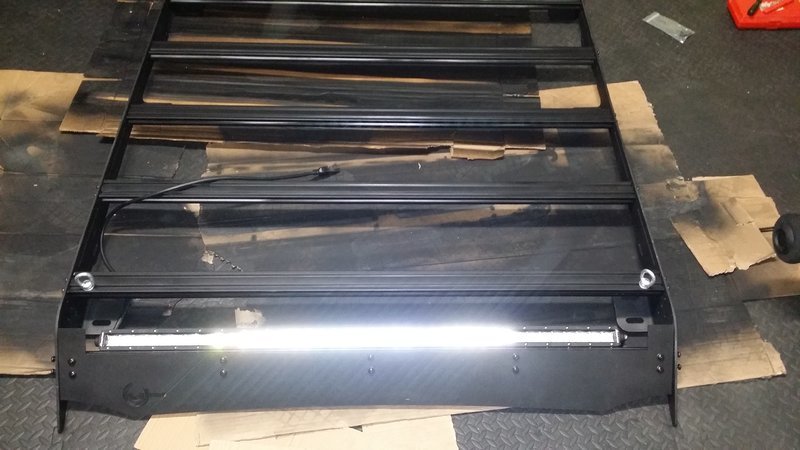

    I wanna put lights on mine some day...

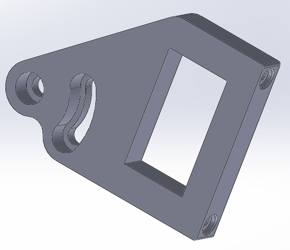

    workin on mine as we speak..

    nice, i'd keep it a solid one piece that the cross bar slides through. Then add the through holes for the bolts to provide the clamping force via T-Nuts.

    that's a great idea! unfortunately, how it will be sitting, I wont be able to get the cross bar and lightbar in there as one piece.

    My brain might be fried all ready for the day... I think i should have said a one piece design instead of solid. i interpreted your design being two pieces. it looks like it would be bolted together from the two screws in the back. one piece design would add an additional small amount of security.
    I would assume you can remove the crossbar and wind reflector (for accessibility). Loosely bolt the light bar to the mounts, slide the crossbar through the mounts, add T-Nuts and reattach the crossbar. Make your final adjustments as necessary with the wind reflector attached.
    I like where you are headed with this either way.
