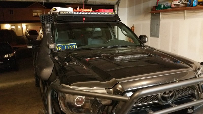

    Well it was a pita but got the front rack on

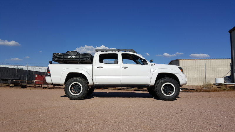

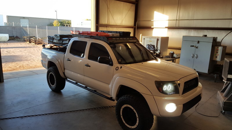

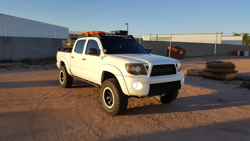

    :wave: Mister February... lookin good. seems we had similar tasks this weekend. lol
    finally got my goodies installed on the roof rack!
    Plano 43" case, my Expedition One Water pack I picked up for a stupid good price at the Overland Expo (Rotopax Fuel pack will be under the water), and my Maxsa ramps.
    before..
    after..
    super easy.. 1/4" carriage bolts by the length needed for your accessories. washers, wingnuts, done. I will probably run a cable lock through the ramps and fuel/water packs. the Plano locks.

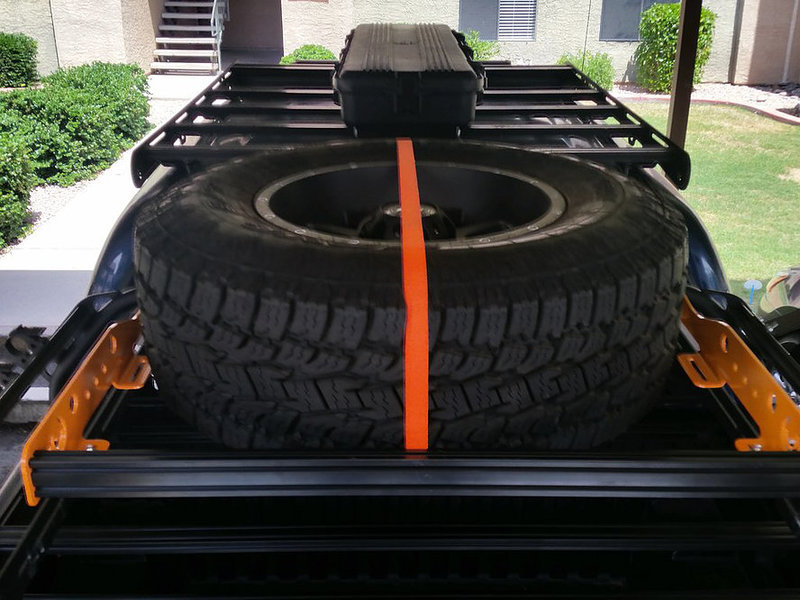

    Was wondering if anyone had a spare in the basket yet... Would like to see that. Probably just cable lock it for security.

    Just starting
    I have a basket.. But haven't monted it yet. I did find this picture...

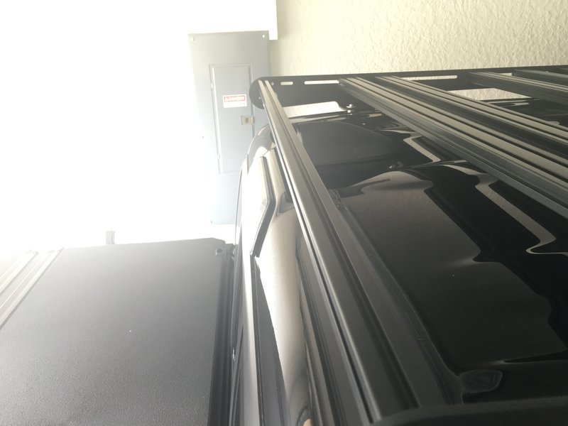

    So I installed my cap rack last week and that thing is awesome. One issue I ran into involved the angle of the rails on my cap. The cap is not flat across the top, it has a slight arc. This means the cap rails are angled outward. When I bolted the Prinsu rack on, it pulled the outside of the rails off the canopy slightly since the rack is completely flat. I was worried this would put undue stress on the cap and possibly compromise the seal on the through bolts. My solution was to shim the feet where they attach to the rack using extra washers. @zscott This seems to have worked out fine but I'm wondering if I missed something during my install.

    I haven't ever seen one that was angled quite that much but what you did is the correct solution.
