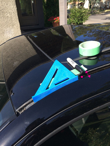

    So prepping my 2016 for install, I taped the roof, marked the hole locations, reinstalled the weatherstripping to mark hole locations and i noticed the mounting points on the truck itself are not centered the narrow way. Should i punch the holes centre on the weather stripping?

    Since the bolts are 6mm and the inside diameter of the spacers is more like 9mm you will have a little wiggle room. Even if the holes aren't exactly centered the spacers can be pretty close.

    Looked to me like that was the case. Maybe off centre towards the inside of the cab by 2 or 3mm?
    Also, i'm punching the holes, not drilling so I shouldn't have to cut the underside of the weather stripping with the metal spine off as per your instructions?

    Yeah with the punch you dont have to cut the spine prior. It can make it easier but not necessary. Just know the spine will take some force to punch through.
