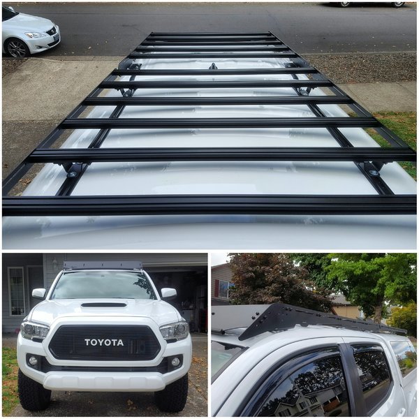

    Installed mine a couple days ago. The front gave me problems. I had to tap the two front holes on each side of the cab because there was extra metal covering the hole making it hard to thread the bolt in. Other than that it was easier than I thought. Very happy with the product...

    That looks amazing! :drool: One day I'll have a camper top and be able to do this

    Hmm that's weird mine was on point...
    Thanks! You should definitely do it...
    My Snugtop came with Yakima tracks installed. You can try and go that route...

    The bolts were all the same length M6x100. Hmm wondering why u had issues. Only issues I had was the front two holes on both sides not threading right since there was some metal in the way of the hole so I tapped those with a M6 tap and all was good.

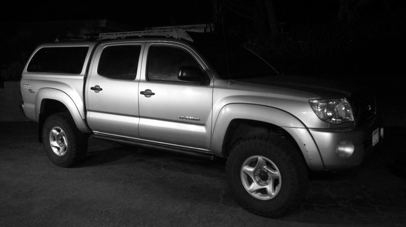

    Still love my rack.
