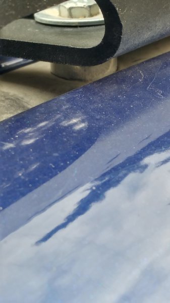

    Pictures? That's my favorite method of learning next to hands on. I'd appreciate that. Thank you!
    Zero leaks here. Rtv sealant worked great. Blob a Hershey kiss sized amount into the hole as the directions say, drop the spacers in, drop the rack on, and slide the bolts right through. Easy peezy. I'd say install is a cinch but i've seen some grown men do some silly things with tools before. If you're at all good with hand tools you will have no problem.

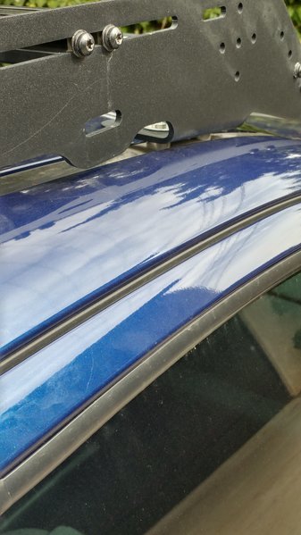

    Nahhh, Bruce. I've seen your rig. You're legit, man. Weather stripping give you issues? I've noticed that's what gives most people problems. The 3/4" punch method is what I used. Super clean look and easier than the rotary tool method imo.

    A 3/4" punch will stab through the wheather stripping?!?!

    That's affirmative. Measure twice (I eye balled) and give it a good whack or two. Still gotta remove the weather stripping though (obviously) and place on a wood block.
