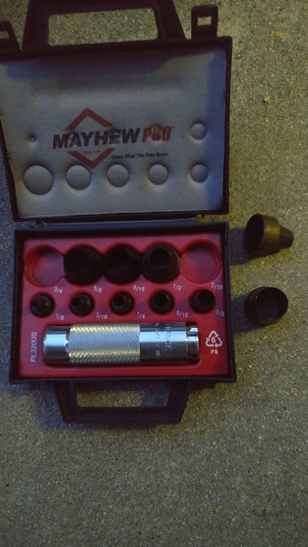

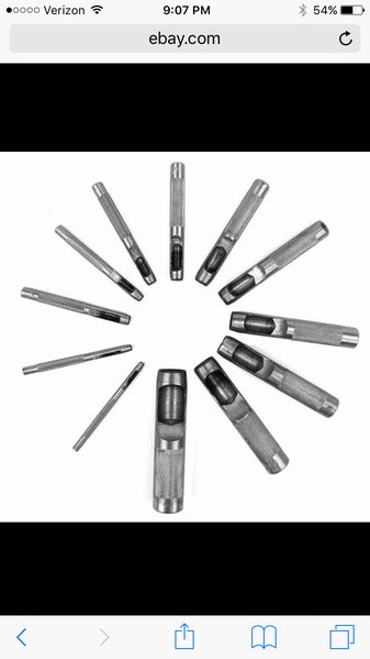

    You guys are talking about a regular punch right? Just like a solid metal cylinder? I don't see how that punches through something that thick..

    This is what I bought and used... 2x4 and rubber mallet..

    The metal rib isn't that thick. Give it whack or 3 and you're money

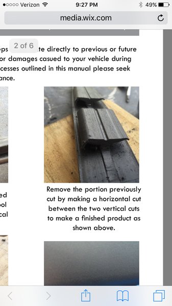

    Once you cut away area as shown it's really easy...

    As someone who used a drill bit: punch is the way to go.

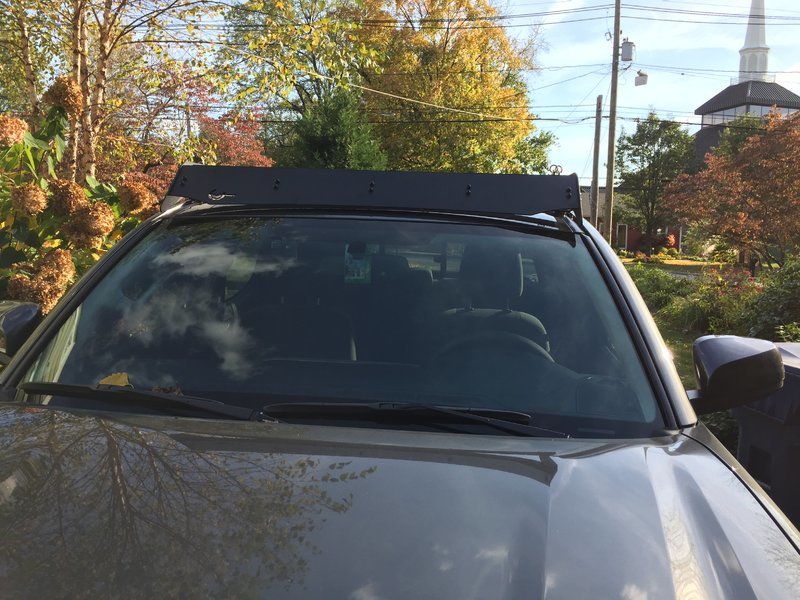

    Sorry it took me so long to post pics! Here you guys go. I just used the stock brackets, slid a screw in the profile and used a lock washer, fender washer and nut.

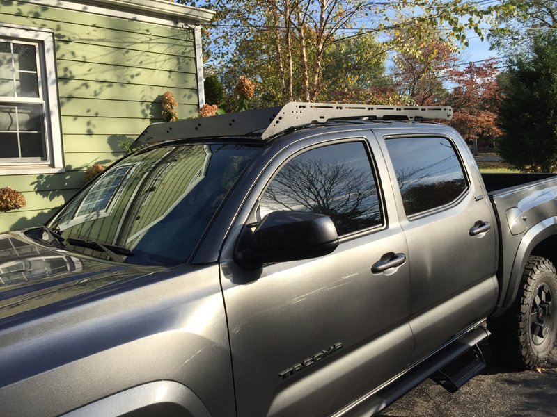

    Rode up to Boston over the weekend to pick this up and install it.
    Then I took the cargo baskets off when I got home since I don't need them right now and it sounded like I had a trumpet player on the roof on the way home.
