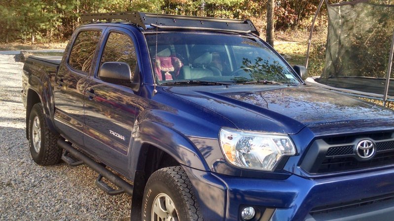

    Ok finally got around to installing the roof rack!! I love it! Just gotta mount the light bar!!

    Bro, truck looks good, but FYI exclamation points cost the same as periods...

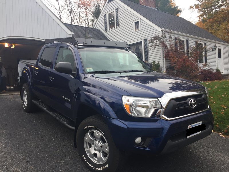

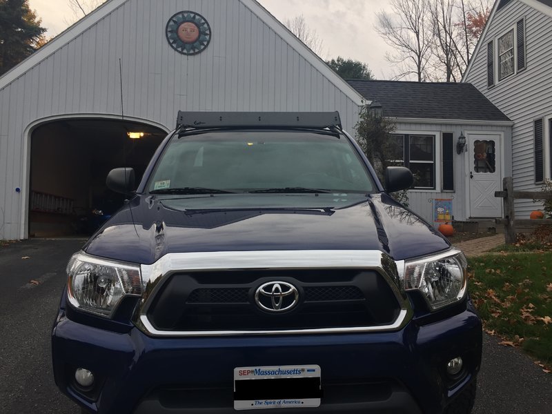

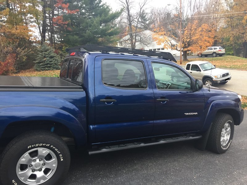

    So my cabrac came in on Tuesday night. Got it installed Saturday thanks to some help from a couple of my buddies. It's a two or three person job getting it on the truck. Just as an FYI some of the mounting holes on my truck were definitely not in the center of the rail. Strongly advise careful measurements when doing the weather stripping steps. I used blue painters tape a carpenters square to help mark things. We ended up doing a side ways capital H over the hole to mark the center. Worked perfectly. Also the 3/4 punch was definitely worth it. We had no issues but it was a bit tedious making sure we got things lined up right. Two engineers and a carpenter we probably over engineered things. Side 2 went much quicker. Aside from taking extra time on the weather stripping all in all the install went pretty quick and easy.
    The shark-fin on the back was not an issue at all. In fact there's room between it and the last cross rail. Mine's a late 2015.
    I got a little bit of wind noise above 50 but not too bad. Kind of expected it. I'm going to move the deflector around and see if it helps.
    Folks this thing is rock solid and it looks great! I already got few compliments and it's only been 24 hours.
    Zach did a great job building these. Thanks Zach!

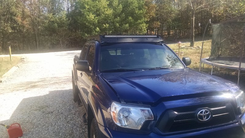

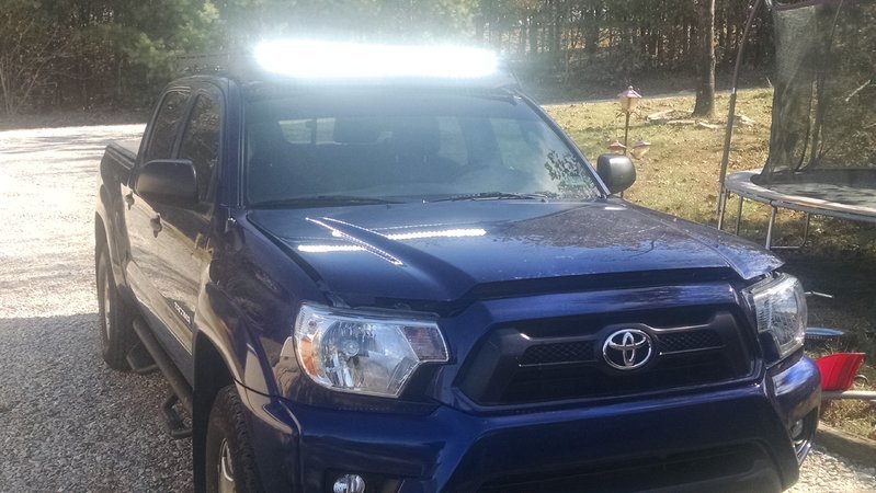

    Looks great!! I installed mine Saturday and installed the lightbar today!! IMG_20161106_124226981.jpg IMG_20161106_124203763.jpg

    Which light bar did you go with? I have yet to install one as I'm not sure what I want up there. Also don't want to buy one that cost as much as the rack itself.

    I got mine from autoanything! It's a 40inch Single Row Race Sport Spot and Flood Combo. I think mine was on sale for about 320.00 free shipping!! It's pretty bright. No wind noise at all. Single Row is the way to go. Retrofit Source has a good deal on a 40 inch single row!

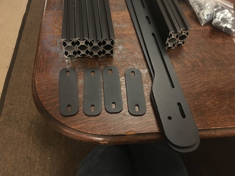

    So I got my long bed top rack today. I read through the install instructions but didn't see these 4 plates mentioned in there at all. What are they used for?

    On some shells you will need them for the front and rear mounting feet to get it to sit level. Usually ARE shells need them. LEER and snugtop do not.

    Looks great. I got the rack on my cab solo. Truck was freshly washed and I draped a blanket on the cab to assist while I lined it up on the spacers.

    I see you didnt trim off the excess fairing weather stripping either. At first I thought it looked funny but now I'm cool with it. Nice color Tacoma.
