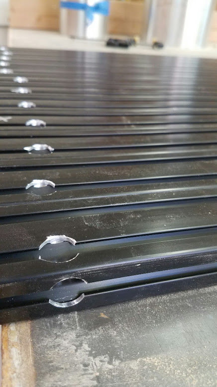

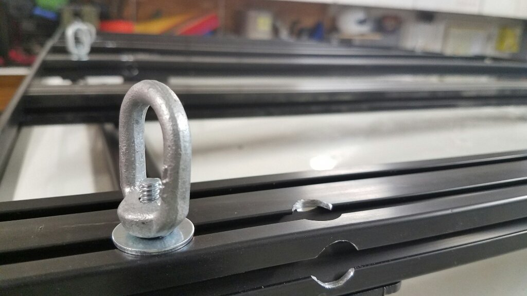

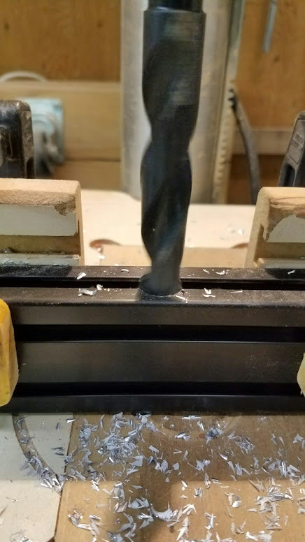

    I was back and forth with what kind of bit to use. I concluded on starting with a standard 5/8" or 16mm twist bit, but I went prepared with a 5/8" hole saw, and was prepared to buy an end mill bit. I clamped the bars on both sides of the chuck, and had block stop, and gradually began just slowly and with very low pressure chipping away. I realized after a while that I could probably push the drill harder, and eventually went from a ~48 second drill time, to about 6 seconds. There are a few holes where the clamps didn't hold quite enough, and the bars got walked on a little, but it wasn't bad. I started off at about 200rpm, then ultimately ended up about 640/720.
    I was able to get a handful of holes drilled with no clamps, the aluminum is soft enough that the bits just chomp right through it. Now, if I really wanted to, I could go at it with my deburring tool, or a really big countersink bit. It's smooth enough now, doesn't really need much improvement.
