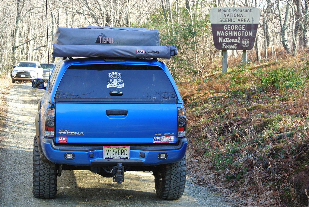

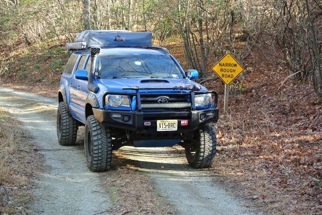

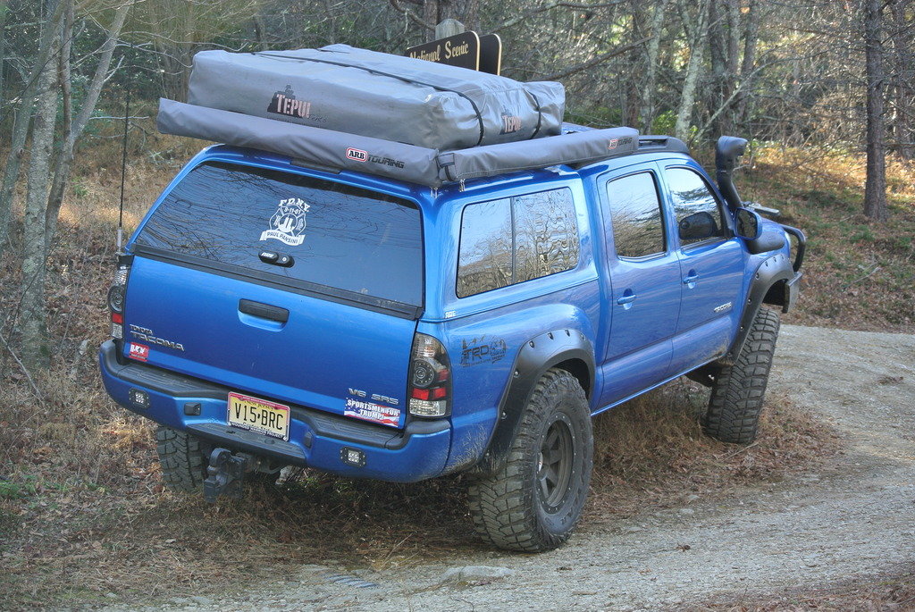

    I actually just used his awning mounts for my ARB awning and was abe ti mount my tent as well.. You just have to slide the tent over a bit. I had a little over hang on the one side, maybe like 2 or 3 inches but it worked fine. I as on a 3 day trip from NJ to VA. I'll see if i have any pictures

    Here are some pictures.. its a little hard to see how the tent is mounted because of my rear awning but you can see its a little off centered bc of the awning mounts,but it worked fine for me.

    Nice, thanks!

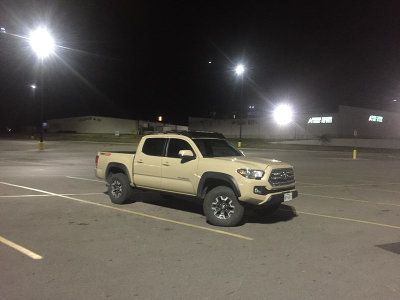

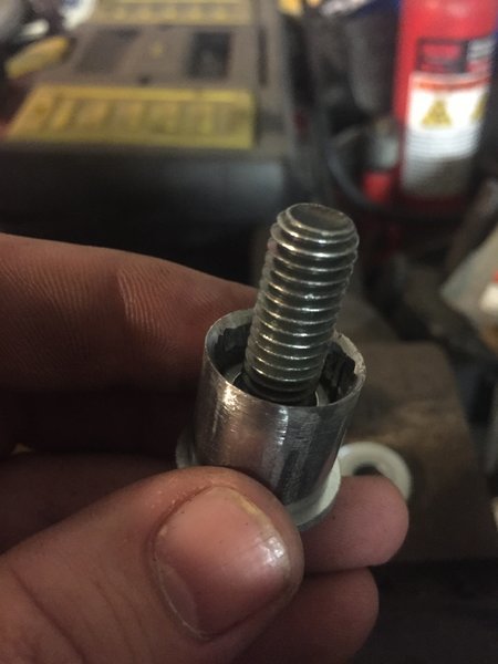

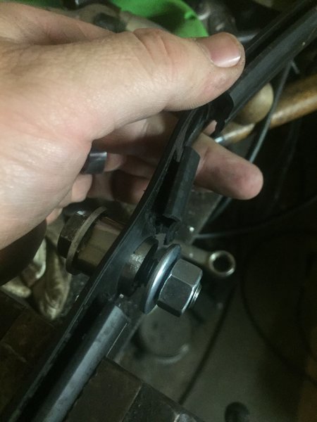

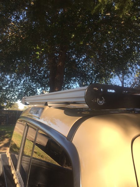

    My side rails and front panel came back from my local powder coater today. Got tired of looking at them on the coffee table because my punches haven't gotten here yet soooo... I made my own plug cutter out of a 3/8" bolt, some washers I had and a little chunk of 3/4" OD tube I had laying around.IMG_2768.jpg
    Got the rack assembled and on the truck and light bar mounted. Haven't wired in the light bar yet as I am waiting on switches, relays, weather tight junction box and some seal tight connectors to get here. I am planning on several sets of lights on the roof rack and will be mounting the junction box on the rack itself. I will have one 12v+ 14ga, a ground 14ga, a main breaker and 4-6 relays up there and I am going to try to use CAT-6 to switch the relays. Basically because I have 1k ft of it in the corner of my garage and it fits nicely under the wind shield weather stripping. Like I said I am going to try I'll let y'all know how it works or there will be another burning taco video. Crappy cellphone pic of truck after install. Took me about 45 minutes to put the rack together an mount it and about 15 minutes to build the tool to punch the holes in the stripping. Sealed the holes with 598b Permatex.IMG_2771.jpg
    Big thanks to Zach rack looks great and fit like a glove on the truck. Great product!

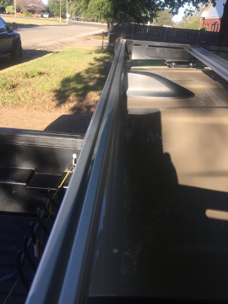

    Small suggestion... the shark fin antenna on the 3rd gen trucks gets in the way of the rear cross bar as I know you already know. You might add a hole to your .DXF file so it can be mounted vertically with out drilling. My thought only... You can tape a quarter to it, throw it in the river and say you lost something.IMG_2775.jpg IMG_2777.jpg
