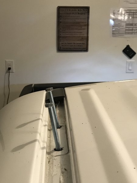

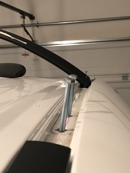

    Has anyone experienced cross threading on their double cabs when going to install? My rear passenger bolts have some serious angle to them when I attempt to screw them in.
    Help!

    Are you referring to mine? If so, I'm going to pick up a tap and die set and try to reset the top few threads.

    Do the bolts not thread all the way in? Or are they just crooked?
    Odd if the threads are fucked they'd both be the same..
    Just those two or...?

    Probably an install error from the factory. (Ask me about my rear diff breather threads... :/)
    Try chasing the threads and see if it's the first few, or see if it'll go easy by hand at that same angle.

    Pretty sure a couple of mine were like that as well.
    Just check to see if it is goes in easy or if you will need to strength to get it in there.

    @LEXICON both. They only go in at an angle but will not thread in fully. This is the case for the two in the picture. The other 8 are perfect.

    All the tape is gone now (unlike in the photo). Still no dice. Headed the tap route now

    Both my driver and passenger side middle hole was too short, had to buy shorter bolts for those.
    Not sure if they were poorly threaded but seemed odd same depth on both sides.
    seems like Toyota has some quality control issues with these.

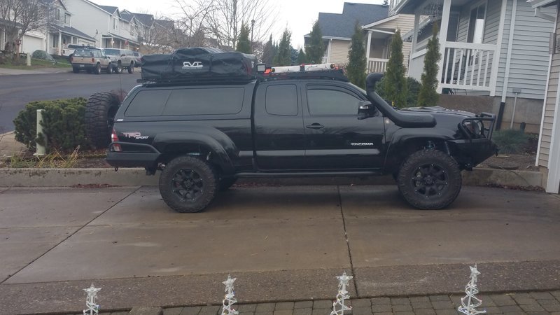

    Little better photo of how far over the tent is mounted with the awning mounts

    Well it's done! Few minutes tapping the threads and were good to go.
    Like yours, my center bolts are too short, guess I'll be making a trip to Home Depot (oh darn :rolleyes:). What length did you buy?
    I suspect this is an issue on the 2016/2016 for all the center bolts, but I could be wrong.
