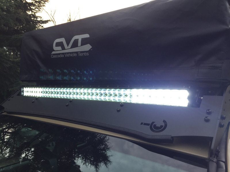

    What light bar mounts did you use? I want mine to sit just like this

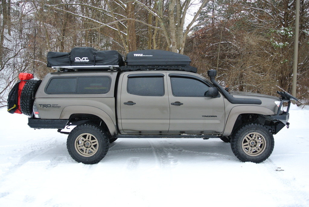

    Click on my Build
    Thule weekender fits perfectly on a Prinsu rackDSC_0247_zps8j5h58wk_b4f4848a510c6f355e775ce7b08ba7c62ed50a4a.jpg

    Heretic Light Bar mount $20. from Prinsu
    Mr. Nobody and AddicTioN[QUOTED] like this.
