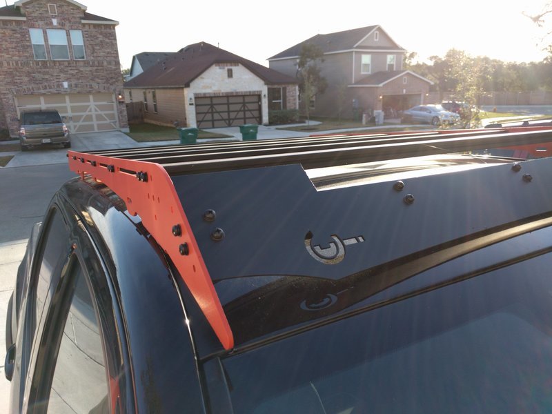

    Yeah, the deflector has a cutout. My reasoning for believing the light bar would help is that it would protect the first crossbar from wind. Just as the fairing without the cutout does.
    I'm very familiar with the door noise. That already bothers me. But it was tolerable. The noise now it's definitely not that.
    I'm not sure what crossbar you're talking about to drop. I noticed your fairing is mounted lower than mine though (I used the two middle holes). Is that what you're referring to? I'd hate to remove the wind deflector altogether as it's one of the reasons I like the rack, but I may just have to try it, along with that cover you linked

    This is how I have mine set up. Have people had better results with different placement?

    Same as mine it's just that first bar after your fairing is catching wind cause of your cutout. If not using slots get those inserts or tape it off with electrical tape. Do you have sunroof? You can watch the bar vibrate heavily. I moved my first bar down, you can see the holes I used in that pic.
    My wind noise is very minimal now, pay no attention.

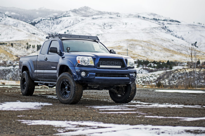

    Access cab Prinsu installed
    can't wait to get the 40" faring and single row 40" bar in!
