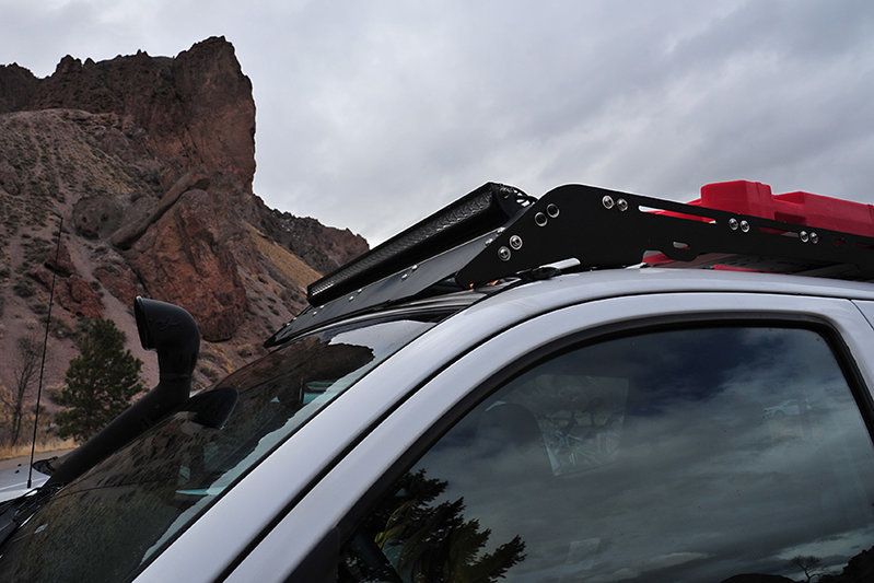

    Yes, I have those slot covers on my bars as well, including rubber strips on the back fins of the light. They eliminate the noise at lower speed, but at over 70mph, it's noticeable. Moving the light bar back would be ideal for better air flow and noise level, but I have the older style side rails without the additional sets of holes on the side. I've been hesitant to drill new holes on them because I don't trust myself to get them on evenly.

    I had issues with wind noise from my light bar. Wind passing over the fins of the light bar created a whistle. I tilted my lightbar to face downward a little (just kept tilting it till the noise stopped. I didn't this while driving on the highway which wasn't smart but it allowed me to feel for the fix) and it prevented wind from hitting those fins and the noise stopped. Now I have essentially zero noise coming from my roof rack.
    Note: I have a sunroof which is how I was able to test the fix
