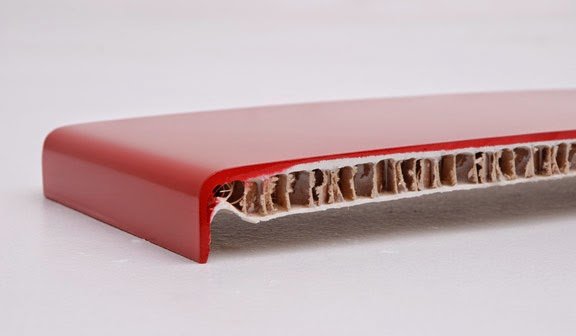

    For what it's worth, on my factory new (2012) A.R.E. MX shell, with Yakima tracks, the tracks were mounted on the NON-Reinforced (NON-honycomb) section of the roof. I load it up 150 lbs. on many off-road camping trips and fiberglass is in perfect condition. No problems. As a side note, I recently had a phone call with A.R.E. regarding the reinforced section of roof. I am thinking of installing a small two-way hingeless vent, and wanted their advice. They described the honeycomb reinforced section of the roof as a paper product like cardboard. They said as long as I can effectively seal out water I should have no problems, conversely, failing to seal out water would result in big problems). Google searching for pics of the reinforced section turned up this picture:
    Snugtop_Half_Inch_Honeycomb_Insulated_Ro_91c7e6985818fe93bfee7e5d67d33626b9856e5e.jpg

    I have a leer as well...I was told not to cut through that area...however because all the manufacturers are different, I would contact the specific brand and ask to be sure....

    Looks right to me. I am sure mine has some issues cause I resealed it after I got it but am almost positive it had water getting in before that.
