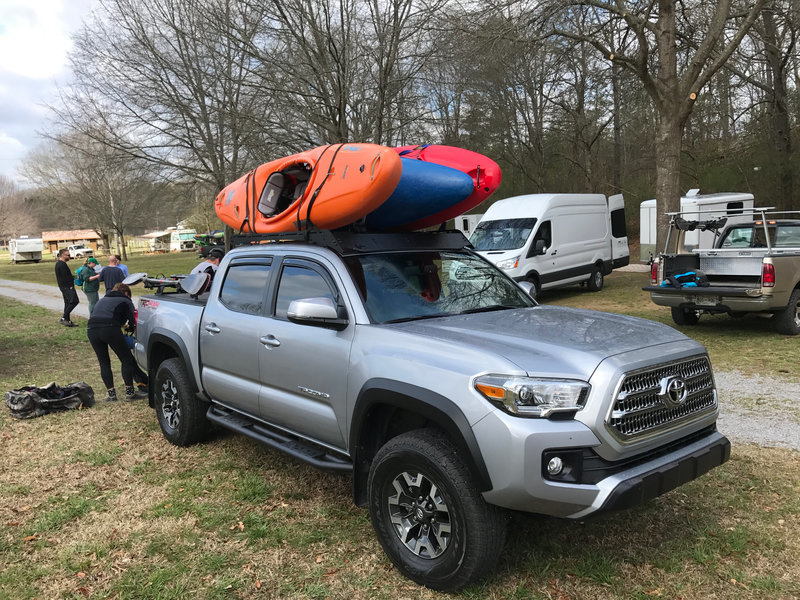

    Interesting - I'm still having a lot of wind noise issues. You mention getting the flaring flush with the first bar, but in my experience if I lower the flaring to the lowest position as suggested, the flaring is actually slightly lower than the first bar position. I've moved the bar back some but the noise is still very loud on the highway @ >65mph speeds. So loud I can't talk on the phone or carry on a conversation in the car without yelling.... May also cover up those holes which does cause some whistling - which I can deal with, just the loud roar that's not going to work for me.

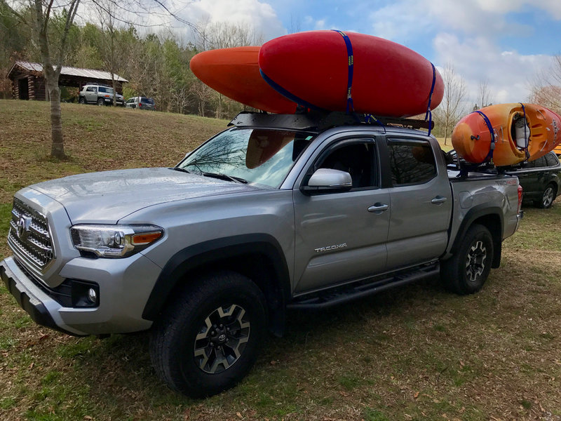

    As for the wind noise, it's a nearly deafening roar above around 65-70. Appears to be primarily coming from the airflow around the sides of the deflector where air can move freely. After numerous tweaks I keep inching closer, but still can't drive normal interstate speeds of ~75mph without having to yell to carry on a conversation and my bluetooth is useless on the highway with the rack. I've actually removed the front cross bar such that the first placement of a bar is where generally folks put their second. I've installed t-slot covers all over and that definitely helped some with the vibrations - though I still get some in the rear of the cab. Also took your advice and used some electrical tape to cover the open holes in the front which has taken care of the whistling. What hardware did you use to cover these permanently?
    It's getting closer... any more tips are welcome.
    As for the kayaks, I use a Thule stacker. Primarily b/c the use of my prinsu is generally to carry a lot of boats when we shuttle on remote whitewater rivers. I can easily stack 4 boats on their side (6 if I want to get creative) with that setup on the cab. For just my boat, I use the Thule Hull-a-port Pro on the ends of my yakima bars that are attached to my Truck Covers USA rack set up to keep the boat behind the cab for long distances. I also use the Thule paddle holders on the ends of the bars (or attached to the side of the prinsu) to keep the paddles out of the bed.

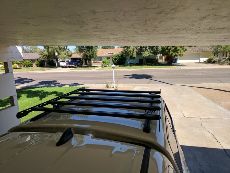

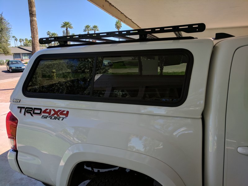

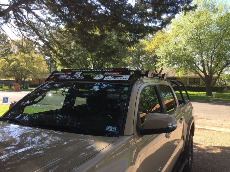

    Got my toprac in the mail yesterday, put together and installed today. Well worth the wait!
