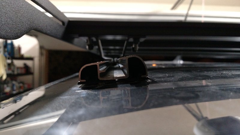

    Definitely taller. I tried taking a more straight on shot this time. I also searched online and I can't seem to get a specific answer if the tracks are left / right specific. I've never heard of anyone having issues with the rack sitting flat on the tracks. In my current configuration I wouldn't trust attaching it to the shell. I'll be heading back to the installer tomorrow morning to hopefully get an answer. I've run into a spat of companies recently that can't seem to get things right... my shell is just another one to add to the list.

    I can see it now. I would think the taller side should have been on the outside to offset the slope. If it is wrong I hope they make it right.

    Hey I had the same issue! I will post some pictures of what I did in the morning when it's light out. Short story long, you have to shim the outside bolt where the foot attaches to the rack. If you install everything as is and tighten everything down, you will pull the tracks up off the shell. @zscott confirmed what I did will work.

    @mightiestmouse I suck at internetting. Look at post #4575 to see what I did.

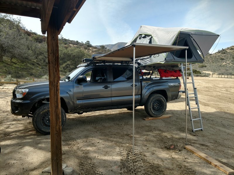

    What did you actually use to shim the footings? It doesn't look like the shim has any angle to it from your pictures.

    Looks like you could use a bevel washer to fix it

    I just stacked extra washers from the kit.

    Went back and looked at your pictures. I can faintly see the washers stacked under the shim plate and footing from the rack. Unfortunately I do not have any of those same shim plates that came with my rack, and I would prefer not have washers between the mounting surface if I can help it (will be sleeping on top of the shell). I spoke with the leer dealer where my shell was installed and he took photos to send to Leer for clarification. I would flip the tracks myself, but the factory stripped all of the threads on the Philips screws for the tracks making it impossible to get them out without drilling the centers. Hopefully have an idea on how to proceed Monday. What a pain in my ass this is.

    Interesting. I totally missed the part where your tracks were switched. My tracks are the same height left to right which is why I had to shim. Yours look like a pretty good solution if they are installed the right way!
