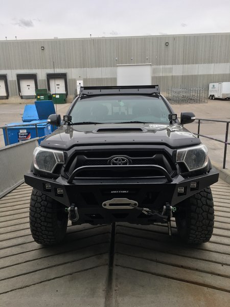

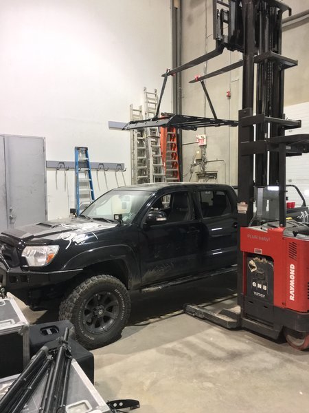

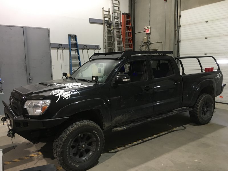

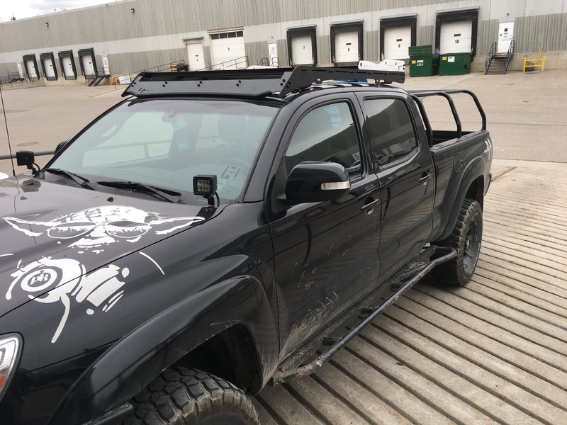

    Well after 4 weeks of delays before shipping and another 2 weeks of being busy I finally got to installing my Prinsu Roof Rack.
    That was a freaking bitch to do. I was working on my own so I had to be creative to get the rack up top without a second set of hands.
    The rack itself went together very easily and installed without much of a problem.
    Here is where the real issues were. I also ordered the Cargo Basket Kit. First the cross member supplied with the kit is the same width as those for the rack. At first this doesn't seem like a problem until one goes to mount the kit and the "Basket" sides interfere with the rack sides. Then as you are tightening the supplied fasteners the carriage bolt decides to spin in the T-Slot as soon as the nylon section of the nut engages. This happened twice on the same crossbar. I spent an hour having to cut the nuts off on get the fasteners out. Now that I have this botched piece of T-Slot I was able to fix the initial problem of the Basket Kit being too wide. I switched the crossbar from the Kit with the botched section from the rack and cut the messed up end off. Now the Basket Kit fits between the sides.
    After driving around a bit I haven't noticed any issues with wind noise. I can hear it a bit but my tires louder. Now we'll have to see how it holds up over time.
