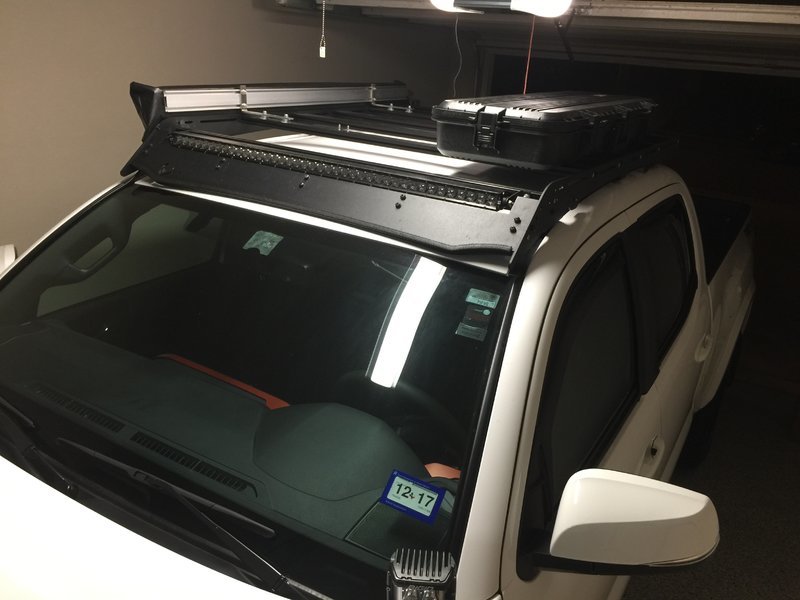

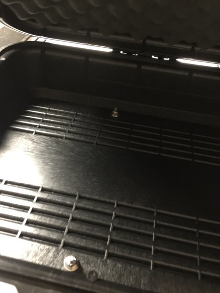

    I used 1" 1/4-20 carriage bolts, washers, and rubber washers. It was bolt, washer, rubber washer, Plano box, rubber washer, washer, then nylock. I measured and drilled the holes and bam. All good.

    Looks great! Thank you for the info.

    2" square u bolts from the hardware store. Solid, solid option
