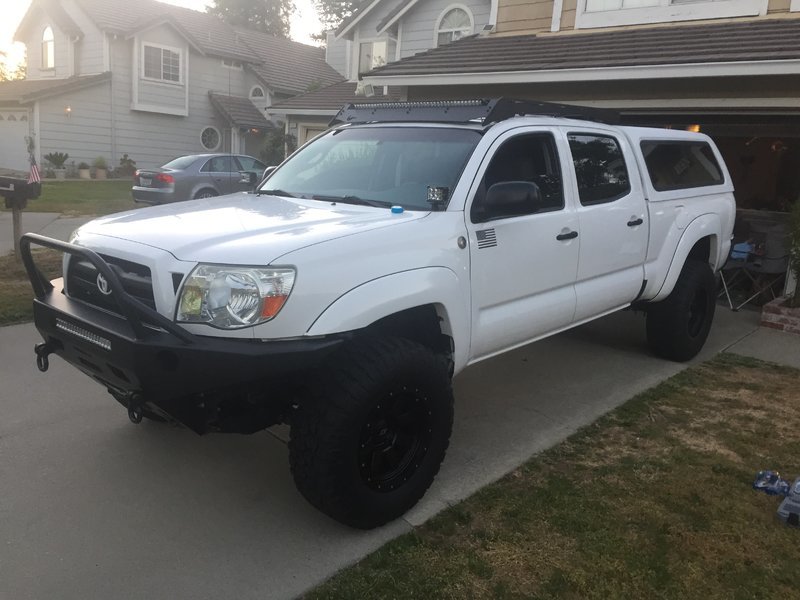

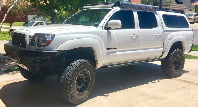

    Toprac is all mounted up! Only question I have is does anyone else's not line up with their cabrac? My toprac sits a little lower than my cabrac..

    Saw your picture and thought it was mine! Minus the hoop on the bumper lol looks great!

    Doesn't match up how? Not the same hiegth?

    Some shells are different heights that others. The rack was probably designed off of a taller shell. See which spacers the guy who posted early about mounting a rack to his KB Voodoo rack used and just throw some of those on.

    Ya, sits maybe a 1/4" to 1/8" shorter than the cabrac. Only asking cause I was thinking of getting a longer awning.

    The spacers I used for the voodoo rack (2x4s.. until the custom order aluminium ones come in) are probably overkill for the his shell. Shimming the shell should be really easy though. Just some decent quality washers should be enough to pick it up a bit.
    Looking at your picture, I can't see too much of a difference. I bet it wouldn't be that hard to add a small spacer. You can order some aluminium ones to go above the mounts and under the rack, or just some washers under the mount. Either should work fairly well.

    Are you planning on securing the awning to both the toprac and cabrac? IF so that is a very bad idea, especially if you off road. Tacomas are designed to flex and not have a rigid frame like most other trucks. it will bend/warp the awning if it is attached to both racks.
