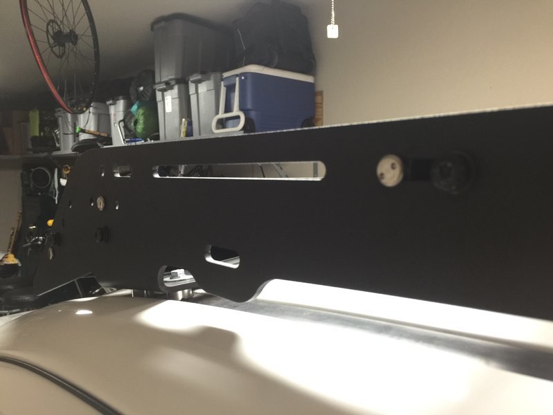

    That's what I used in place of 1 of the 2 screws per side per bar. Specifically the
    Spanner Rounded Head Screws in 1/4-20 @ 1" in length

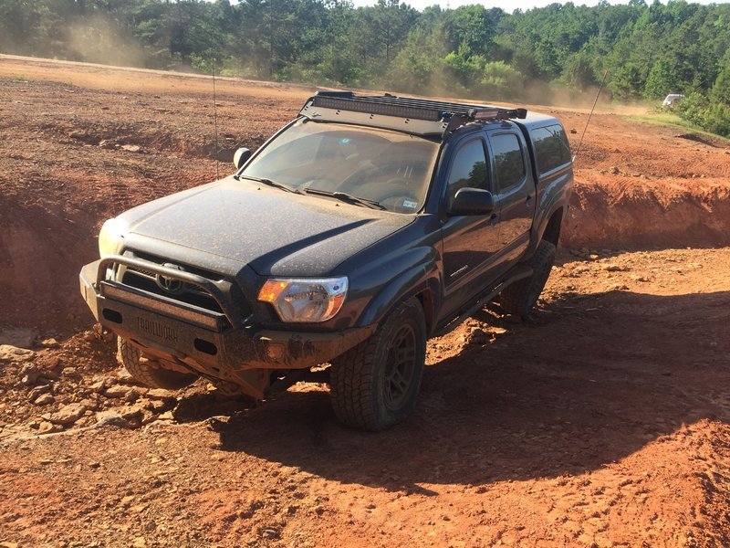

    Everything is down the driver's side A-pillar.
    You can kinda see it here.

    Ok that's how my light bar is run, but I don't think I can run another wire. Might have to use the other pillar.

    My wires are inside 3/8" flexible conduit.
    If you're just doing a couple, 1/4" would probably be fine you you.

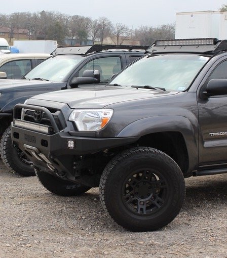

    What bumper is that? Never seen it before.

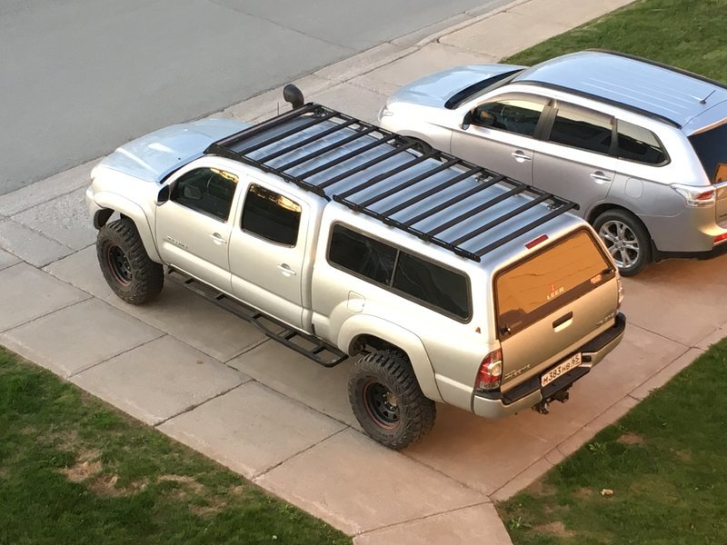

    Finally installed with reinforced back cab! DCLB

    honestly, it isn't easy to remove due to the tight space to work with (nuts are under the rack cross-members). The Prinsu looks good, but isn't the easiest roof rack to work with.

    TrailWorx. It's made by a guy local to me.

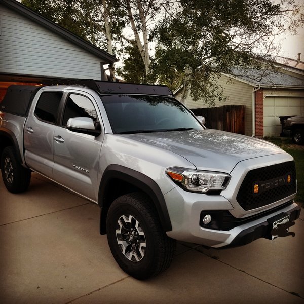

    Thanks for the advice all. After taking the bolt out and peeling away the silicon I actually found that the punch in the sheet metal above the threads was interfering with a straight alignment of the bolt. After cleaning that up with a file I cleaned the treads with a tap just to be safe and it went in no problem!
    As far as the weather stripping I've decided to just run as is and replace when i find a cheaper set.
    Really appreciate the feedback! I think it turned out great.
