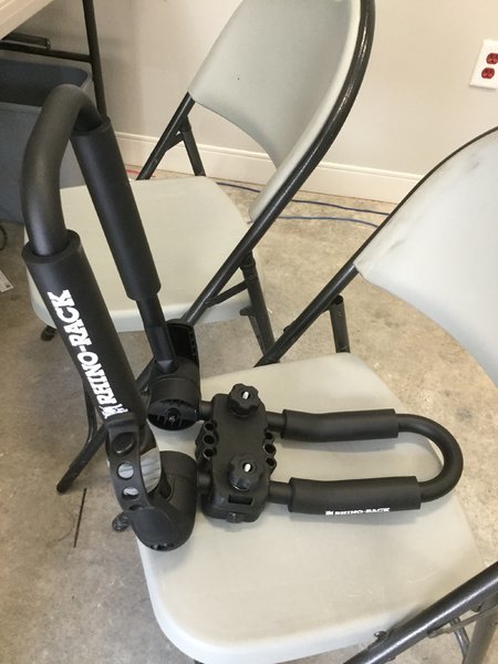

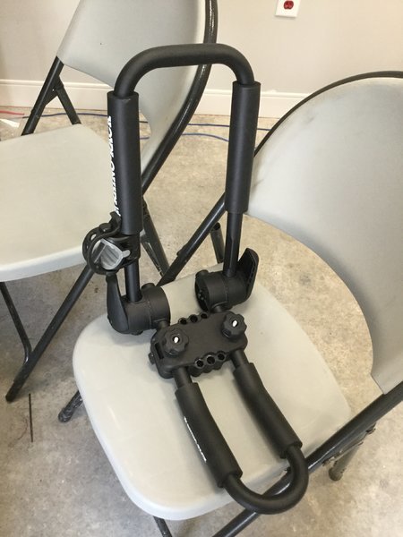

    Finally got my rhino J carrier all prepped and ready to go! S/O to @Blackout14 for the idea and @Bootleg_Flyer for the help!
    Now just got to get my prinsu on my truck lol... it's been sitting in my apt for couple months.

    Damn! Those thighmaster machines have gotten really beefy.

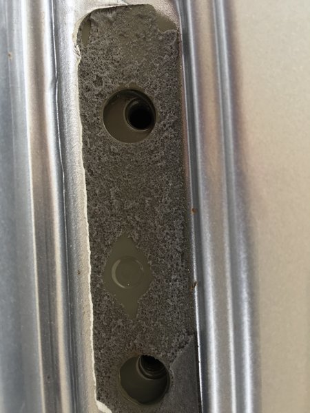

    Looks like my factory roof bolt holes aren't aligned. Im guessing this isn't normal?

    Time for another 3rd Gen Recall!!

    Some of mine weren't perfectly aligned either

    A few of mine looked like that as well. Didn't turn out to be an issue.

    Common problem due to workmanship errors at the factory. I had the same issue. Dealer retapped mine under warranty.

    How long did it take them to service it?

    About an hour since I showed up without an appointment. With an appointment, it should be really fast. They just have to drill out that overlap piece and then retap the hole to ensure the threads are in good shape
