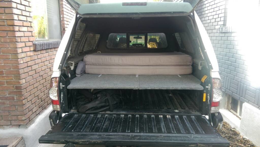

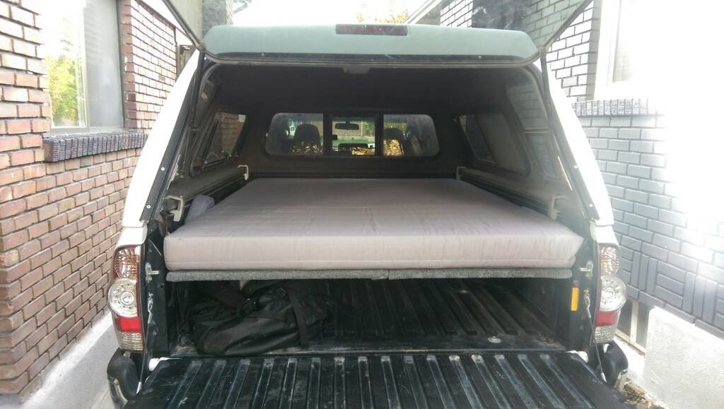

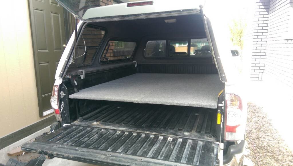

    Question for ya, two actually.
    What did you use for a platform?
    What are you using for a mattress? (Lack of better wording at midnight)
    That looks super clean!! *quoting for later use
    sawjai526 likes this.
  2. Jun 25, 2017 at 9:44 PM
    #6942
    jtrue
    jtrue Well-Known Member
    Jun 2, 2016
    #188593
    170
    SLC, UT
    2014 Super White Tacoma TRD
    I used 3/4 ply, cut in half then carpeted, jigsaw to get the cuts right by the tailgate. 2 x 6's to support the plywood in the bedside slots. Recently added some turnbuckles to attach the rear portion of ply down to the metal loops in the truck bed using nutserts in the ply. I have metal loops towards the back that I can attach straps to and tie down a pelican case, cooler, and water jug. Mattress is from Ikea, http://www.ikea.com/us/en/catalog/products/30102064/ fit's perfectly.

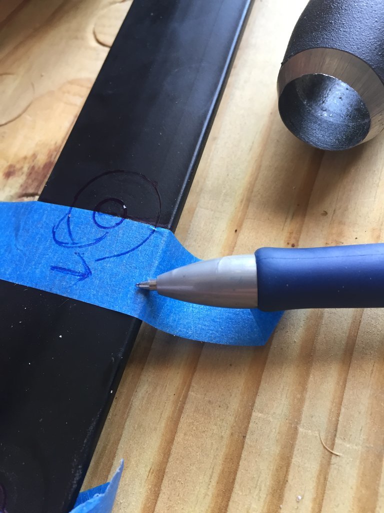

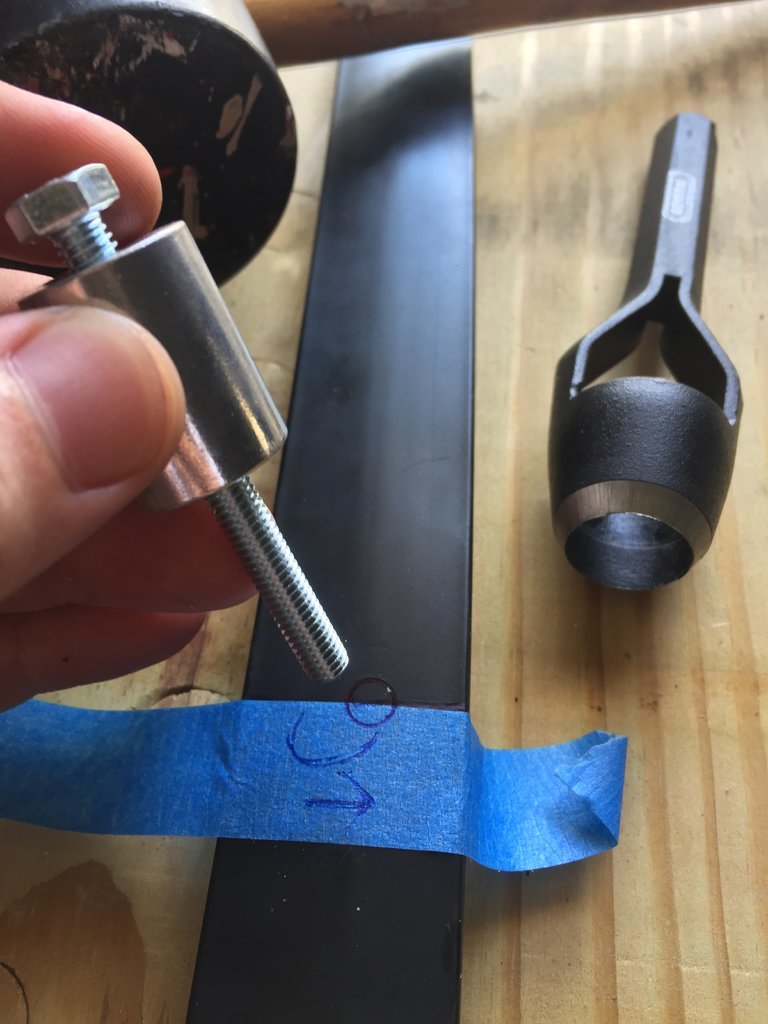

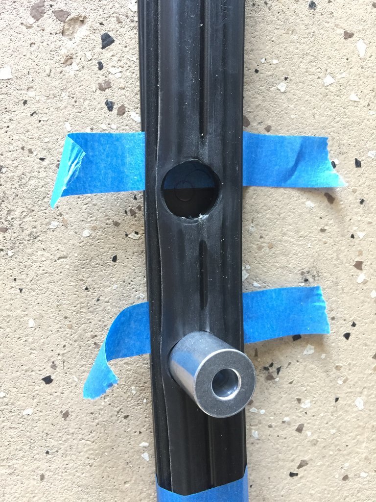

    Nice write-up. Would you say a punch is the best way to make the holes? I was going to use a drill press but have concerns it may catch the strip and twist or tear it.
  4. Jun 26, 2017 at 7:40 AM
    #6944
    HackD
    HackD Marching to the Beat of a Different Drum
    Feb 24, 2011
    #51783
    1,053
    William
    Hamilton, Ontario, Canada, eh?
    2010 Base 4x2, 2.7L, 5 speed manual 5-lug Slug
    Gone over the Top for a 5-lug..
    Punch is the way to go .. pilot-hole/hole-saw, and a drill press were a total fail for me, on the very first hole. Ripped the strip right out of the clamp, and twisted her up...

    Yep, punch.

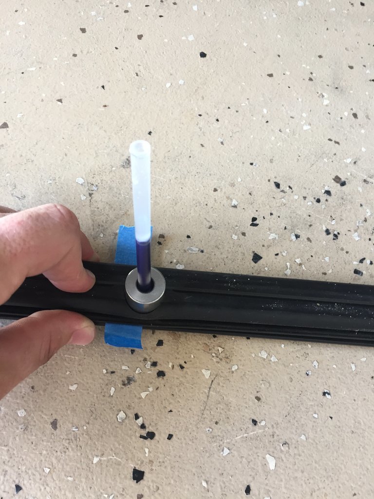

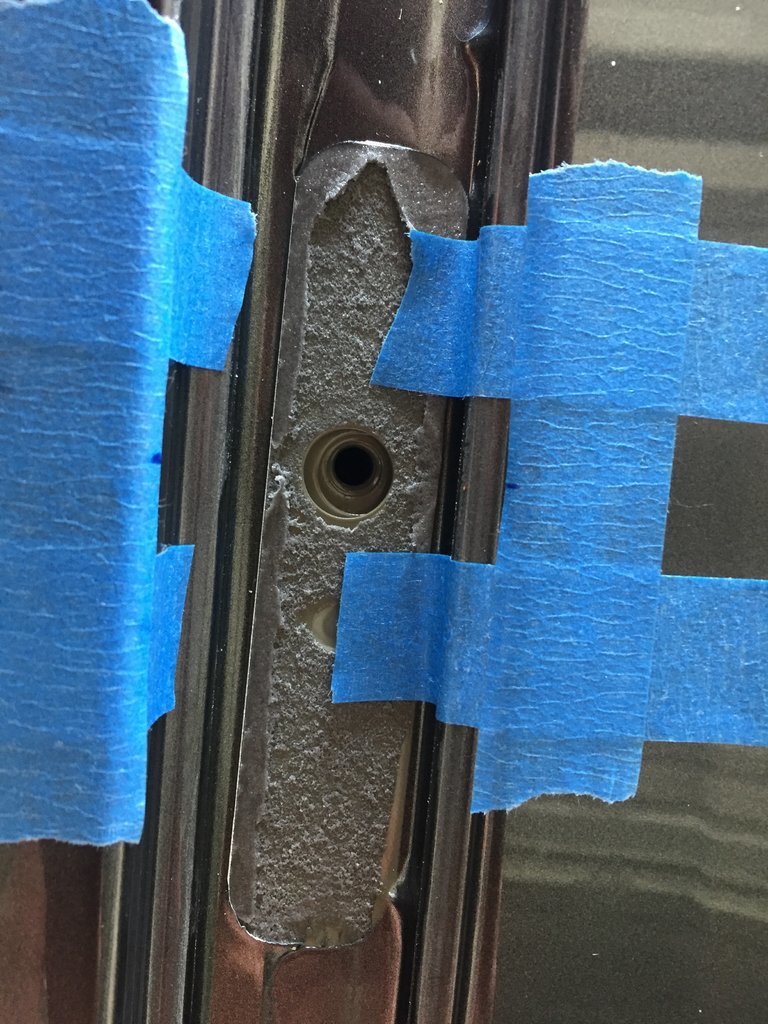

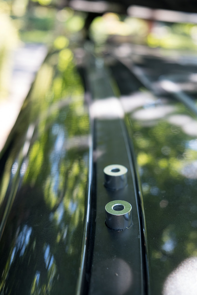

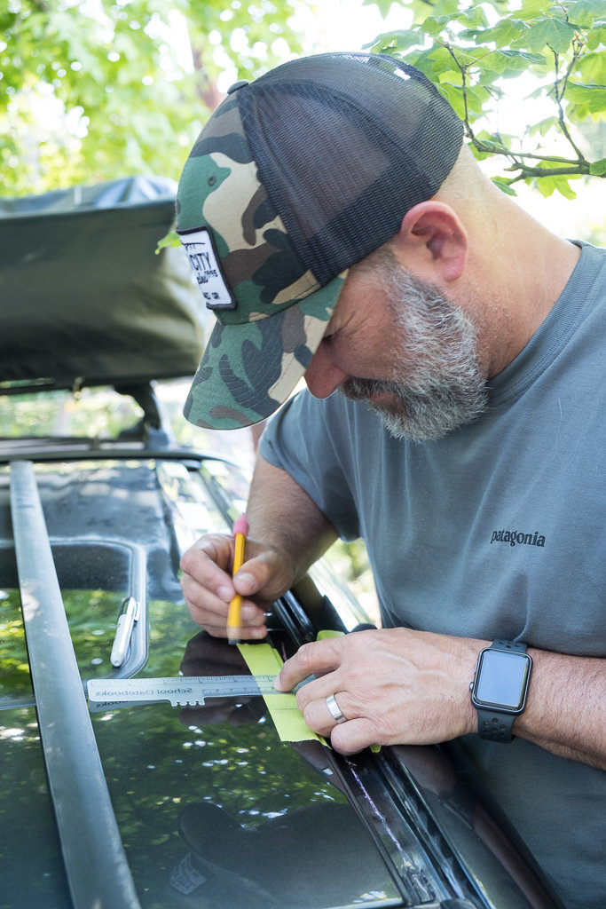

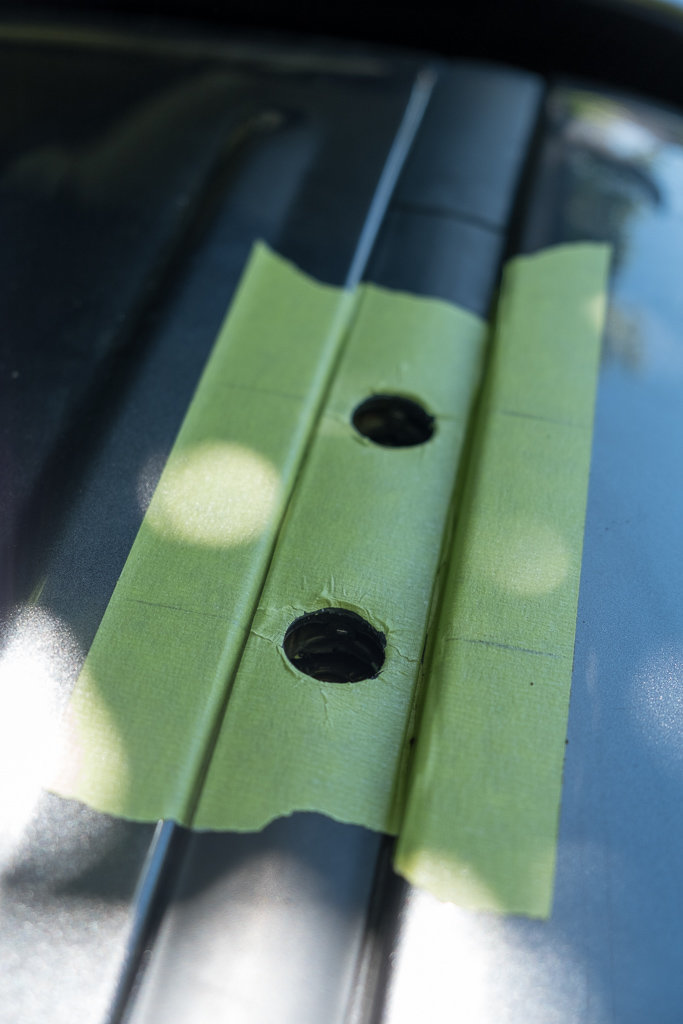

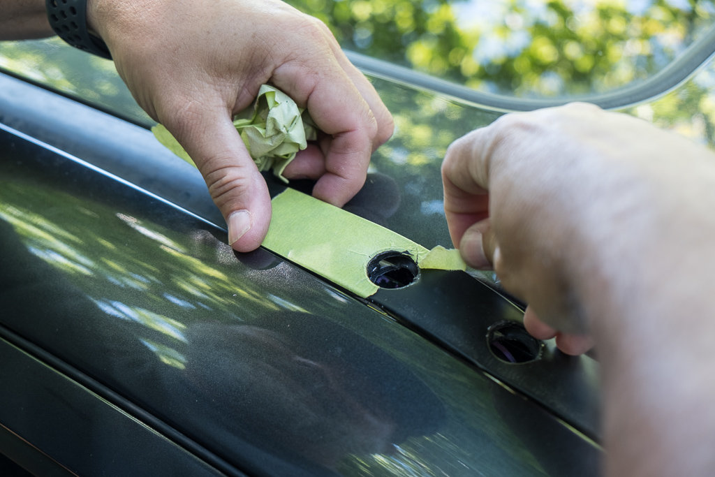

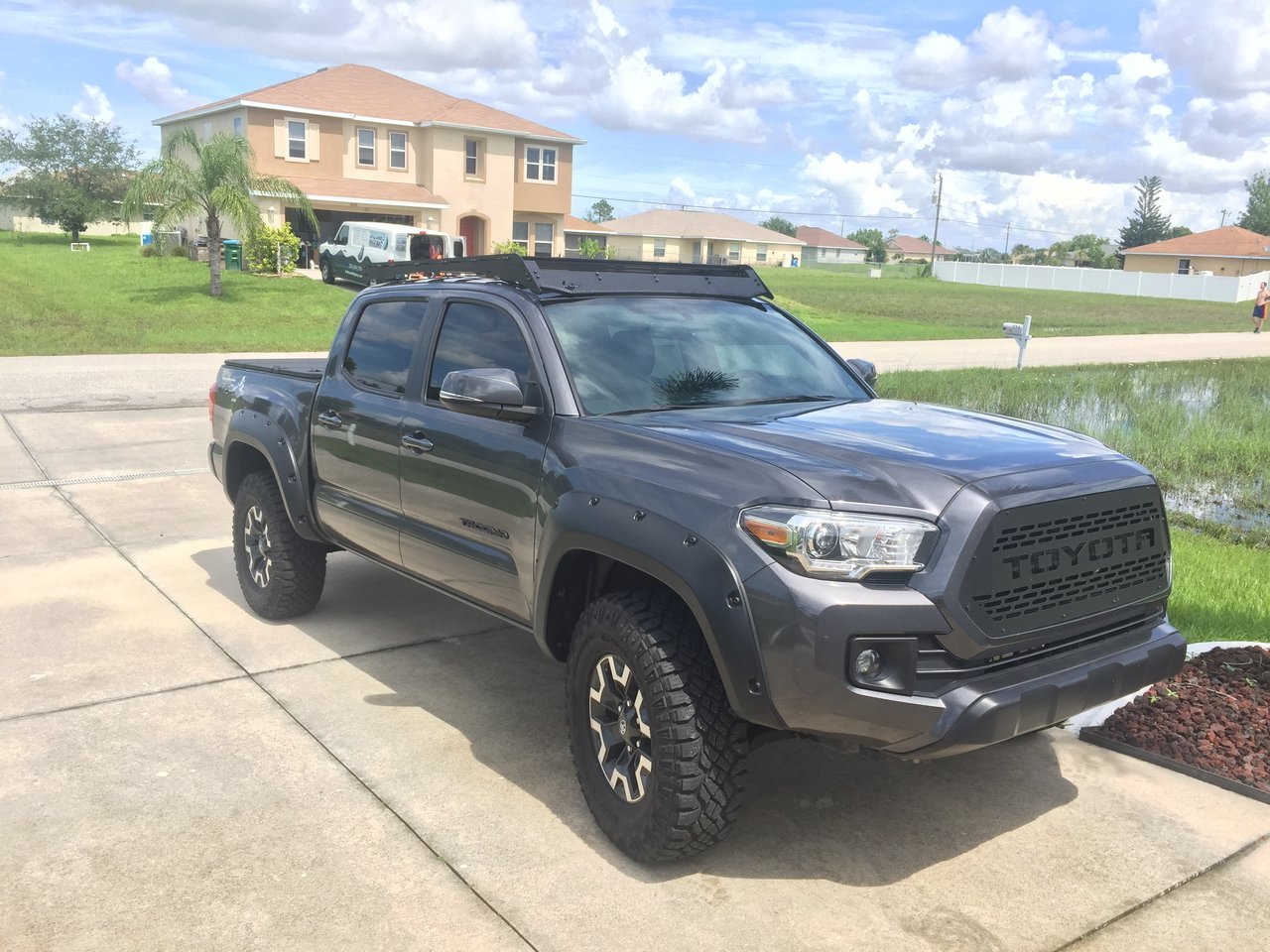

    installed mine yesterday:
    except i didn't use the speedbore, u used the punch and it was super easy.
    rail inserts
    used first side to make hole measurements for the second side

    Thanks for those pictures RBfastback. Are other people finding that the locations of the bolt holes in the roof of the double cabs are teh same on both sides? How confident would people be using one drilled weather strip to mark and drill the other?
    Also, it looks like some build the complete rack first before install, but PDX_cray looks like he helped with installing the side rails first on teh truck, then the crossmembers (or did you only have a couple on there?). Any reason to do one over the other?

    I put the side rails on first than added the bars. I have done it both ways. Both work just fine. If you are alone mount the sides first, do not tighten the cross bars all the way at first. Do a final tighten at the end...
    Have fun!

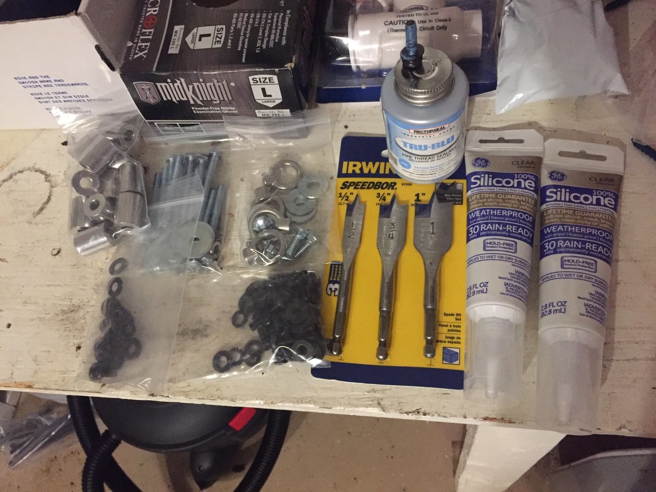

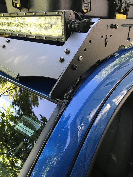

    Did you use any sort of adhesive to keep the wires tucked in next to your windshield? I cant seem to get mine to stay in the channel. Used 3M outdoor double-sided tape with no luck.
  15. Jun 26, 2017 at 12:37 PM
    #6955
    Bannerman
    Bannerman Tasteful Thickness
    Oct 16, 2015
    #166789
    7,474
    Johnson
    Charlotte, NC
    22 Tremor 402A, 22 T4R ORP
    I've heard black silicon works but have yet to try it myself. I think thats what @ajohnson did
    Jack0928[QUOTED] likes this.

    I have seen that, I just don't like the idea of the mess after, but I suppose that once silicone is dried out its not too hard to remove.

    yeah I plan to try it, keep it as clean as possible then clean it up with a razor as needed. I think using a small nozzle will be key and maybe having a plastic tool of some sort ready to smooth out the bead and push into cracks?
