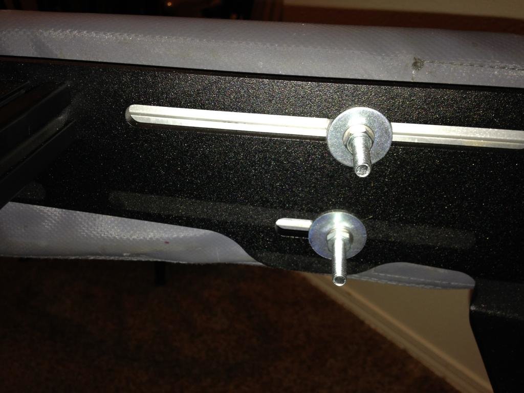

    If anyone is wondering what the small slots on the bottom side of the rails are. This is the intent:
    You can see here I have used 1/2" nylon spacers to keep the awning off the rail itself and to clear the screw heads.
    The perfect amount of clearance.
    The bolts that the arb awning uses are m6. I lost my stock ones so I just used some of the same bolts used to mount my racks to the tacoma. They are longer than needed but all I had at the time. A couple fender washers and lock washers hold it on nice and secure.
