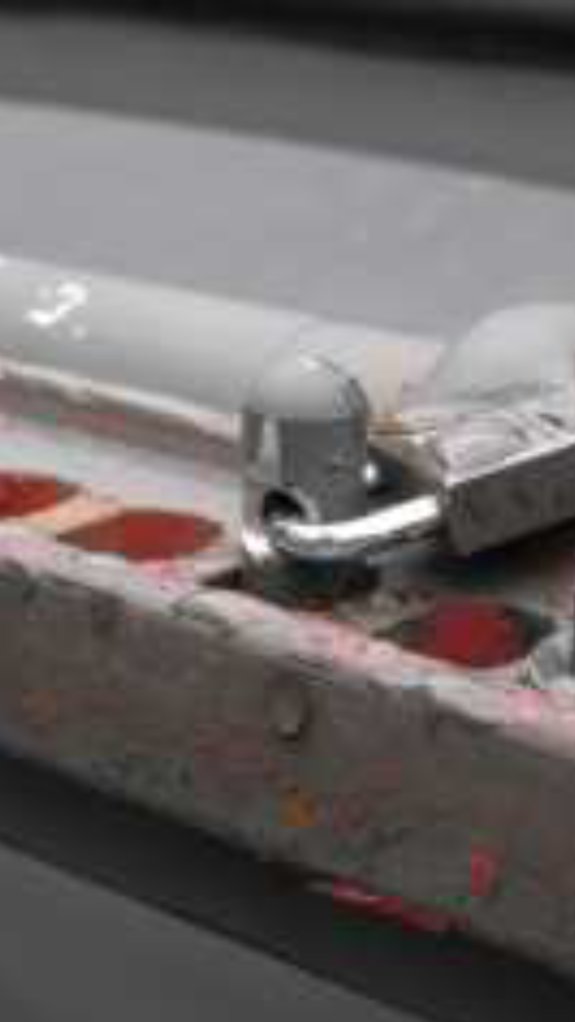

    Those knob locks break easily. They'll break in the locked position and youre SOL. I would recommend finding a bolt with a hole cross drilled through it so you can lock it with a padlock just the ATO mounts have.

    I feel like it would be tricky to find a 1/4th or 3/8th bolt with a cross drilled hole that would fit a lock

    Could call up one of these manufactures that give the option for it in their kit and ask if they would sell you the bolts. Even could take one of the bolts you have and find a local machine shop that would cross drill you a 1/4" hole about 1/2" down the threads so you could use a 3/16" lock.

    This is why I use hood pins like I mentioned earlier to mount mine.IMG_3553.jpg

    Drill 1/2" hole through your bars and tighten the jam nuts on either side.
    Tack weld or stake the threads on the bottom jam nut.
    Jack0928[QUOTED] likes this.

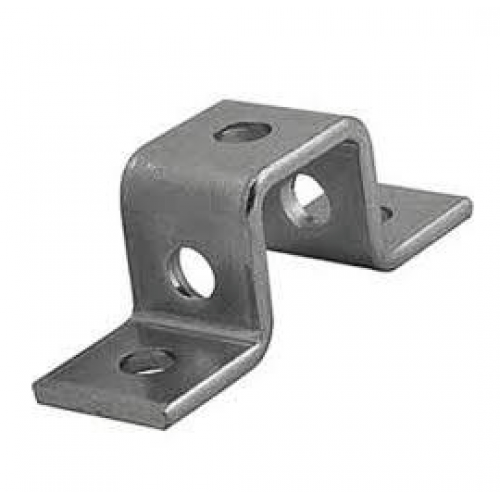

    Im envisioning something like this, were you thinking of something along these lines?
    And just put the pin in the top hole?

    Oh got it, that would work. I thought you were trying to contain each mounting point to one crossbar. I will have to see what my local homedepot can muster up

    On a that case some 3/8"x 2" aluminum flat bar would work well for you. Cut 2 pieces to span your bars. Drill four 1/4" holes in each end and a 1/2" hole in the center.
