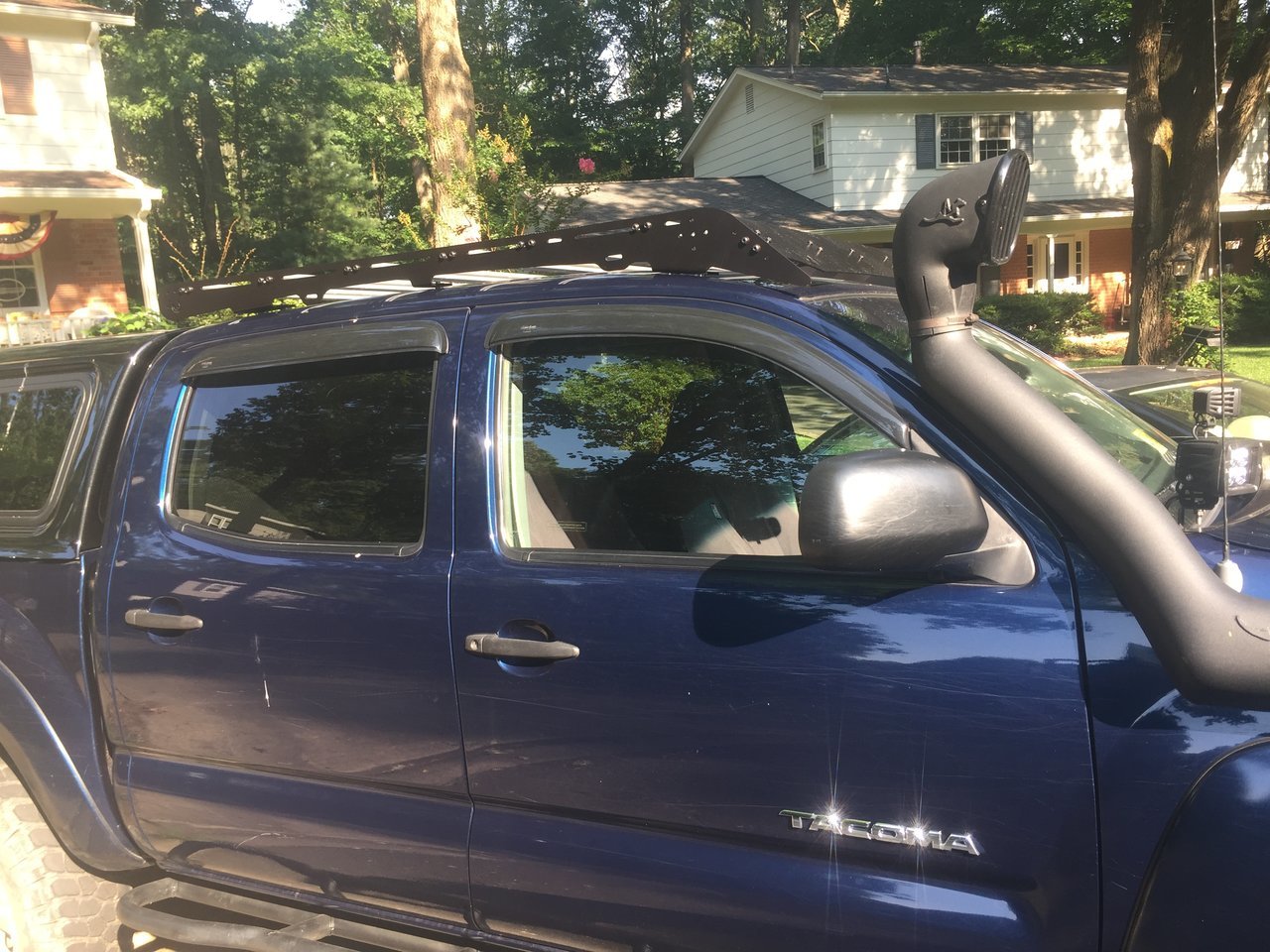

    Any particular reason you put the wind fairing in the middle setting instead of the lowest setting?

    Nope, it's going down to the lowest

    I built the rack before I installed and I wanted some wiggle room during install. I'm gonna move it down to the lowest setting

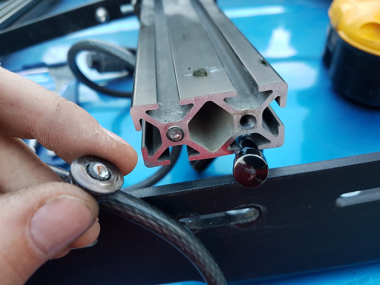

    Anybody else have this issue? Bolt snapped off in the cross bar. Tried to use an ez out, but no good. Tried to drill and re tap, but also no good with the aluminum & steel making the bit go weird.
    I tried emailing Zach, but no response. Only had the rack for a few months.

    its a bitch, but yes, you need to drill it out and retap. also, make sure you use lots of antiseize. with this style of rack you need to use it on all hardware that gets screwed into the alu.

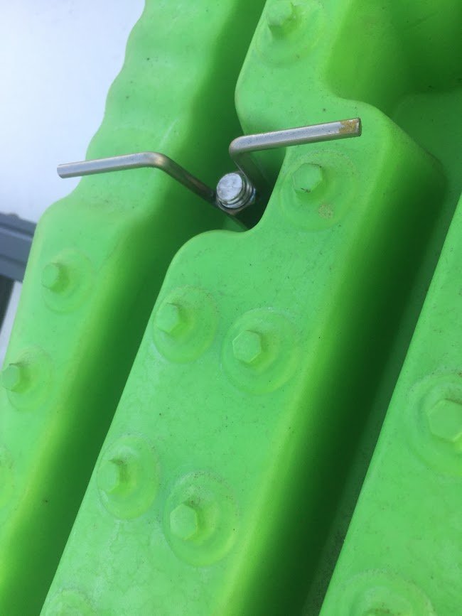

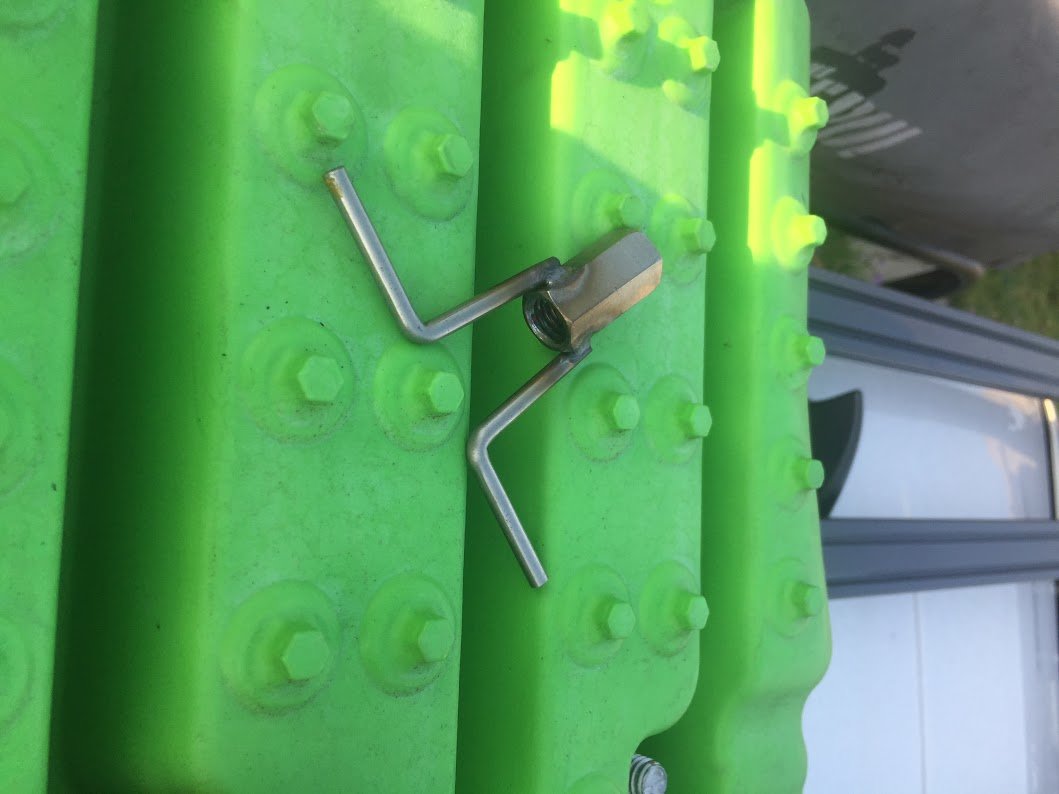

    upgraded my TRED hold downs to make them toolless. now i can just spin them on by hand and get them tight.

    You need to file the broken bolt flat. Then drill. Otherwise, the drill bit will just wander
