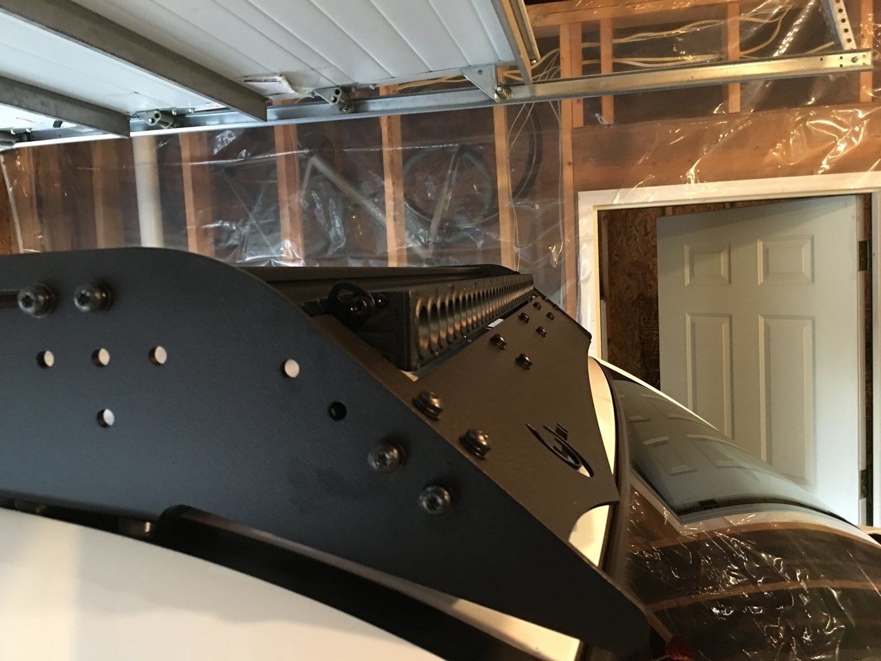

    this is a long dense thread full of a lot of awesome. I have a question for y'all, for anyone running a single row led bar in the cutout on their prinsu rack, what is the glare in the windshield and off of the hood like? i have a white 3rd gen and think a rooftop bar would be awesome in conjunction with a grill light but I'm worried about the practicality. am i going to be blinded? would certain optics help reduce this? what is your experience?

    I have a single row (Morimoto xTorch 40"), glare is pretty minimal but I think it really varies on how you set it up. The mounts I use house it behind the faring about an inch and a half and for the most part that cuts out the downward light from the bar. There is still some light that hits the hood but nothing bad at all

    I would agree. I have a Rigid SR-40 single row 40" light bar and it sits a little behind the faring and even with it from the bottom of the light. The type of light you choose will have an effect as well as the placement in comparison to the faring. My light is spot in the middle and flood on the sides. If you got flood in the middle, you would probably get a lot more light hitting the hood and reflecting back.

    I agree with these guys, even on a white truck the glare is not too bad with a single row as long as it is mounted behind the fairing.
