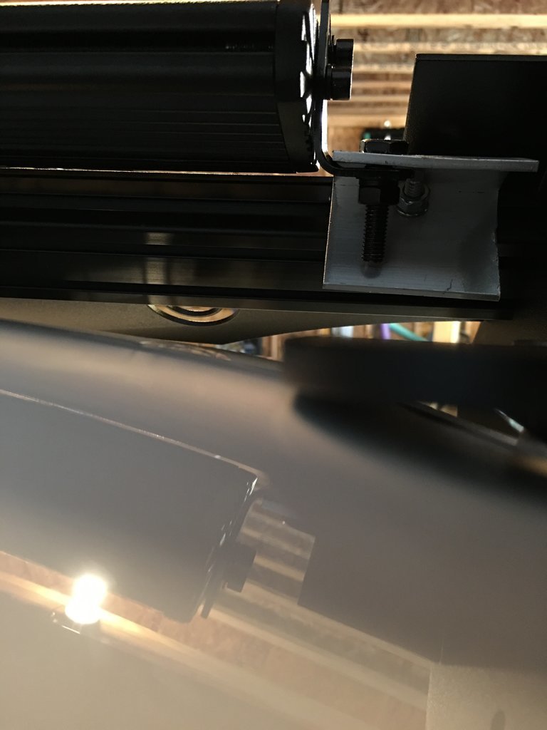

    I've heard that some were able to use the mounts that came with it but I was too dumb I guess. I had to fab my own out of Aluminum L channel.

    I tried it every which way and could not make it work, had to DIY.

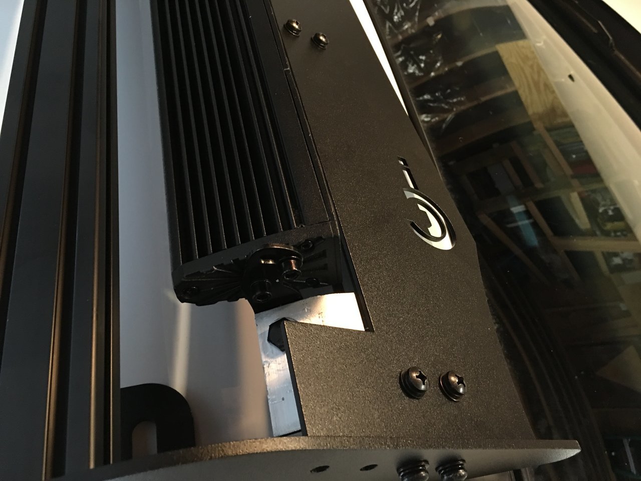

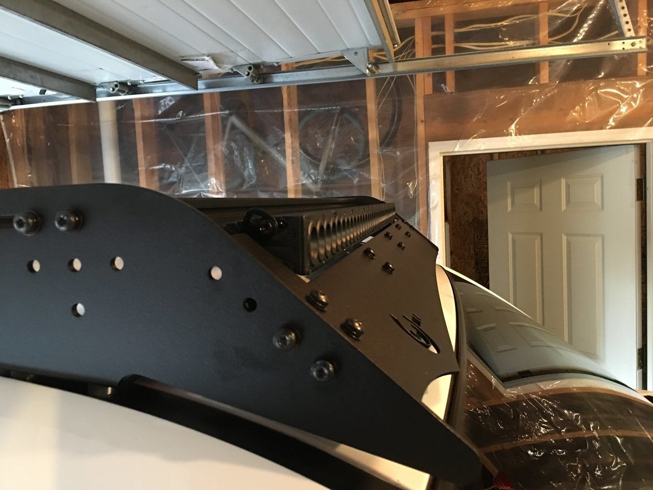

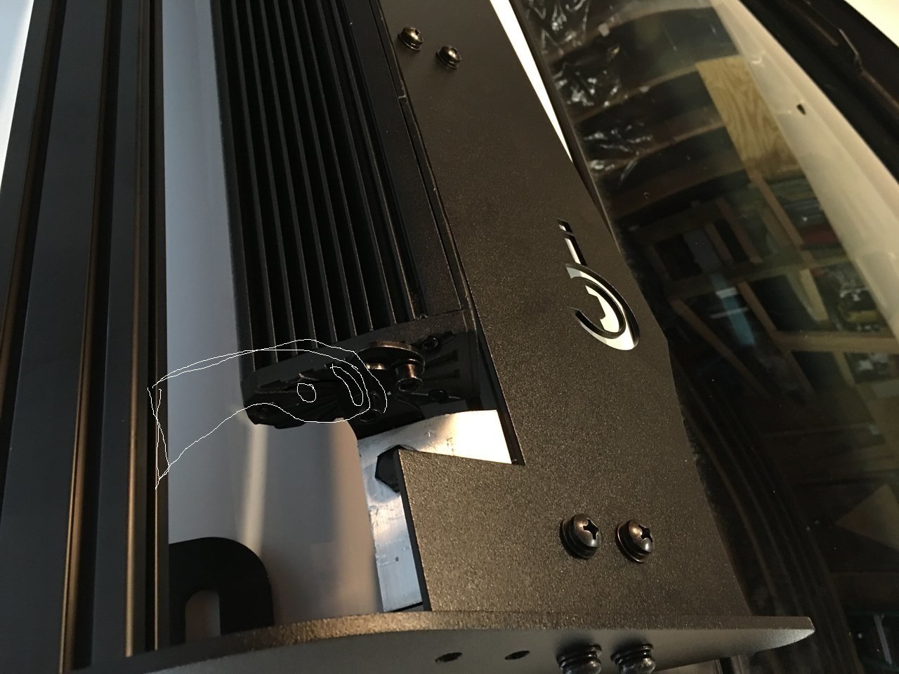

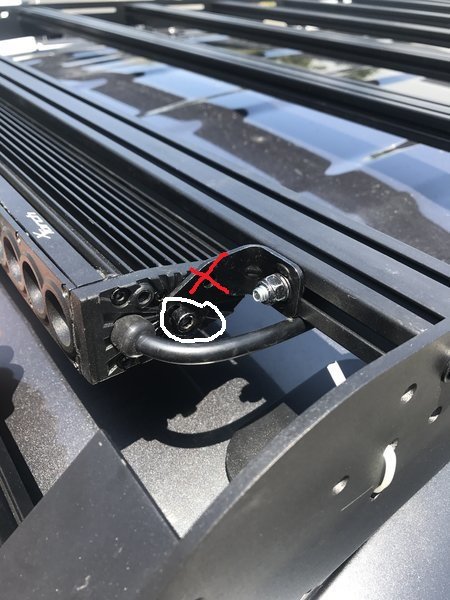

    Excuse the paint art. This is what me and a few other people with the xTorch did to mount, mount it to the first crossbar rather then underneath the wind faring. What you did works :thumbsup:, but isn't entirely necessary.
    EDIT: Just realized the paint drawing wasn't entirely necessary, found a better picture on my build thread here showing it mounted up

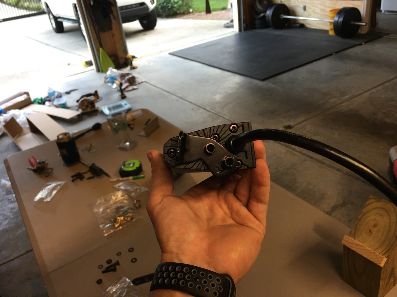

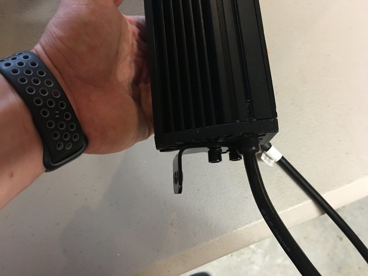

    Paint art is awesome, haha. That's what I had expected to be able to do but my brackets were too short. They do not extent past the back of the light. I thought I may have been shipped the wrong brackets but when I asked Retrofit Source they said they are all the same. Mine are probably an inch long.....

    Mine are short aswell, go check out the picture and see if its the same as yours. It would be weird if they sent you a tiny mounting bracket :notsure:

    Here are better pictures of how short my brackets are.

    Ah I see the problem. So the mounting option we opted with doesn't utilize the middle hole on the mounting bracket only the top hole/slider slot. When you do that it will provide with enough clearance. Here is a picture...

    I see! In my sweaty frustration I had considered that option but didnt know if it would be stable enough, especially being rattled off-road. Any issues?

    I have had it this way for 2 months with two off road trips under its belt and it is solid as a rock. I cant even shake it out of position. I didn't use locktite but that would be another way to make sure it wouldn't budge.
