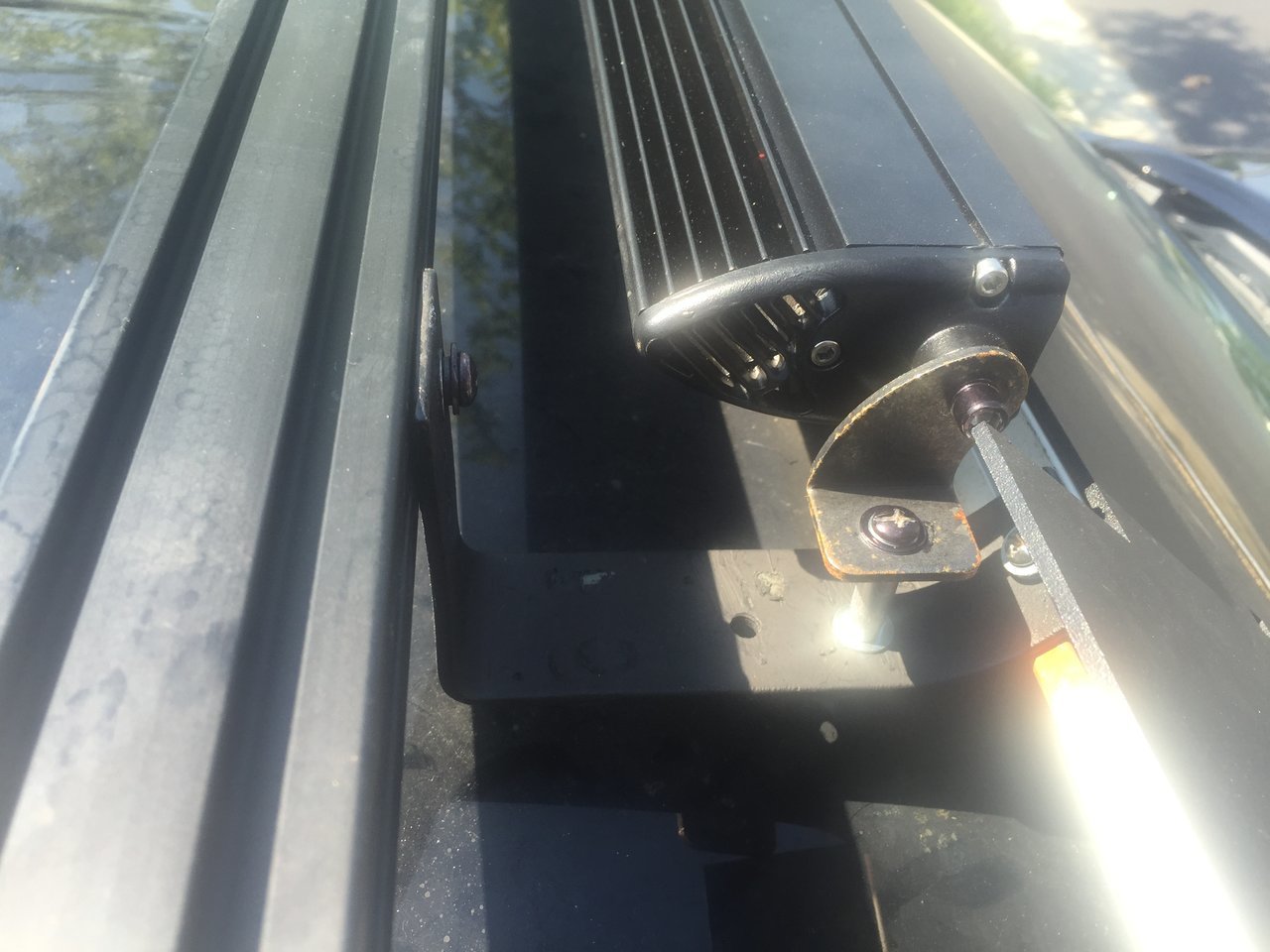

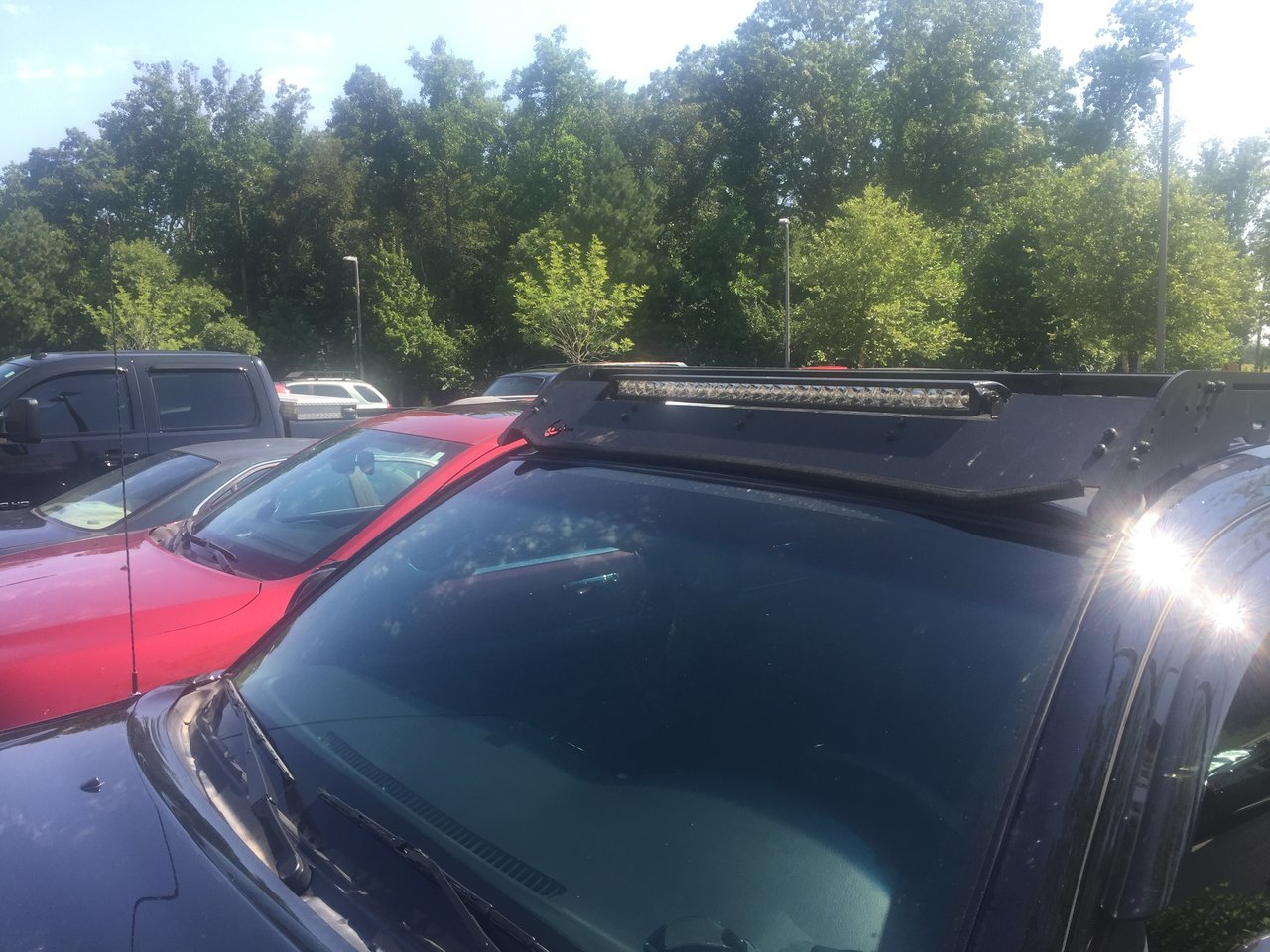

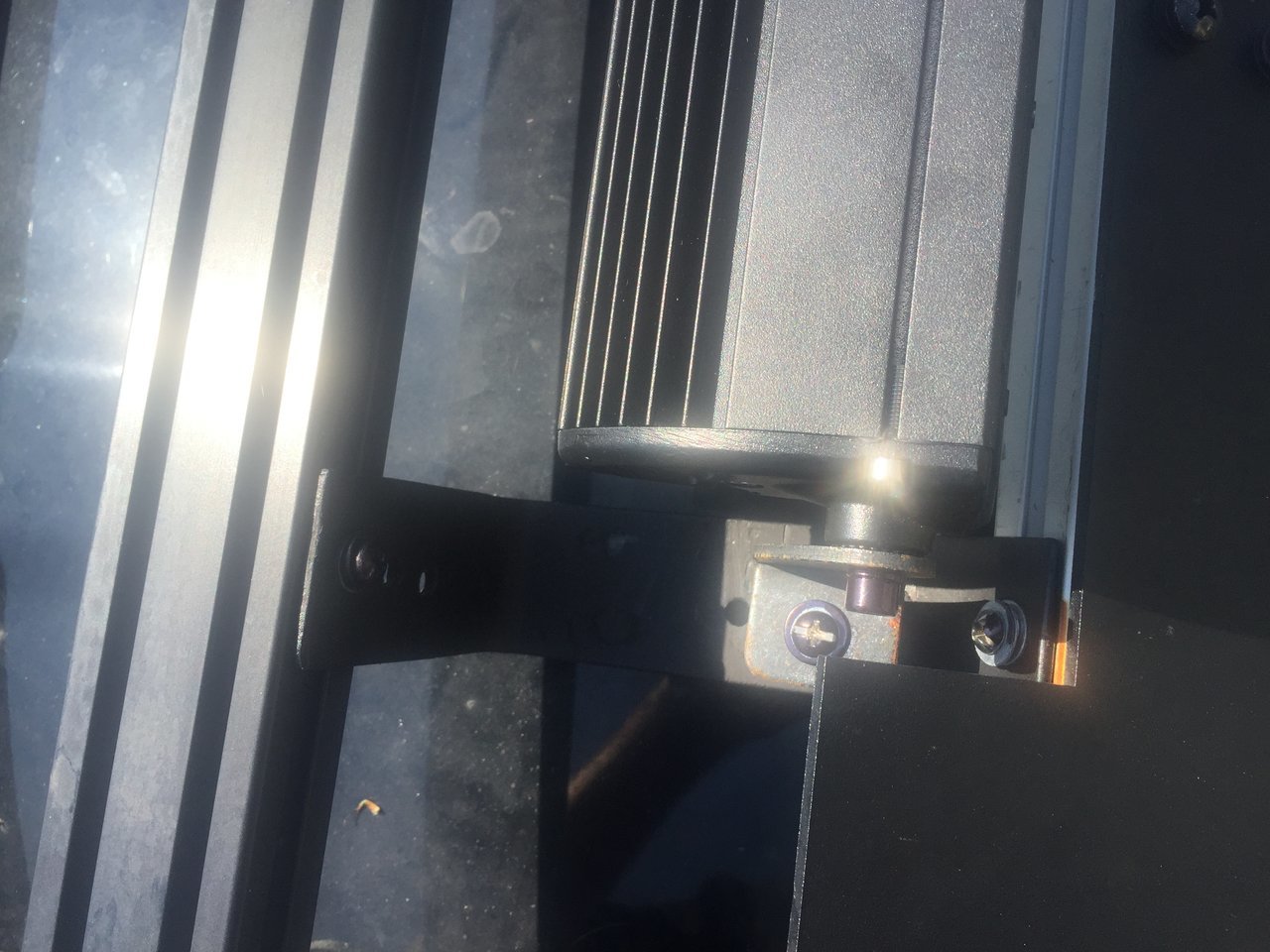

    My custom brackets- had a dual row bar 2 days ago, just replaced with this single row.

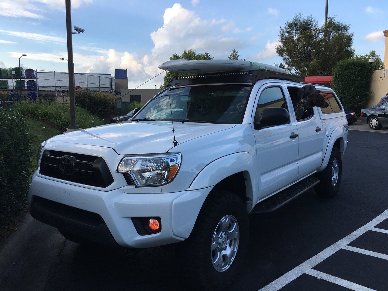

    I didnt trust those eyebolt to carry my SUPB, would not trust them for a canoe either. I just hook the straps to the side rails.

    What runners or sliders are those?? Thanks!

    They are SOS concepts bolt on, but I had them add fill plates and set them at Zero degrees to access the rack easier and so the dogs and wife could use them as steps.
