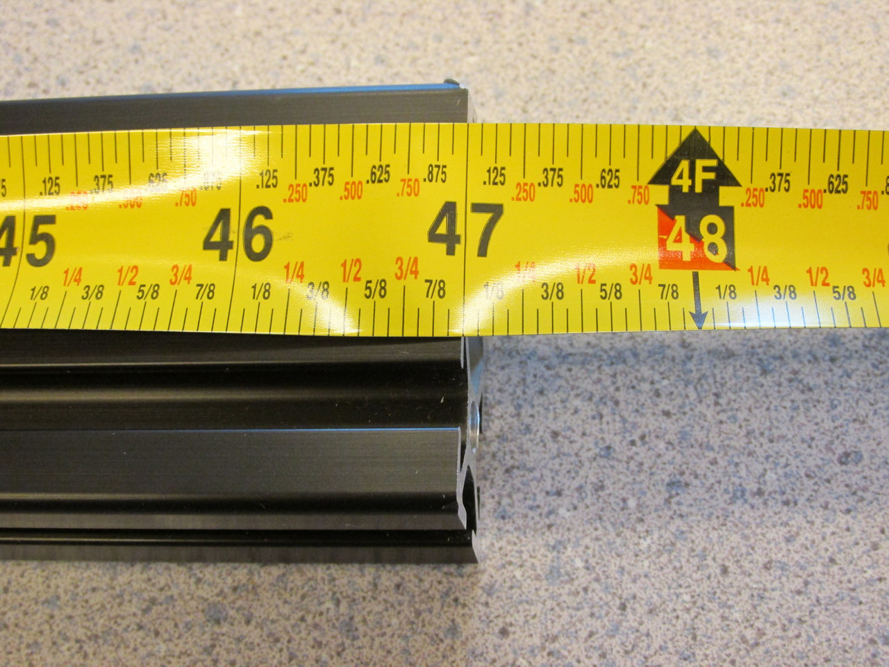

    Just checking- is the length of the crossbars on the Prinsu cabrack on a 2016-2017 model Tacoma 47-inches? If not, can anyone check? Thank you!

    Per the website, yes. 47".

    I saw that, but was hoping for other verification because I was siprised by how wide that seems over the mounting holes on my truck. Thanks for the reply though!

    they are indeed 47"

    It is 47". Pic proof :)

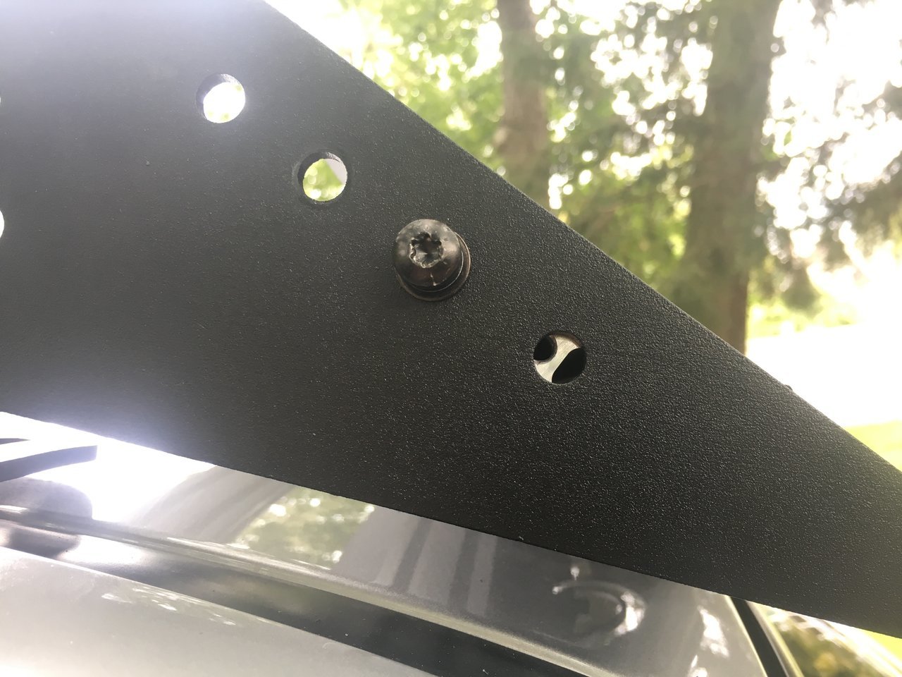

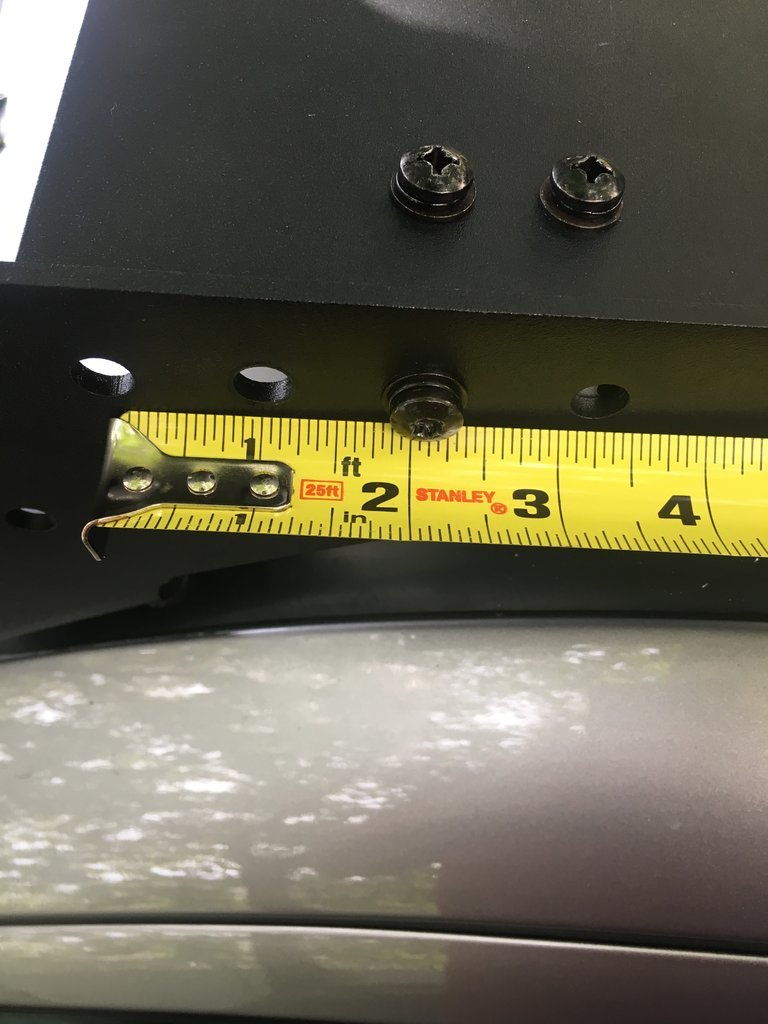

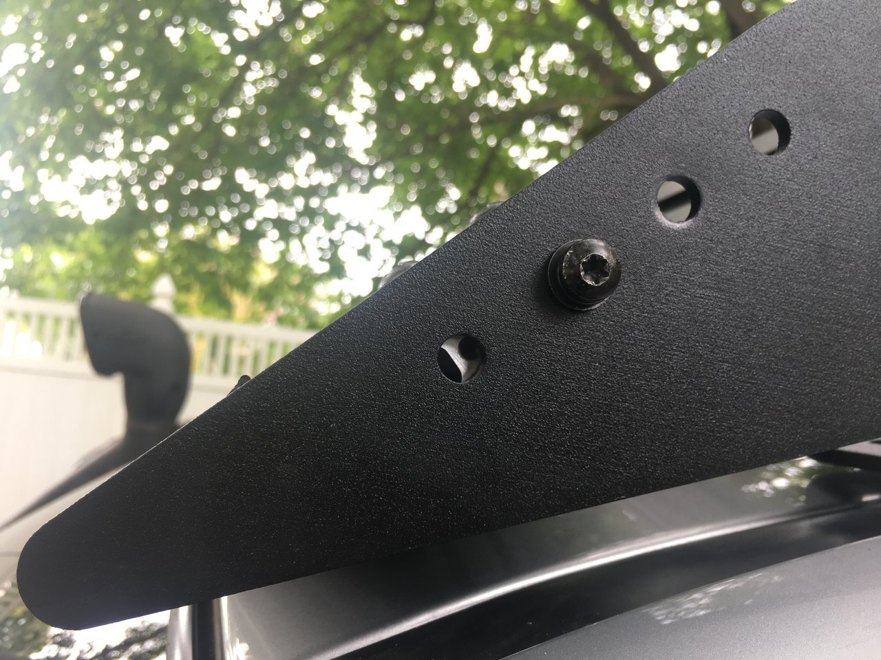

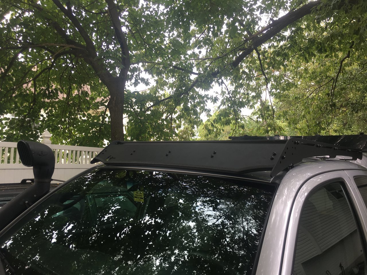

    IMG_2127.jpg IMG_2125.jpg IMG_2126.jpg Do I have the right fairing for this rack? Or are the holes just off? I tried moving the fairing down to the lowest setting but the holes don't seem to line up.

    I've got a 3rd gen, and your side rails look different than mine.

    that definitely does not look right. I checked the ones we have here at the shop and they line up right. Those holes should be 1" on center. Let me know what your measurement is

    Ah ok, it looks like the lowest one is 1.25"
    I just wanted to make sure before I drill a new hole for it.

    Well let me know if you feel like you can fix it. I am more than happy to replace it if need be.

    One thought if you do decide to keep that rack and fix it is rather than drill a new hole, use a round file to slot the hole enough to get the bolt in the rail. That way the washer will cover the hole. Let us know what you decide to do.

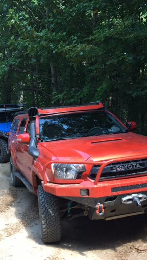

    Finished my install late Friday night/early Saturday morning before hitting some trails this weekend. Not to hard of a job. Initially the wind deflector was not shipped, but after contacting CBI they shipped it out on the day I called so no complaints on their customer service from me The rack looks awesome and I'm pleased with my purchase and interactions with CBI IMG_5082.jpg

    Love the color match :thumbsup:

    I'll give that a try!
    And thanks for the quick responses!
