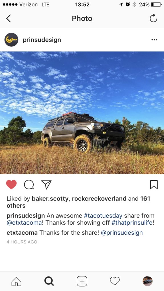

    I see my name!

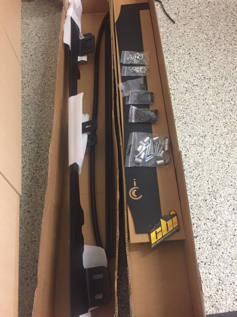

    Look what showed up at my door at 10pm last night. When UPS SAYS BY THE END OF THE DAY THEY ARE NOT KIDDING! I opened the box and reviewed the parts and list and am completely happy that CBI completed my order with no problems. Looks like they are making things happen. E77C63B3-F92D-488C-A36D-C49AC30BB0F3.jpg

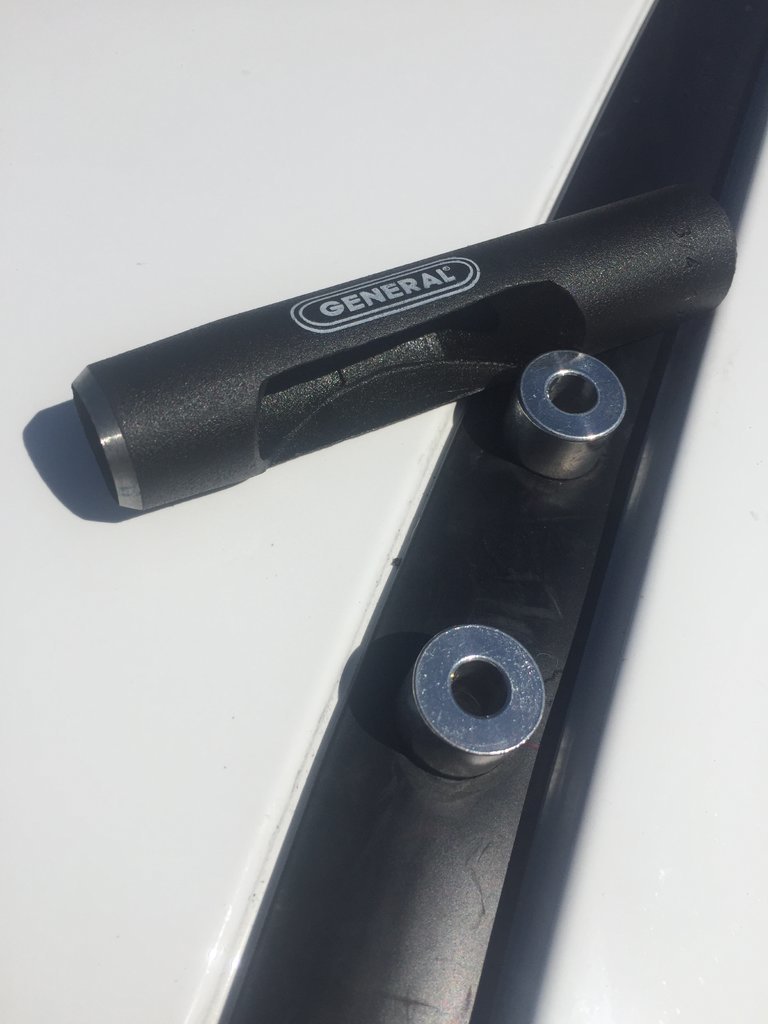

    Ok for all you who have ordered and are awaiting a Prinsu rack, I have one big tip for install. Order a 3/4” hole punch. I punched all holes in less than 10 min with a bit of setup where the holes were first by marking with tape on top of the truck first. The fit for the spacers are perfect that I almost don’t have to use any RTV below ( although I will). I found my hole punch on Amazon for $15 delivered, so don’t hesitate make your life easy if you are as anal as I am. A918F73B-5CB1-47D7-9E85-B25E9E651CA9.jpg

    Can you give the link for the specific punch you got.

    I second this statement. Punch is definitely the way to go

    I wish I saw this before I did mine. The Dremel and drill method thrashed my holes and my OCD hates it!

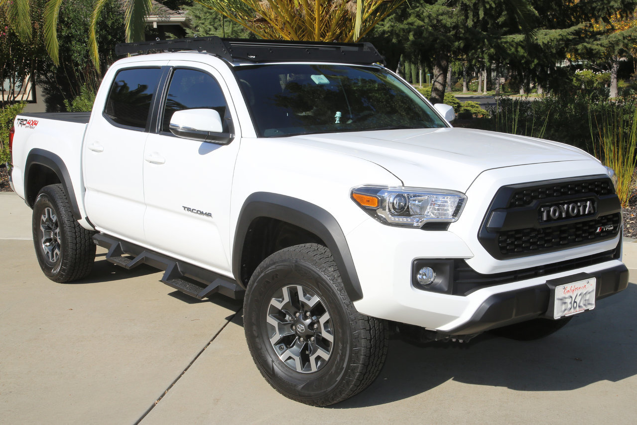

    Well I have to say the install is complete and it was not that bad at all. I did it myself with no help from others to put it up there either. I only put on 3 bars and did not put the wind fairing on to keep it light. Once up there it was a breeze. Took it for a drive to see about the wind noise and was not bad until I hit 55 then I heard it but at 75 it is pretty noticeable. I do have the cutout for the 40in lightbar and I think that is the reason for the excessive noise. Was not intending to put a lightbar on anytime soo. So I going to have to live with it. All in all it looks and performs fantastic and I would not change a thing, except maybe the wind fairing.
