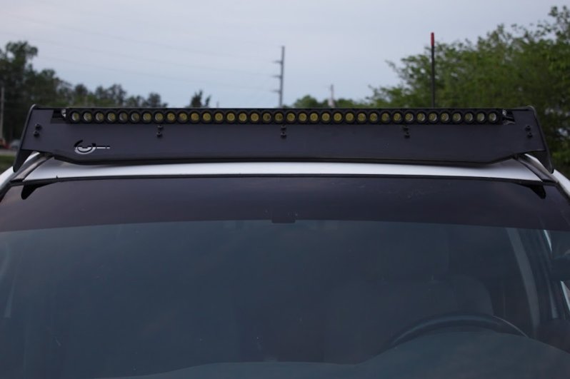

    Still have that Morimoto lightbar on? If so how is it today? Would you buy it again?

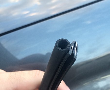

    Turns out this stuff is actually quite nice. It fits very snug on the wind deflector and I have no doubt it’ll stay put. It’s got a rubbery consistency to it so it bends around the sharp corners easily. I’ll be buying more of it for sure.

    Love it great light for a great price!

    Just an FYI,
    The noise cancelling strip that is supplied from the Prinsu wind deflector has a extra piece of material that blocks the wind from going under the fairing when positioned in the lowest setting. I'm not sure if the kind you purchased will affect the noise at all :notsure:

    Ah, that would definitely work better than what I've got. Didn't realize the stripping had that seal at the bottom. Good thing I've got plenty of other uses for what I bought. Thanks for the input.

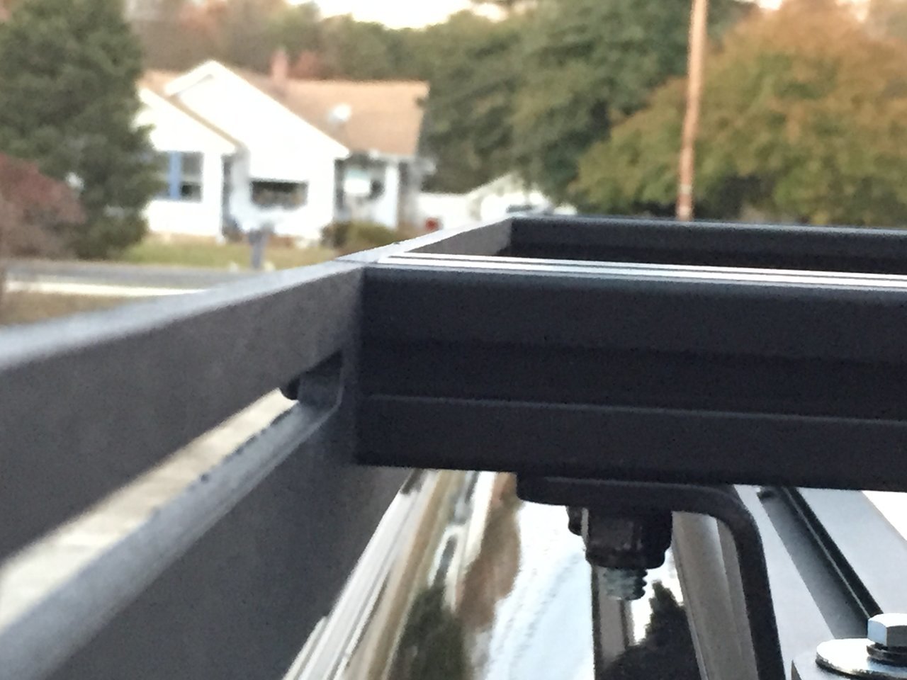

    I am installing my rack today and I'm not sure if i am being picky. I held the rails up next to each other and not all the slots lined up( varied in height not spacing). So i am finding out some of my cross bars are sitting flush, and some 3/16th down from the top. The flush ones ( in the middle) i had to put some force rushing the side rail down. Im not sure if it warped anything but some of the feet are not touching the ground. I did exactly as the instructions said to install. IMG_5175.jpgIMG_5178.jpg

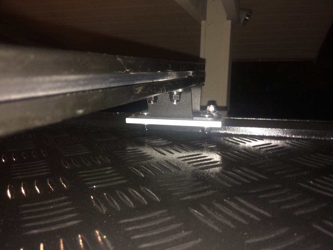

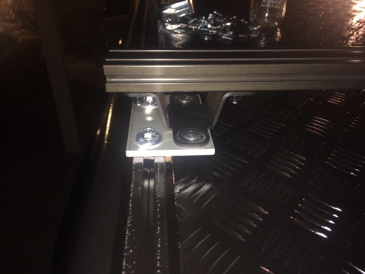

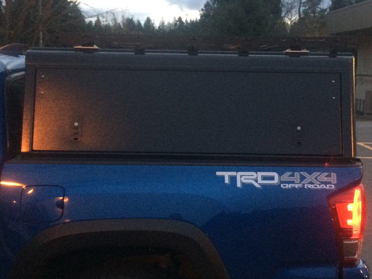

    I mounted my Prinsu CabRack on my Alu Cab today.
    Alu Cab load strips are 46.5 inches from outside edge to outside edge
    Prinsu load bar is 47 inches end to end
    The supplied mounting feet (MF, 4 of them), when mounted on the Alu Cab tracks, will be too wide to receive the load bars across both support flanges of the MF. Only the inner MF surface would contact the load bar.
    So what to do about this ?
    TSlot makes the extruded aluminium load bars - Tslot also makes other hardware for use with its products.
    Part # 653198 - a 3 x 4.5 inch 6-hole plate, drilled 1.5 inch center on center - 1/4 inch thick aluminium plate
    http://www.tslots.com/wp-content/uploads/2017/02/Master_Catalog_WEB_2.pdf
    The mounting feet mount up nicely and push the footprint about 1.5 inches inboard.
    Check out the photos.

    Here is the Prinsu rack on the Alu Cab. It’s so freaking dark in Seattle this time of year, I can never get a well lit photo - I work too much. 28ED5341-5F99-4292-89E8-1C62AE81D931.jpg
