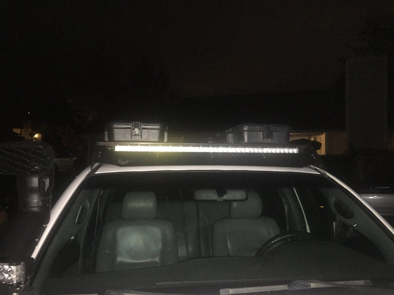

    So much more space for the rest of my mall crawler shit. UPS guy came by a little late after the sun went down. Measure and drilled and had it mounted in under an hour. Not bad for ordering two days ago and already mounted up. I’ll get a better picture tomorrow if anyone is interested.
    Edit: The Plano case is what got mounted up. Not the Prinsu. Don’t expect a Prinsu rack to be shipped and arrive in two days.

    Did you use U-Bolts? Trying to map out my mounting plan but I admittedly haven’t scoured back through the thread too far yet

    Carriage bolts. 1/4 and then whatever length. I think mine are an inch or inch and a quarter. Washers on both sides and then a locknut. Kind of had to learn as I went and never found a walkthrough for mounting the Plano cases. The bottom piece of the case is 43” and the bar indents on the rack are 31” apart. 43-31 is 12”. So cut that in half and measure 6” in from the outside on both sides along the same groove and there it is. I measured many times and drilled once. Got it first try on both cases and no issues. Wish I took pictures along the way but was in a hurry with it getting so late.
    Edit: I centered the handle of the case in the middle of the center two crossmembers.
