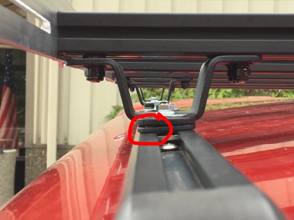

    That was BenTheMan’s photo.. I did not have those plates either and I’m having a hell of a time getting the rack to lay flat with the top curvature if the cap.

    Nope. I did have to stack 8 washers to account for the curve of my shell

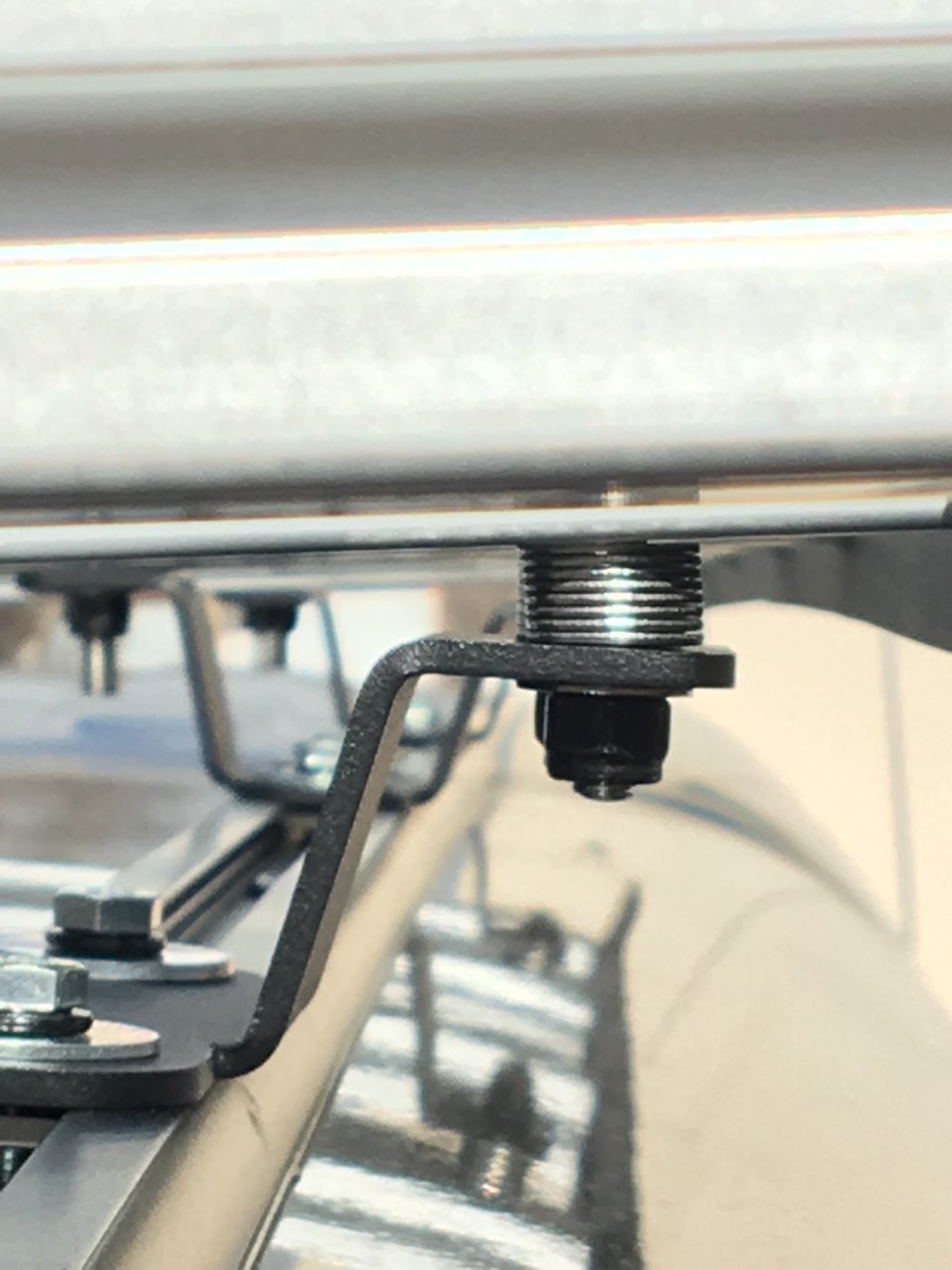

    I had to stack 8 washers on the outside of the foot for it to work. It was a pain But I eventually got it to work. I did have to change the bolts that slide in the rail from 3/4 to 1in

    Each camper is going to have a different shape/contour. Also depends exactly how far apart the tracks are placed because of the curve of the shell.

    Mine were installed 40in center to center but I've seen the same shell with the tracks closer and the curve wasn't as extreme.

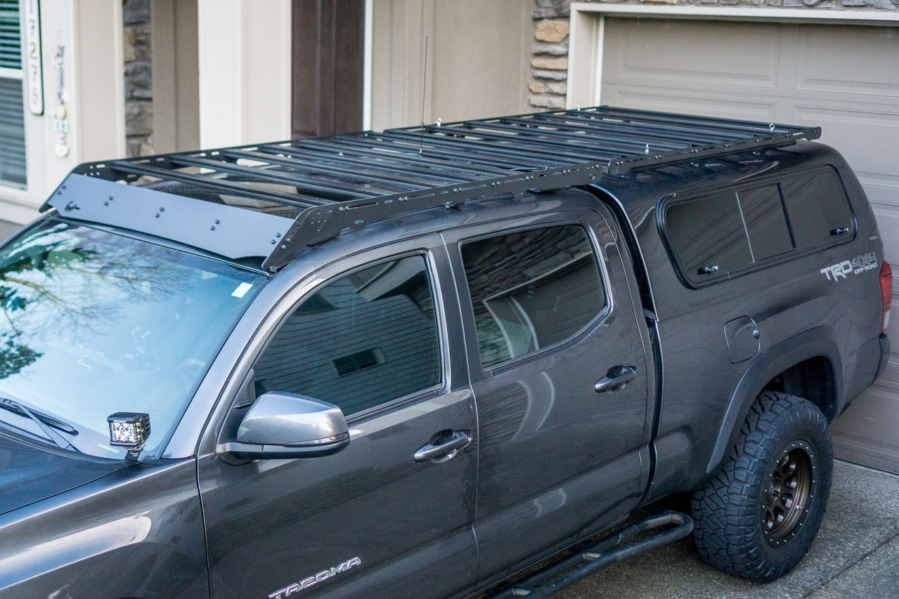

    Copycat! LOL, just kidding. You're like me, I had my Ray 10's in my garage for a few months too!

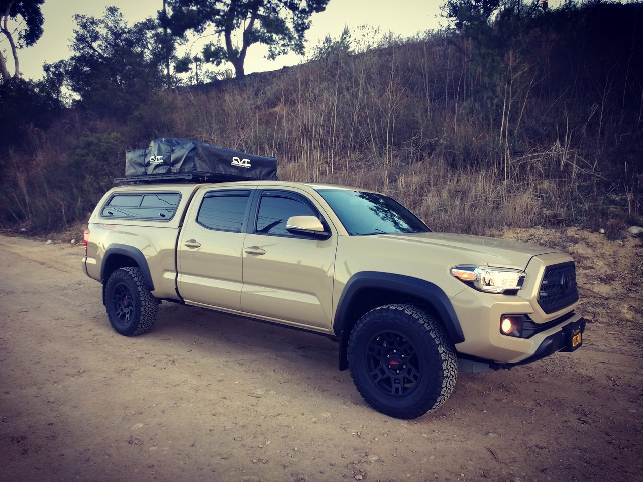

    Mounted the rack the other day and loaded the tent on yesterday.
    The CVT rails are a bit to wide and the drop mounting brackets interfere with the Prinsu feet. I may have to re-mount the tent rails narrower.
    Overall pretty happy with how it turned out.
