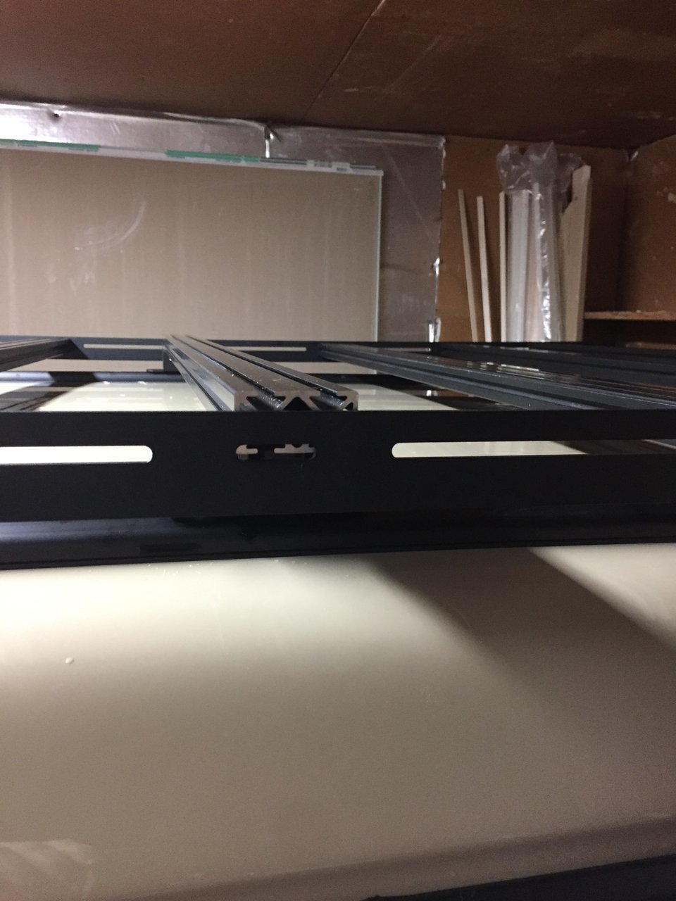

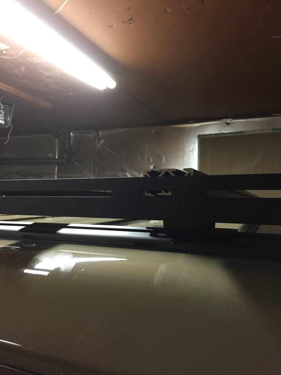

    I just got my 6’ toprac about 90% installed. Am I supposed to have 6 mountings feet the same size? The middle crossbar doesn’t line up at all with them. The install instructions allude to the option of shorter mounting feet... seems like I should’ve gotten 2 short and 4 tall feet. Can anyone with the 6’ toprac please confirm what mounting feet you received?
    Pics for reference:
    BYJOSHCOOK and Rob Daman like this.

    I have a Leer and ran into a similar situation. I mounted the front then the middle and then the feet on the back last. I had to push the rack down to get it mounted but the aluminum side bars allowed for enough flex to get the back ones mounted.

    That’s what I thought about doing last night but decided to call CBI this morning and see what they said first. I’m sending them back two legs (standard height 1-1/2” tall) and they are either going to send me 1/2” tall or 1” tall feet depending on the actual measurement. I’ll get that when I get home today. Very helpful customer service and should be able to get the right parts.
    For all those Leer owners out there, they do have an option for lower profile feet on the website under the accessories section. $60 for a pair of mounting feet is a bit excessive but they said they’d take the others back and do a free swap. Again, very good customer service and quick response.
