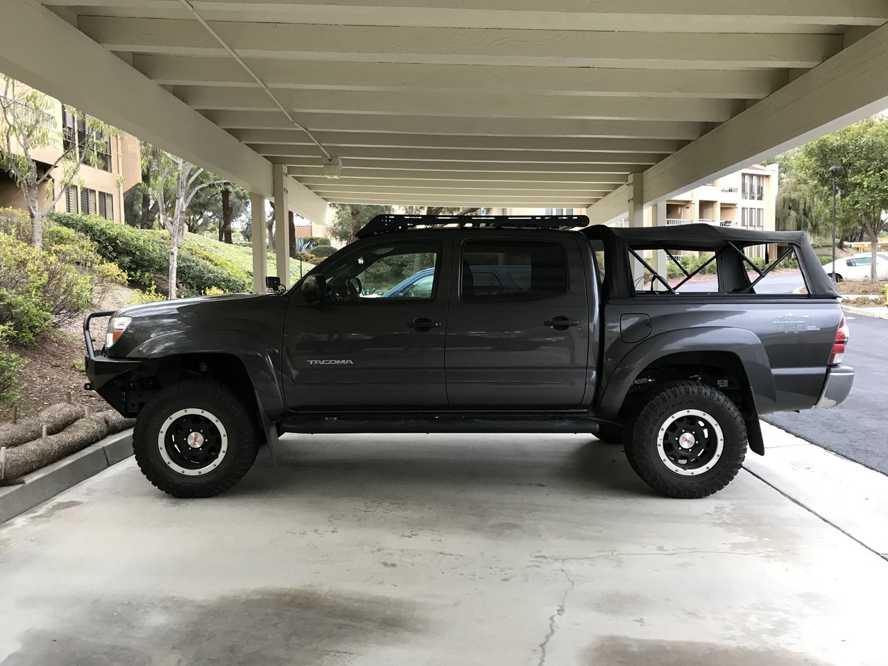

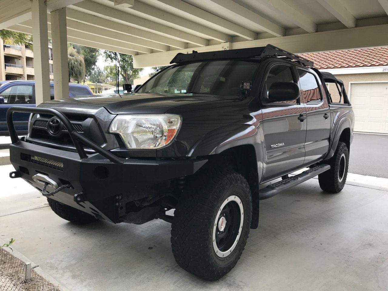

    Got it all mounted up today in about 3 hours including a run to Home Depot and punching the holes in the weather stripping.
    Gonna load it up with some front runner Jerry can holders and a Plano case next.

    If you do mount front runner jerry can holders and a plano case you will not be able to pull in that parking again, you'll rip your shit right off....

    I’m only putting those on when I go camping and leaving the base plate on there permanently. No reason to tempt honest people...

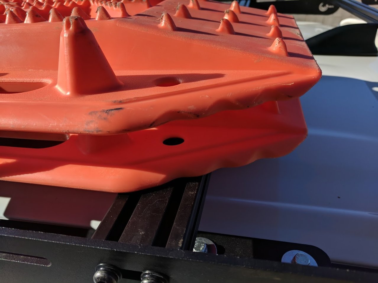

    I have the MAXSA traction boards and the holes line up in the middle of the prinsu cross bars. Any of you have advice for mounting or what pieces/size hardware would work for this?

    Can you weld?

    No, but think I found my own answer. 1/4 carriage bolts for one end, then probably cable lock the other.

    I just used 4x 1/4” carriage bolts with some 4 prong knobs (DimcoGray Black Phenolic 4 Prong Knob Female, Thru Hole Brass Insert: 1/4-20" Thread x 1/2" Depth, 1-1/4" Diameter x 7/8" Height x 5/8" Hub Dia x 3/8 https://www.amazon.com/dp/B0015HQ4JS/ref=cm_sw_r_cp_apip_F4gtMvbXH5gPR) and some fender washers (originally just used some wing nuts) to attach mine. I use a short section coated steel cable + a lock through the handles and around the prinsu bars to “lock” them down

    I'd just use a long carriage bolt with a washer and wing nut. Then get some type of cable lock, that's what I did and you can get it all from Home Depot

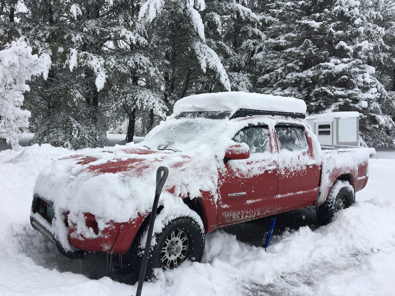

    Thanks! Eventually going to get the weather stripping. Just a matter of time.
    In the meantime, my Prinsu does a pretty good job of supporting the snow!

    I use long 1/4-20 carrage bolts and plastic knob handle nuts
