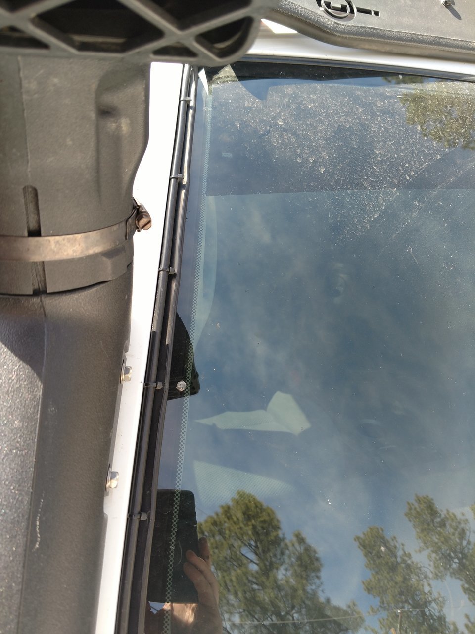

    Hey @STravis where'd you mount your charge controller and how'd you run the wiring from the panel to it? Great looking setup :thumbsup:

    I just have the charge controller in the passenger side of the engine bay right now. I'm not sure where it will be permanently mounted yet.
    For the wiring, I could only use the passenger side windshield trim to route the wires because I have the light bar wiring on the driver's side. Basically I just zip tied the wires together because both wires wouldn't fit. After I zip tied them together I wedged one of the wires into the gap. One wire fit very snugly so I'm not worried about them coming loose. It's not as noticable as I thought it would be from a distance.
