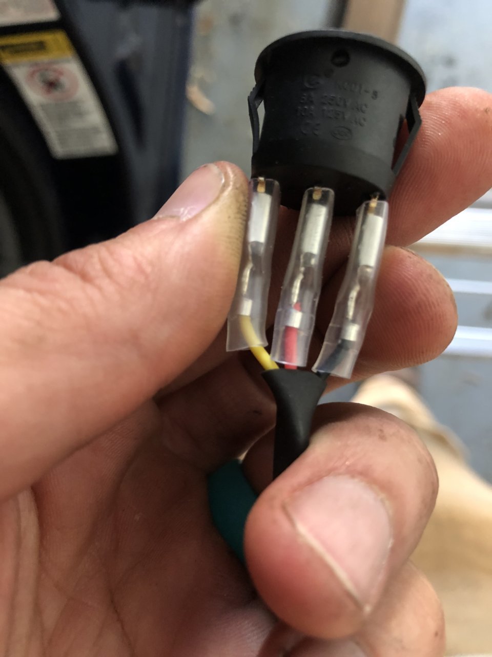

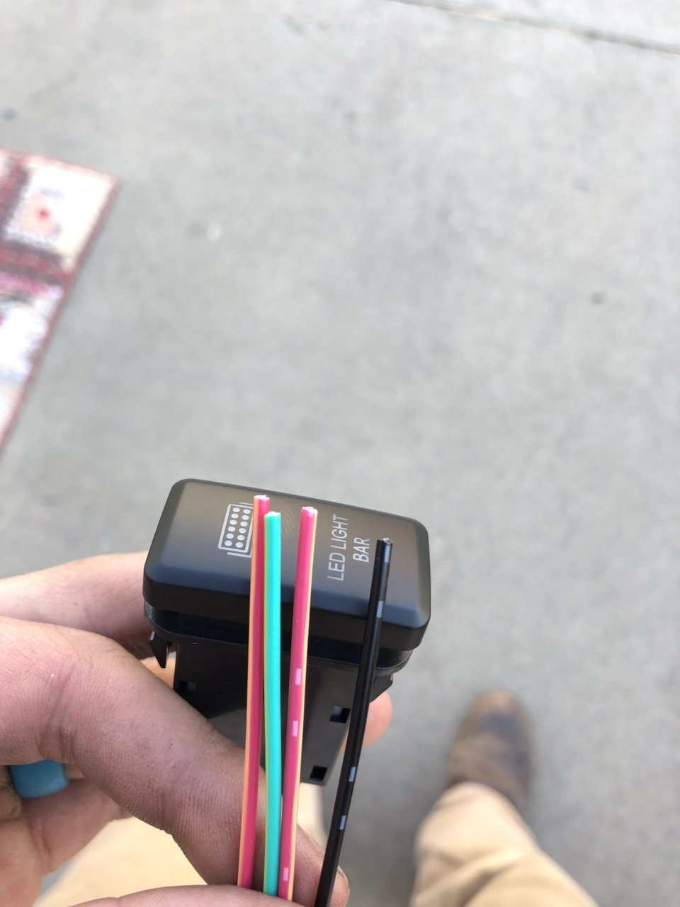

    I got my rack installed today. Went without too many kinks. Very happy with it. However, I do have a question about the light bar. I’ve got it all wired up but I want to use a push button that fits in the OEM slot. Wiring is different. The current has a ground, power, and negative. The push button has four wires. Suggestions?

    What brand is the switch? Air On Board? What about the light bar brand? I assume it uses a relay?
    Show a pic of the back of the switch harness.
    This thread may help... https://www.tacomaworld.com/threads/air-on-board-to-rigid.407987/#post-12718340
    There should’ve been a wiring diagram/instructions with your switch... But on the switch you are going to have - 1. ground wire 2. power wire 3. relay wire - (those 3 will connect directly to the light bar wiring). The 4th wire on the switch is the wire that lights the switch LED and you will need an add-a-fuse or splice into another wire that is hot when the lights are on.

    Awesome - That thread basically settles the score with it. I did a few searches but nothing came up the way I was hoping. I'll try that after work one day this week.

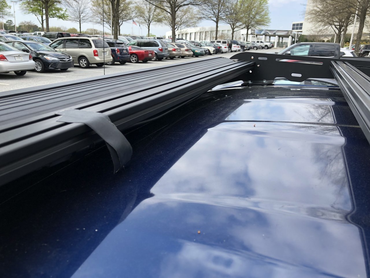

    Sorry to blow the thread up - does anyone have any tips on how they ran their light at harness on the rack?
    I had to run mine from the passenger side because the connector to the rest of the harness would be right in the middle of the A pillar otherwise. I can’t tie wrap it because my lightbar touches the crossbar it’s mounted to. Not sure if you can tell on the picture. I just taped it for the time being.

    Not a light bar, but the coax to my HAM antenna is zip tied to a few crossbars then wedged into the gap between the A-pillar and the windshield. I tacked it down with some leftover clear silicone I had from the rack install. I don't see why you couldn't do the same in the cross channel. Hope that helps.

    I don't have the cutout for an LED bar, but does the windscreen with the cutouts still attach to an angled crossbar? I loosed the screws holding the windscreen on, then ran some zip ties behind the crossbar behind the windscreen then secured the wires under that crossbar (with the zip ties going completely around that angled crossbar) (then tightened down the windscreen pinching the zip ties). In the pictures of the windscreen with the cutout, there's some screws on the front of it, so I assume that attaches with an angled crossbar like my non-cutout one does.
    edit to add: i also run a wire loom down the side of the windshield but I found some double sided gorilla tape at a auto parts store to secure the tube the wires run through.
